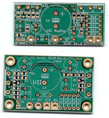

Re: PCB for sewa
Didn't you get my email?
The SEWA Rev.B pcbs are 7 Euros each and shipping in europe is 2 Euro => 16 Euros.
ThomasS said:Hi Mdas,
What's the price of two pcb for your sewa amp (incl. postage for Denmark)? Ill pay via paypal....

Hey Tyimo, as the most experienced (AFAIK) SEWA tester I know, it's time you started auditioning different MOSFET's! (Unless you are too busy with the Choke loaded OTA idea) I am in the process right now, and I can tell you; IT'S A LOT OF FUN! You can do whatever you want with the passive components, but the main difference in sound is produced by the actual mosfet used. As Circlotron mentioned in the OTA thread, he recommended smaller, logic level mosfets. So I am experimenting now. Another big improvement (also what actually makes most of the "sound" from this amp) was the change in preamp from the X2 Rev.1 to BOZ. Sometimes one step backwards is two steps forward
So far I have only tested the IRFP140 (sounds like you described above), but now I put in IRF540; sounds smoother (I don't know why, they are nearly identical, except the case). I can't wait to try the RFP12N10L from Fairchild I just ordered (next week).
Another change I found to be a nice improvement was to lower the gate impedance to 100K. 1u coupling and 100K bleeder, for a 50K input Z. I have also added a 1nF CB comp cap across Q3 because the sim showed better HF stability. Like Nelson did with the later Zen rev.
As a practical matter I am using my very latest Rev.D proto layout ( like Rev.C, only with HMT components and layed out for the smaller TO220 mosfets. Here I have inserted wires from the mosfet mounting holes and have the mosfet free on the heatsink so I can just swap them in a few minutes (I have a extra 100R locally at the gate)

That 2SK216 looks like a very interesting part for the BOZ! Go ahead and plug it in!
The IRFP044N is a even higher power device than the IRFP140, I think that's the source of the "roughness" you are experiencing
I think the IRFP040 would be one of the best TO3/TO247 types..
You're right, we don't even need the 100K Zin, but it let's us get away with the 1u coupling cap. If you've got space, I'd suggest 10K/10u
