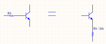

Sorry, my bad. I had 2SC1815 on mind, in fact this particular chart.

It's not quite so simple, people are all too focussed on talking about voltage gain and of course there is no active element that creates voltage gain - they are all transconductance devices.
A device is what you consider it to be. Use the model which best fits the application. A triode operated into a very high impedance is best seen as a voltage gain device, while a BJT operated from a high impedance source into a low impedance load is best seen as a current amplifier. Either can also be regarded as a transconductance device, given different conditions.

As far as I understand BJTs are different from mosfets in that the low impedance input was purposeful to create electron holes in between the doped areas which allow electrons to jump the gap.
No, the low input impedance of BJTs is a nuisance. It can be regarded as non-ideal behaviour, which is why the current gain is rather random from sample to sample and varies all over the place with collector current.
Intrinsically BJTs need to be current driven but I think from an effective standpoint they are just low input impedance, low vbe turn-on mosfets.
No, different effect so different behavour.

traderbam said:
We must be living in different universes. So “gm is non-linear but at least it is consistent”; good luck with that.
But this is exactly how precision circuits are designed: gm is predictable. 'BJT is a current amplifier' is what we teach newbies who don't understand the exponential function.
Exactly my point, a device by itself is not a voltage amplifier - it needs a load, an impedance is needed to convert the devices intrinsic output current signal to a voltage.
