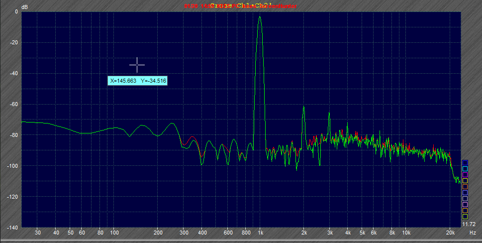

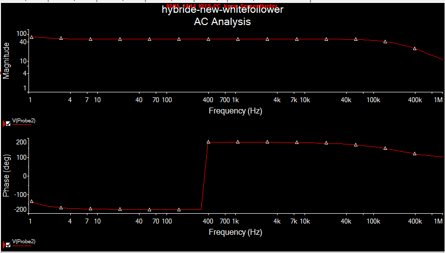

Only one thing I don,t understand is why I have a faseflip around 500 hz in the simulation (see pictures) it is coming from the tube voltage amp, maybe the mosfet follower do this but it is proberly the multisim itselfs who do this, it has still bugs.

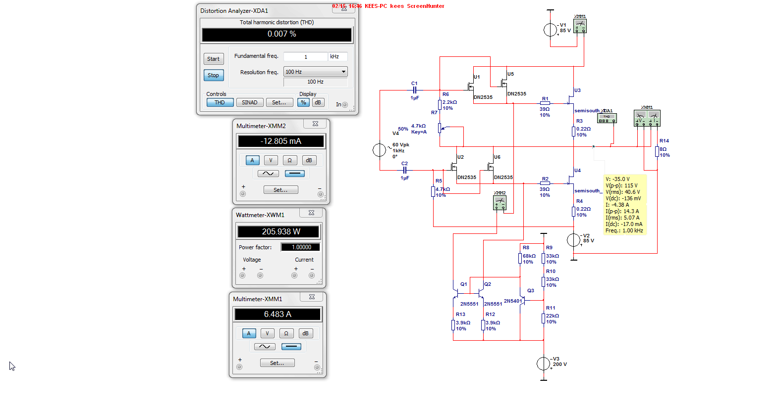

I have made a test circuit with semisouth, but with normally on ones, the for audio made ones has normally off, with ask a different approach and results are less good.

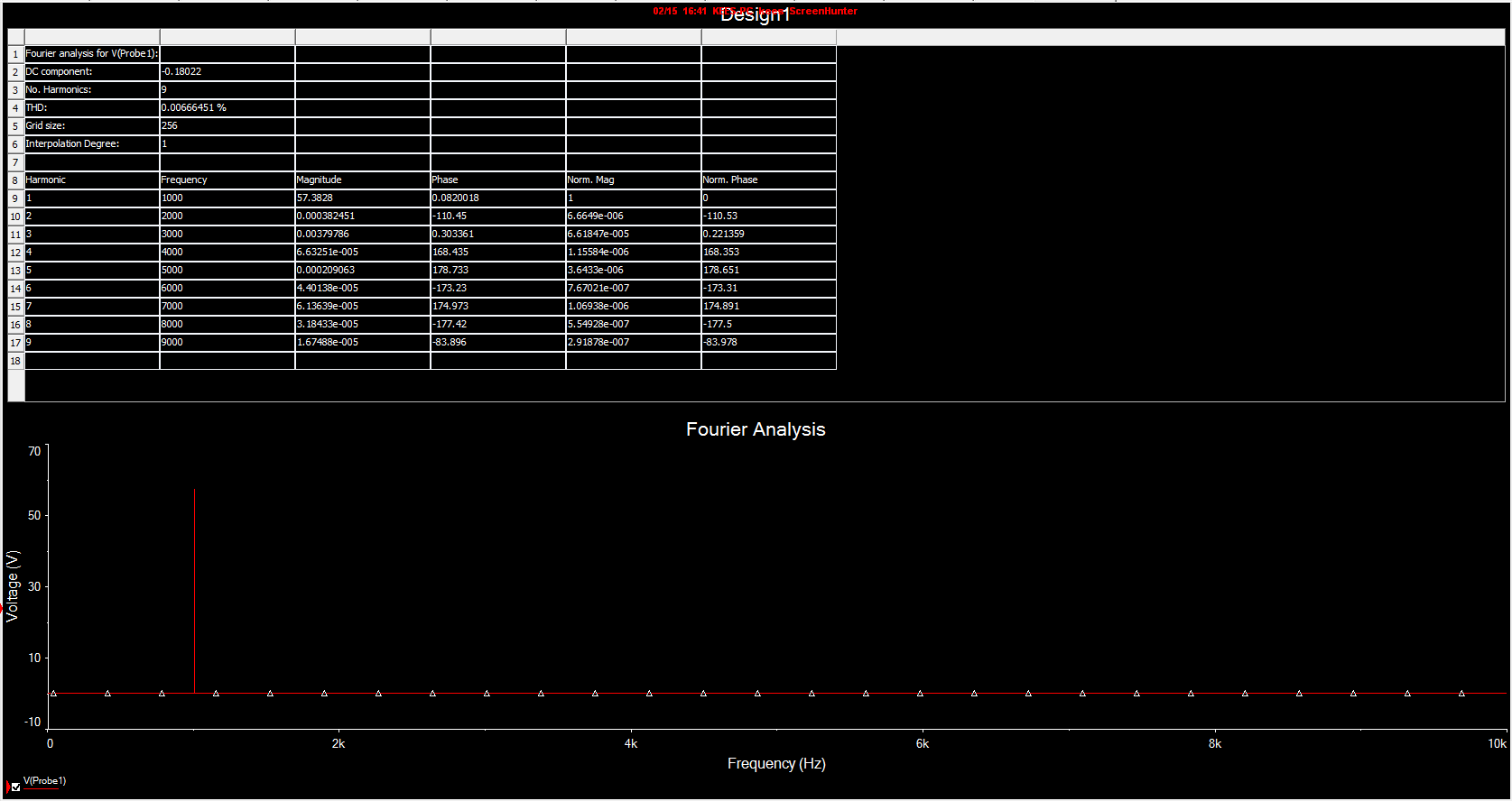

here with 200 watts, no feedback I have 0.007 procent distortion, the 4,7k pot works, the distortion can be adjusted,, the idea is from the yamaha B1 amp.

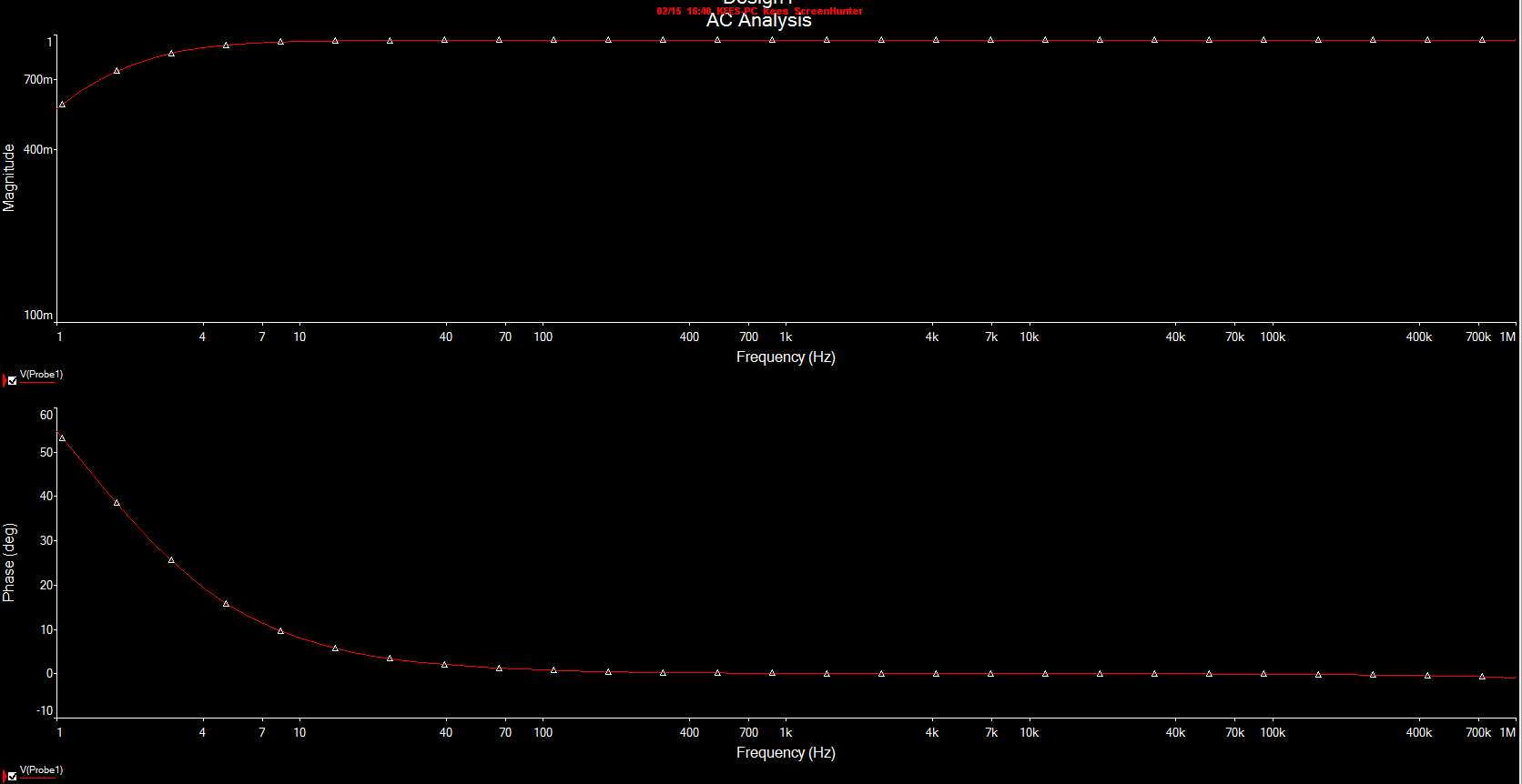

bandwith don,t need commenting, it is wel above 1 Mhz even without feedback.
If I put a valve for it, I have a simple hybride. the model I did made is possible not oke, I need a real one, I have fill in some things in a excisting 2sk170 model, like current, on voltage etc.
paralelling dn2535 wil give enough drive I think, it is still simulation..
