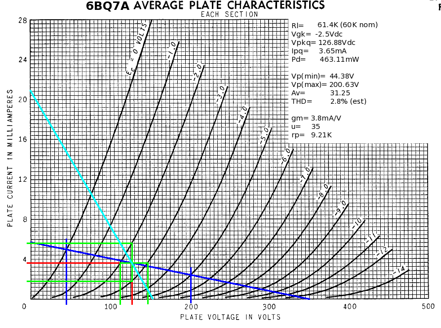

Definitely a possibility. I considered the alternative of using an LTP implemented with cascoded 6BQ7s. I've already used this topology for the front end of another, hollow state, project. Works great.

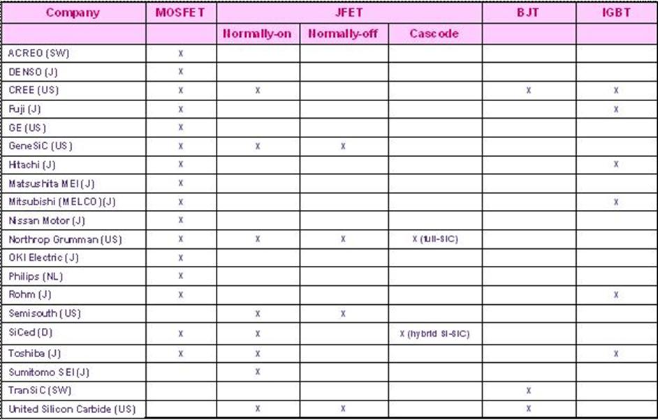

Here is the article from 2007 about SiC market players:
I-Micronews - POWER ELECTRONICS : Status of the SiC power devices market: If only we had a sw...
and current products from UnitedSiC:
United Silicon Carbide, Inc. - JFET
and this year news on SemiSouth:
http://compoundsemiconductor.net/csc/features-details.php?id=19733510

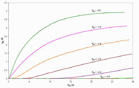

As for the use as an AC switch, I was wondering what the channel leakage would be when reverse-biased? Can these devices withstand reverse bias? A 'normal' FET with an antiparallel diode can never be reverse biased since the diode would conduct, but that's not the case here.
