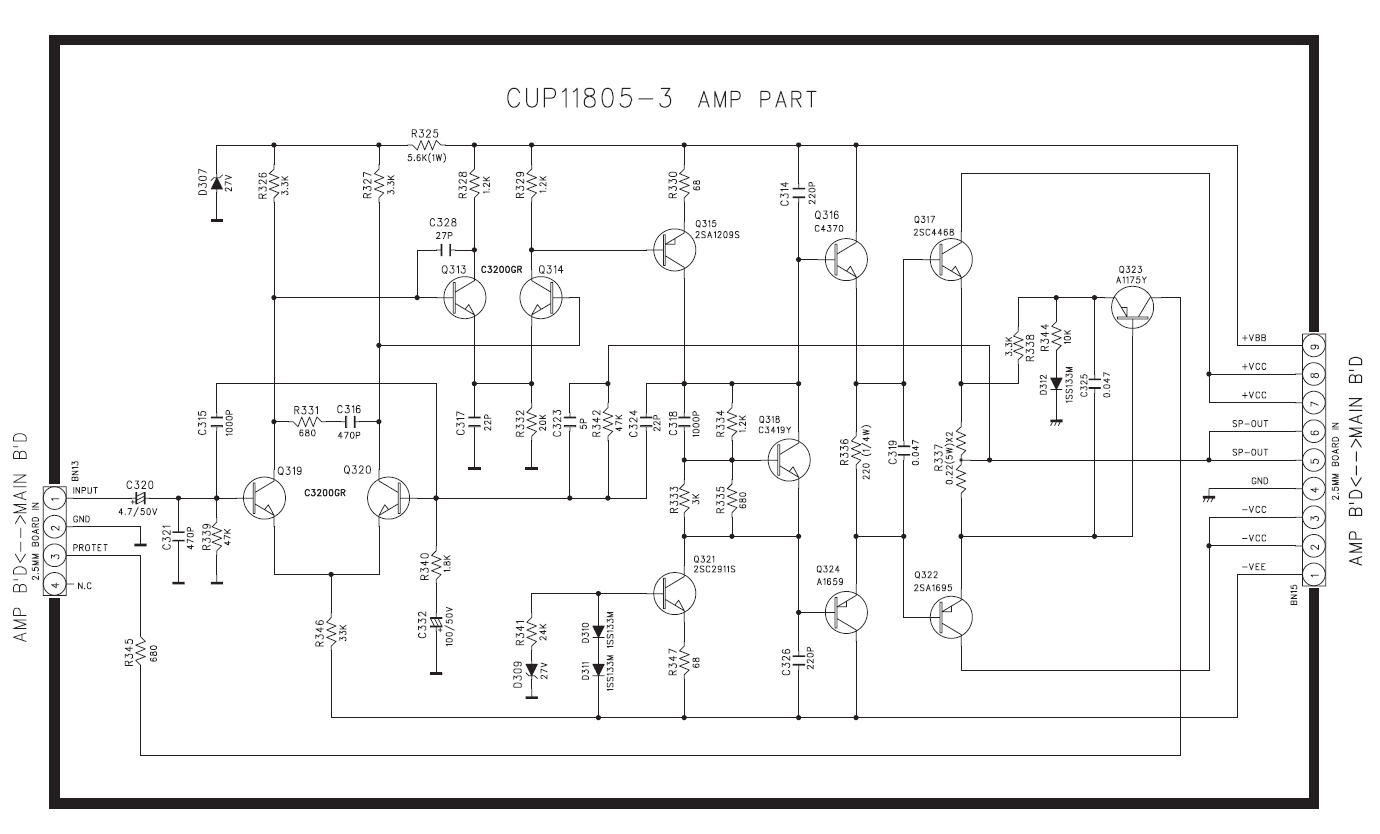

A friend of mine recently acquired 5 TEAC AG-790 receivers for free, and he offered one to me. I wanted to know something about the amp so I downloaded the service manual. I had high hopes, and I was pleased to see a relatively simple design, but was then disappointed when I saw the cascaded differential pair for added gain.:mad:
Well I gave it a listen and it surely did disappoint; it was too shrill in the upper mids and highs for my liking. I did notice however, that they are using an electrolytic cap on the input and feedback cap that is not bypassed with a good film. Hard to say if that will cure the shrill or not. Not sure if I will bother trying to replace those caps though; it may just get passed on to the ex wife for her already shrill-sounding Sinclair Brighton speakers. :D
Attached is the schematic of the TEAC receiver amp. What do you think?
It would be trivial to turn the second diff pair into a cascode for the first
diff pair. I bet that would improve things.
