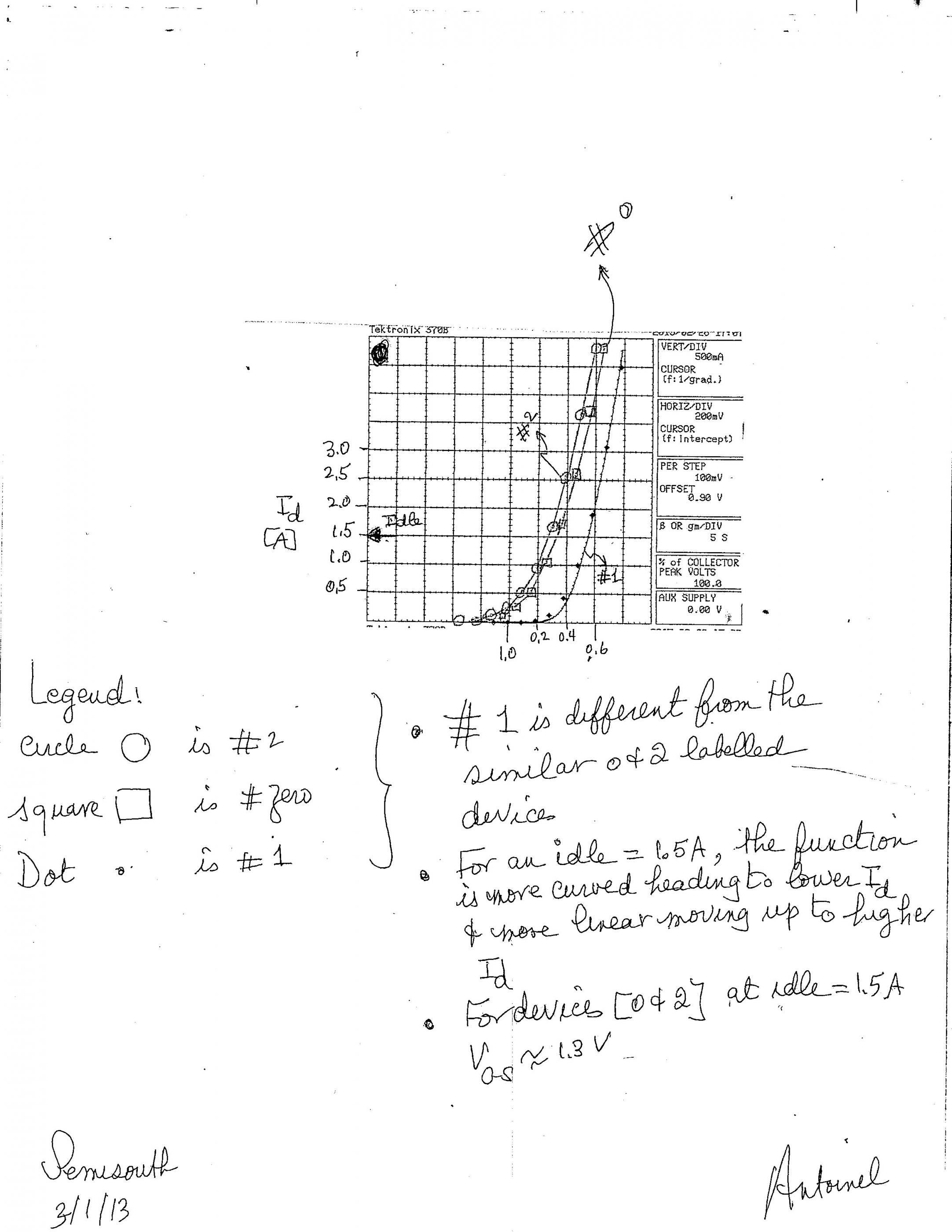

Dr. Mazzola. Are the plots you showed earlier from "pulse" testing?. I hope that your following article will shed light on the testing methodology. Please examine the schematic of diyF6. The two R100A are on a generous heat sink. I see the possibility to use this assembled amp to methodically [linearly] generate their static transfer curves. One has a variac to adjust +/-Vds, and the R100As has bias control to scan Idss.
Yes, fast pulse testing. And even more than that, "sweep" followed by "single" step generation to confirm the sweep trace. And even more than that, low enough offset that dc current does not flow before I push the "single" button. Changes in junction temperature will really foul up the measurements.
You're on to something about using an amplifier to measure the static transfer curves. That's something every DIY'er will have (eventually, once they finish one). I had the same thought for fixing the data source problem. I couldn't afford a Tek 370B on my own nickel. No shame in using what you got.
Dr. Mazzola. Thank you for the plots you showed earlier. I'll put a ruler to each of paper copies and get the best estimate of a linear function to determine a sweet spot. The plots are the best tool available today.
Dr. Mazzola. I superimposed the graphs manually. The net graph is attached.
- DUT #1 is different from the similar #0 and 2 devices. Will I be happy if I used DUTs 1 and 2 in diyF6?
- Let 1.5 A be the idle state [that of the idle sweet spot]
- The transfer functions are more curved heading to values lower than 1.5 A and more linear at values higher than 1.5 A. Inclination to believe the pulse sweet spot [Id] is higher than 1.5 A.
- Vgs for the similar devices is ~1.3 V
- There is an inclination to assume there is a discrepancy between the static [established by Pass and DIYers] and the pulse sweet spots.
- Temperature effect; pulse at 20 Celsius ? and static at ~50 Celsius.
Zen Mod. I agree. My writing was not clear. Static meant idling diy F6 first at 1.5 A. Then let the amperage move up and down a transfer function to express itself because of the signal. The function [performance ]is linear and symmetrical up [to higher amps] an down [to lower amps] from the center point of 1.5 A . This linearity is expressed as % THD. It was determined by Mr. Pass and lhquam [beforePass loop feedback] to be an impressive value of less than 0.1% in his article on F6.I didn't had impression that Pass was talking about sweet spot , in static context
there is no THD in static
Question for Dr. Mazzola. What is expected % THD of the transfer function which is attendant to the device [any of the shown 3 DUTs] moving down along the trajectiry to 0.5 A from 1.5 A and then moving up to 2.5 A for a sine wave?
