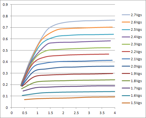

I ran the Id up a little higher but I did not go as far as I wanted before I ran out of time... I made a few measurements up 20Vds and did not see much difference. This graph is with a .25 ohm Rs in the circuit (included in the Vds).
I have a question now for SemiSouthFan: In your paper "is it Semisouth?" you show a graph of Vgs vs Ids of 3 SS devices and a BJT I think. You elude to the device on the left (the lowest Vgsth) actually being out of spec but you say it shows the more triode like behaviour? I do not see this behaviour? Is it that my sample has a Higher than typ Vgsth? Thx :D

This device was out of spec because the threshold voltage was below 0.75 V; but I think it still blocked 1200 V at VGS = 0. And yes the output curves had more shape (lower drain resistance) than the typical R100 with threshold within the limits (0.75-1.25 V). I'll see if I can find it at home.
I think the curves you are seeing are typical for the specified threshold voltage range. I'm not sure why you have Rs in the circuit, as it will influence the shape of the curves you measure.
As far as why I did some curves with an Rs in them. I did a standard style curve a few pages ago without any Rs. ZM suggested I add an Rs and I thought it would be interesting to see the linearization vs loss of gain. Effects of THD in these 2 configurations would have also been interesting but I am not set-up to do such tests at the moment. I suppose I can check my other devices and see if I have a low Vgs device similar to yours.
I'm also interested in looking at an R085 device as to me it sounds more promissing?
That's a good reason to add Rs, cause that's what it's supposed to do. ;)
The output curves of the R085 I've been testing in the lab (and R045) have lots of curvature, so you may be right.
