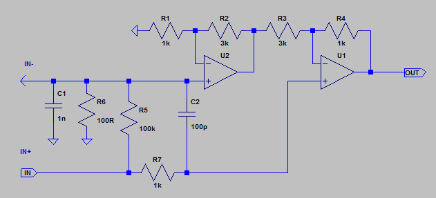

Schematic (simplified) :
Of course, that type of diff doesn't have stellar high freq. CMRR by design (U2's GBW limiting it), but it works remarkably well in the intended application -- provide a low cost "noise-free" additional high-Z unbalanced input for a grounded (PE==audio GND) device. Gain is always > 1x, 1.33x in this case (a compromise). CMRR is not depending on source output impedance, which was one major design goal.
The main point is the low-side connection of R5 and C2. If it were returned to GND the circuit stops working properly.

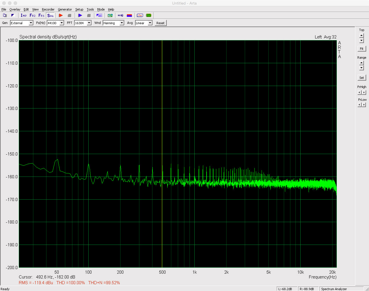

I finally had the chance to do a noise measurement of this fully assembled board that I have a good deal of faith in. Both board and measurement amplifier (within its own enclosure) were connected inside another 3mm aluminium enclosure with power and other cables fed in via small holes.
I shorted the XLR pins 2 and 3.
I got a wideband measurement 22-22kHz of -119.4dBu unweighted, -121.7 dBu A weighted and -122.9 dBu C weighted.
+-15V supplies.
Not bad me thinks...

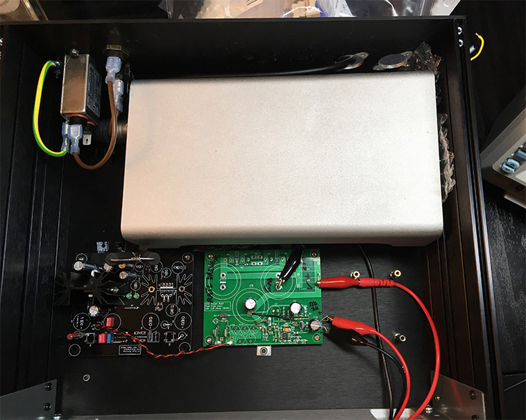

No these measurements were taken in another enclosure - a setup I am using to measure the performance of a voltage regulator I have been working on. I didn't take a pic while measuring the input board but here's a pic of the measurement setup for the voltage regulator which gives you an idea of the setup. I'm simply temporarily repurposing an enclosure I use for my headphone amp. (The measurement amplifier is in the silver box. The voltage regulator is the black pcb. The green pcb is a rail driver used to inject a stimulus frequency into the v-reg. Obviously the latter two were replaced with the input board in this case.)
But this was the crudest part of my measurement setup and the 100Hz pickup was the most volatile component. The supply connector on the board is 4 pole ribbon cable. I needed to connect this to my bench supply and I did so just with cables that had alligator clips at either end. These were exposed / outside the measurement enclosure and so I think were just picking up 100Hz hum from the bench PSU. I should have at least placed the clips at the input board end within the enclosure or used better supply connections.
Perhaps I should try to improve this and get an even better performance figure, but my aim was really just to check the implementation. Seems good with better than -119dBu unweighted noise performance (22-22kHz bandwidth).

unusually it's the even harmonics and fundamental that dominate.What's the cause of the persistent 100 Hz harmonic? I realize it's most likely power-related, but any idea where it's injecting?
One usually sees third and fifth as the dominant interference.
-119dBu is good. That's equivalent to just 0.83uVac over the audio band!
Applying a +60dB Low Noise Amplifier (LNA) to that output increases the noise to 0.83mVac
Try that. amplify and measure.
The output was amplified by Groner's 60dB LNA. I have the nominal gain of 1000 in ARTA. (I need the LNA as my sound card can't measure that low on its own.)
I wonder, could the 100Hz and harmonics be supply ripple? I'm just using my bench supply for this testing rather than the +-15V Aux PSU I built for use in the amplifier itself. I'm open to ideas from you experts...

The screenshot in post 162 is with Groner's LNA in the chain. One enters the gain of the preamp into ARTA. (I can raise or lower the trace by entering a different gain in ARTA.) In testing of the preamp gain/frequency response, I've been wondering if the gain might be a little lower than 1000. If it is, it's not by a lot. Measurement of 1k resistors indicate it's about right. Other tests suggest it might be a fraction low, less than 1dB. (See the Measuring PSRR thread in the Supplies section of the forums.) So far I've decided not to change the gain setting in ARTA from the nominal. +-less than 1dB is fine for me at this stage.

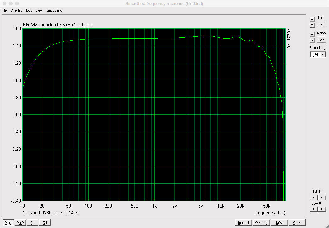

I purchased some 0.1% tolerance resistors, 200k Ohms and 20 Ohms, and constructed a simple 80db attenuator. My signal generator has a stated amplitude accuracy of +-2% of set value +- 2mV (1kHz sine wave). I calculated that with an input stimulus from the signal generator of 1dBV (3.174Vpp) this should give me an accuracy of +-2.3% or so. I could lower the accuracy range by increasing the level and thereby reducing the impact of the fixed +-2mV but this is good enough for me. Of course my sound card's frequency response is also a variable.
I took 28 measurement readings in ARTA with stimulus frequencies of 50Hz, 100, 200, 300, 400, 500, 600, 700, 800, 900, 1k, 2k, 3k, 4k, 5k, 6k, 7k, 8k, 9k, 10k, 20k, 30k, 40k, 50k, 60k, 70k, 80k, 90kHz. I set ARTA's spectrum analyser to display dBV/SQRT(HZ) with the FFT settings of Fs=192kHz, FFT=131072, Window=uniform (which gave the narrowest peak).
The lowest result was -84.41dBV @ 8kHz while the highest was -80.76 @ 400Hz. The average was -82.00 dBV.
I conclude from this that the gain of my preamp is closer to 58dB and not 60dB, a voltage ratio of 794 rather than 1,000.
