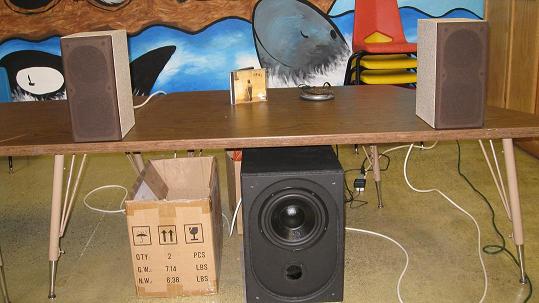

I brought in my 2.1 computer/office set up. The woofer is a Dayton 8" DVC in a ported, 30 liter box, tuned to about 28 Hz. The plate amp is a 2.1 class D, with variable crossover, sub volume, and separate satellite volume. The satellites are some old ratshack drivers from about 20 years ago. The paper cone 4" wide range and paper cone tweeter have a pretty nice detail. The speaker cables are of the "white lightning" variety, as described in a 6Moons article from a few years back. All in all, a fun project for under $200.

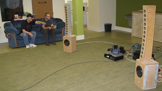

TerryO's curved arrays are always a point of interest. The Adire AV8's really fill out the bottom end, and the sweet spot ... well what more can you say?! :D
Don't recall if the GainClone was hooked up at this time or not.

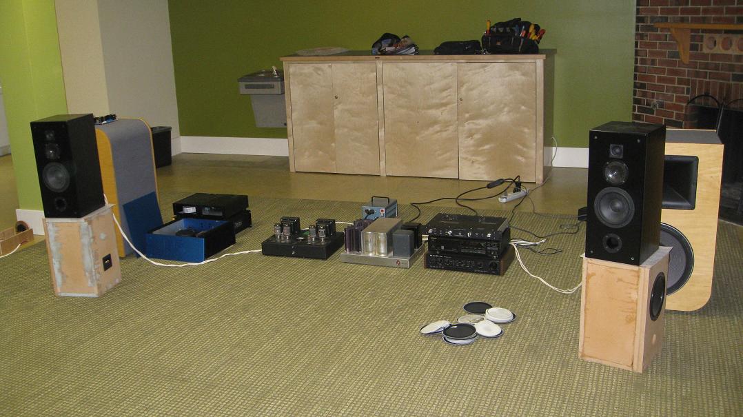

Also brought my 3-way series that kept me off the streets for a few months last year. I believe Damon's amp was driving them at this time. Several other amps were used, including Terry's Gainclone, one of Rene' Jaeger's latest creations, among others. It was all good.

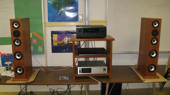

Here's the latest creation by Will Jennings, with a description provided by Will himself
"My speakers used a JBL 2226H woofer and B&C DE250 driver on a QSC waveguide. They were essentially a primo version of the 4π by Wayne Parham."
Nice job Will!
That's my industrial-fugly Leach ver 4.4x (still being tweaked) amplifier sitting in the center. Built in the early 80s and still going strong after a major upgrade in the latter 90s. Still looking for a better solid state amplifier design to replace it.

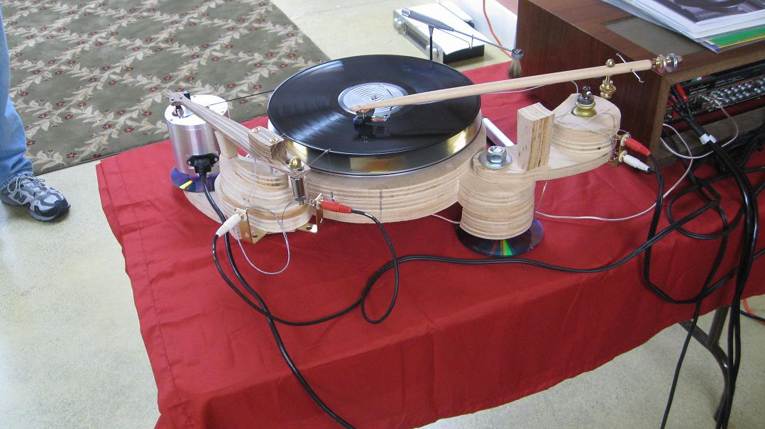

And my favorite for last. Off in the side room there was something spinning that caught my eye. I know I don't get out much, but I don't think I ever saw anything like that, or even expected anything like it. You really have to see it to believe it. Nice job, Jeremy! I bow in the presence of your cool :cool: factor.
:yes:

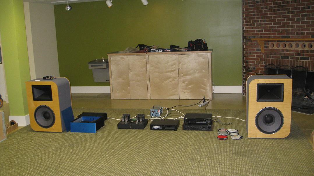

The Econowave speakers were also Jeremy's, although Will assembled the crossovers for him. Nice sound, in a wavy gravy cool setting. Thanks for putting a smile on my face.
Hi Dave,
From your picture it looks like Rene's Class A, Push-Pull amp is driving them. As usual, Rene' turned out another superb amp for everyone's enjoyment, although there's another builder out there finishing up "his" masterpiece.

Terry can you do me a favour and measure your 8" woofers? My minds eye sees something larger.
Cal,
Just cut that out, you're viewing them with the look of love in your "mind's eye". :rolleyes:
The AV8 is only 8 inches across. The cabinet is tuned to 33-34 Hz and as far as we could measure them at DaveR's place, they seem to be about that in-room. With the right music, they have a pretty fair amount of impact on the bottom end.

I don't have them in front of me, but if I recall, the mounting flange of the AV8 was a little larger than most speakers. The overall diameter might be closer to 8.5", which might give the impression being a larger woofer.
Of course, TerryO will need to provide the facts and data. :D
