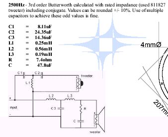

Could anybody here help me in crossover design, using the 850136, i downloaded "crossover simulator" and designed a 2nd order hi pass and a 2nd order low pass. what is the difference between the crossover types: butterworth, linkwitz-Riley, bessel, chebychev, guassian, legendre, linear-phase.
please help me out with this.
You've got your heart set on the 8", then go for it. Use the WES xo in the 850136.pdf as a starter and use a 3rd order L-R and not a second order.
If you want to learn about the different crossover types, get the Loudspeaker Design Cookbook - helps in all other areas too. Easy to calculate, but takes time to fine tune and get it right.

i just punched i 3nd oder in crossover simulator and it gave me different results to that pdf. knowing almost nothing about how a crossover works i am baffled, i think i need to buy that book. So why is 3rd order important here, are the higher freq of the 8" nasty? and must that tweeter be rolled off so steeply, the reason i ask is that if i am forced to have a complex crossover i may go stingy and get cheaper components :rolleyes: but the fewer components i have to buy the more likely it is i will buy quality ones.
Because you’re going to use both drivers on the edge what they are capable doing and you don’t want to lose too much quality you have to filter steep. This will properly have a better result than filter less steep with fewer components. Unfortunately it is sometimes (!) harder to get right.
Michael, I'll repeat what others have told you. The 8" Peerless is a Bad Driver above 500 Hz. If you don't care if your speakers sound bad, just say so and we will all stop wasting our time trying to help you.
Look at the response curve. See that dip in the output at about 700 Hz and, more important, the squiggle in the impedance curve at the same frequency? That indicates cone breakup and/or resonance. Translation - big distortion at that frequency. You have to cross the 8" below 700 Hz and you won't find a tweeter that will play that low.

and because i would now be using the 850122 before its limits could i cross it with a 2nd order slope to save components, for both the high and low pass?
sorry im new to crossovers, i was thinking 3KHz?

That's why you should go with a proven design unless you want to buy some test gear and spend a lot of time learning.
Designing crossovers isn't easy. A 2nd order crossover doesn't mean feeding the driver a 2nd order electrical signal. It means the acoustic output of the driver+crossover is 2nd order. Drivers aren't perfect so the only way you'll get that is with test gear and a lot of experimenting and/or simulating in crossover software. And even when you get a 2nd order response from the individual drivers, it will have to be modified so the drivers are in phase at the crossover point.
I Strongly Suggest you go with a proven design rather than trying to reinvent the wheel without the proper tools for "wheel invention." ;) The three I showed above are a good starting point. You can always modify them if you feel the need to experiment. Wayne's Pee Creek is likely the best of the bunch because of the better tweeter. However that tweeter may be too expensive in Oz. Most likely Danny's version of the AR is next best because he optimized the Peerless tweeter which is a bit quirky. Crossover components are cheap unless you go for exotic stuff. I wouldn't choose one crossover over another because of the component count - it's only a few bucks difference and can make the difference between so-so sound and great sound. Choose the one that sounds the best.

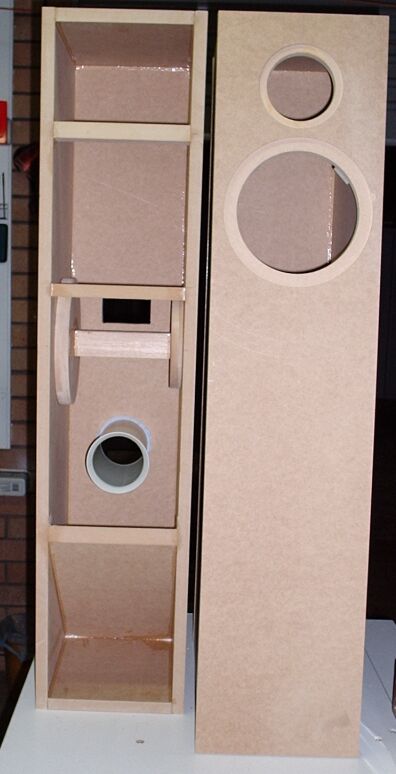

A vented design is much easier. I don't know if 40 litres might be too much as WinISD has 34.2 litres and Peerless recommends 30 litres.
If you want a bigger box but need a smaller volume just partition of a section. Did that with mine with a 45 degree panel.
