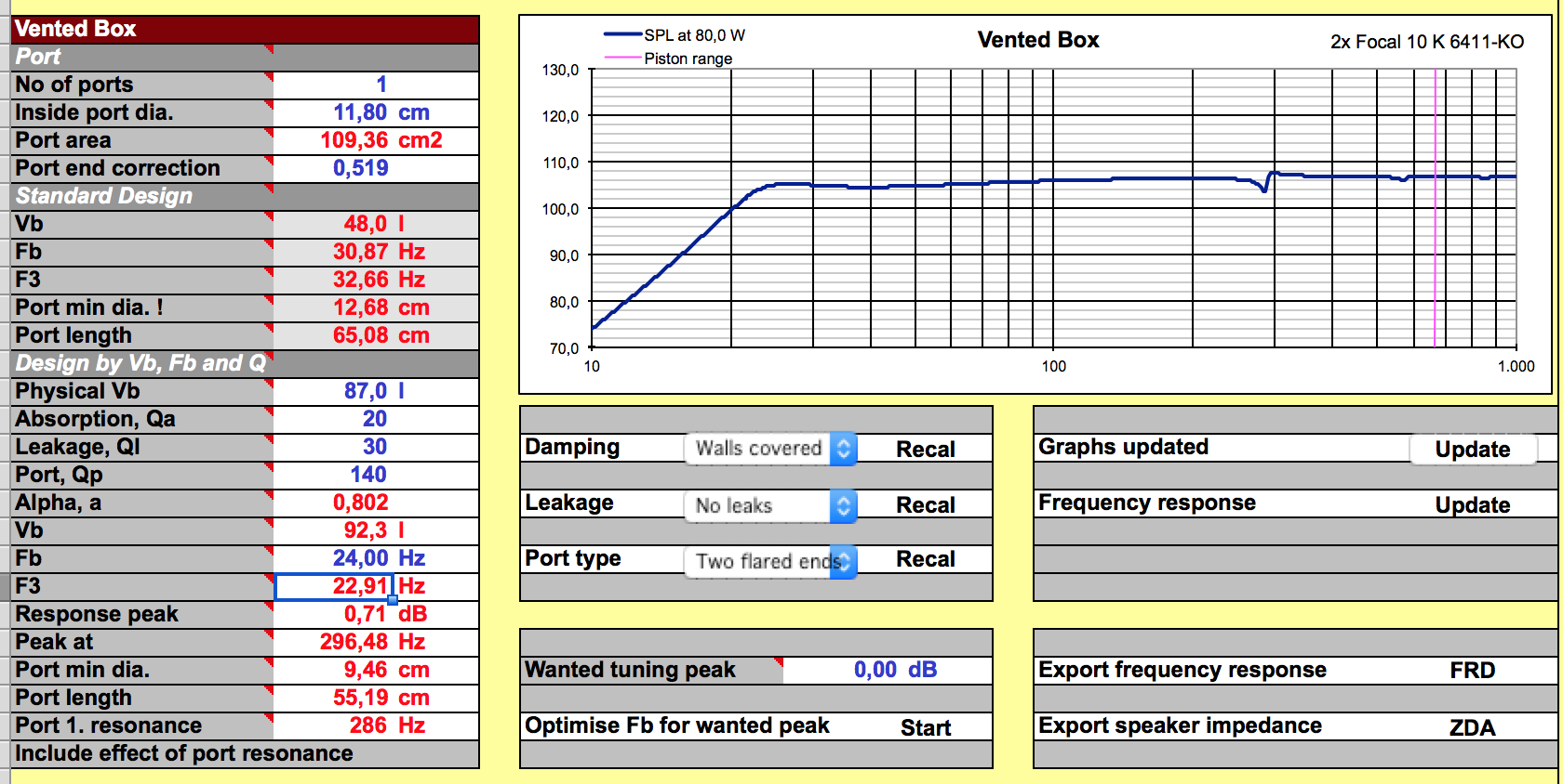

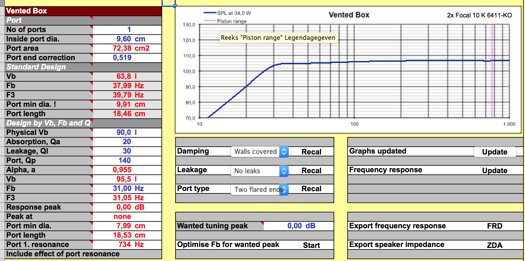

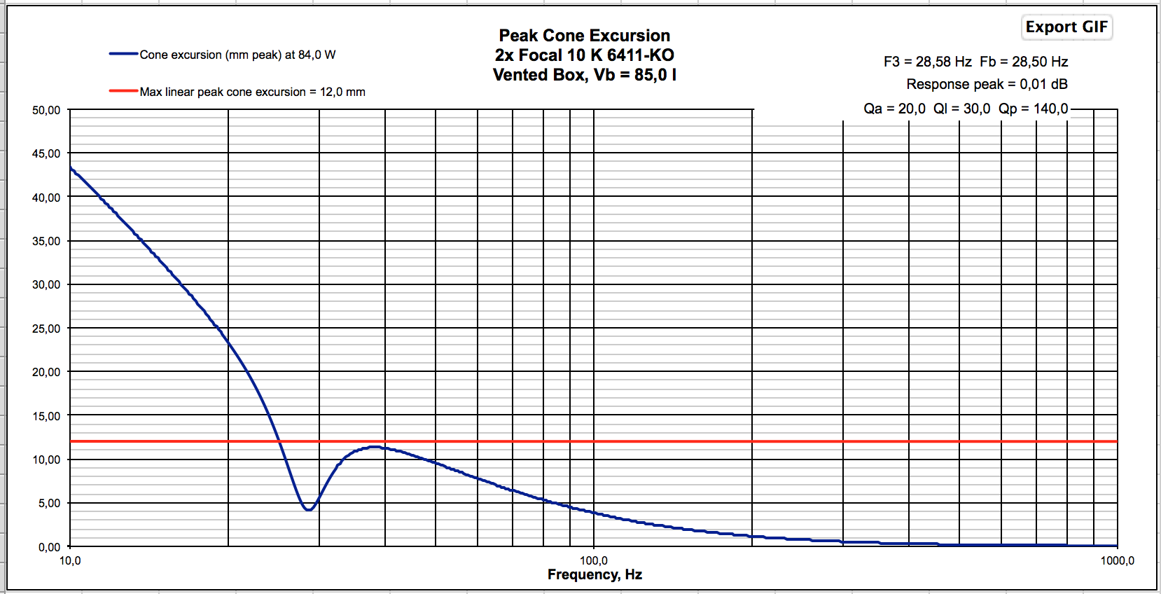

There's nothing going wrong wrong with the MW16P-4's in now about 85 L unless the software is wrong but it's not. I also kind of expected them to exceed their Xmax and that kind of stuff but they are doing totally fine. They move quite a lot of air actually. They almost need the same port diameter as the SB23's.

That's fun but guess what, I'll have to make the cabinet ugly to make it fit, MW16P-4 will stil be quicker and tighter because two of them together have less than a fifth of the moving mass and why should I take that thing over two SB23's? They'e the same line and design of subs but the 29 is just bigger so in terms of distortion and other sound quality determining factors I only expect less from a 12" then from a 8" and in terms of crossover frequency it will only be a huge disadvantage, 200 Hz would be very high for that thing.
You may want to double check your xmax for that 16P Satori.
In terms of cone excursion, "p-p" stands for peak to peak - which is twice as large as xmax.
https://solen.ca/wp-content/uploads/mw16p.pdf
That's going to make just a little bit of difference in terms of max SPL when you only have half the cone travel........
Maybe stick with rigid metal cones for the woofers too to match your metal mid and go with the 8" SB NACS45-8?
You might also want to try just a slightly a more gentle roll-off on the bottom end when you are tuning this low to allow for the room to add in its effects so that the net result isn't too boomy.
Oh okay. Then they indeed won't be as good.
I wen't modeling again and I came up with these: Scan-Speak Revelator 18W04531G01, will play to 31 Hz -3 dB and will obviously be the quickest and tightest. Seas Prestige CD22NR4X will play to 28 Hz -3 dB and the impuls response and moving mass are okay but I don't really know what the specs all together and the reviews say about sound quality. And then there's the SB-Acoustics SB23MFCL45-4 again. It will have the poorest impuls respons and measurements supposedly say it has quite some distortion going on but it will play the lowest to 23 Hz -3 dB and someone said it has that bad distortion but how noticeable will it be here? It only has to play at 40 watts to reach the SPL +3 dB of the mid.
The bigger Satori's won't play that low.

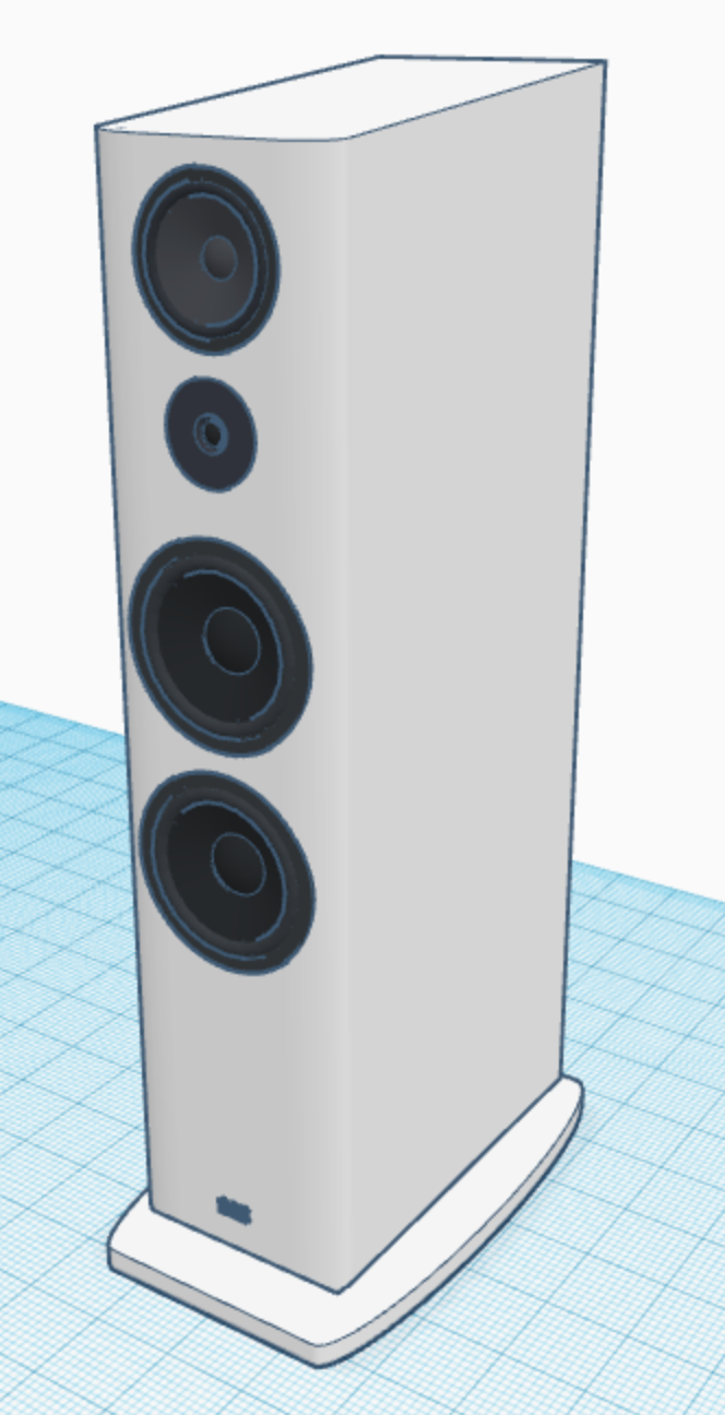

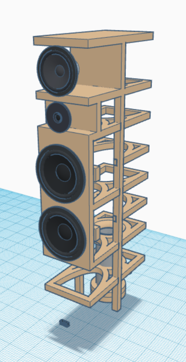

The design is done.
But about the MW16P-4 vs MR16P-4. I think it's pretty obvious the MR16P-4 will be a better midrange when crossed high enough right? Or does it have more distortion just like the Scan-Speak midrange versions? The Seas woofers can be crossed quite high since they're not really subwoofers but just the bass boasted version of a normal 8" woofer. What if I would cross the subs at like 250 - 300 Hz, would the MR then be a better performer or will it still have more distortion just like with the Scan-Speak midranges?

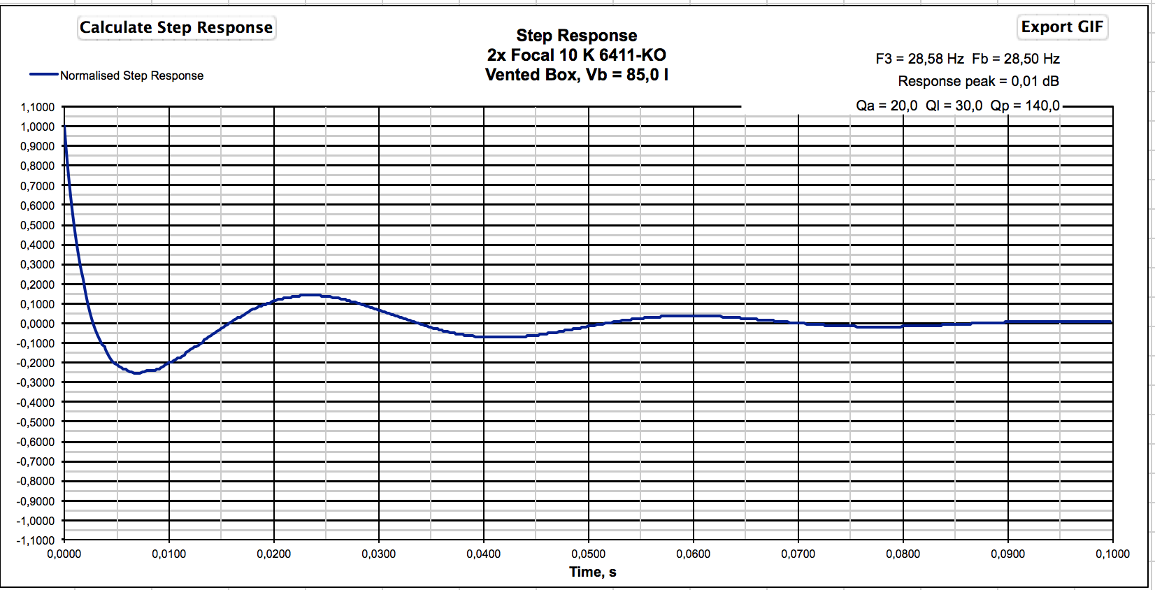

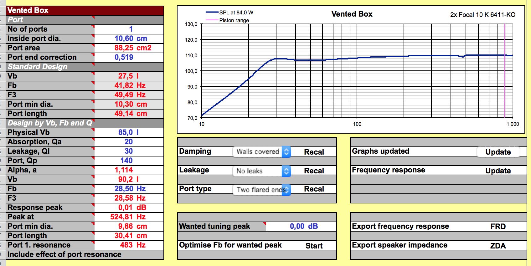

For bass alignment you probably don't want the configuration that achieves the lowest F3 in simulation. In most smaller to medium sized rooms this will give you a booming one-note bass due to room modes. Only in very large rooms with the speakers positions significantly out from the walls (1m+ from rear wall, several metres from side walls) does the alignment with the lowest F3 sound balanced.
My experience is the same as many others - a practical alignment is about midway between a sealed box, and a ported box that achieves the lowest F3. This means slightly smaller box and tuned a bit lower than you would when trying to achieve the lowest F3. Of course, if you don't know what is going to be suitable build the box larger and add fill later to make it smaller if the bass is too much.

Yeah, I'm pretty sure I'll take the Scan-Speak Illuminator D3004/662000, a SB-Acoustics Satori MW16P-4 and two Seas Prestige CD22RN4X's and I'm hoping to stick with them.
