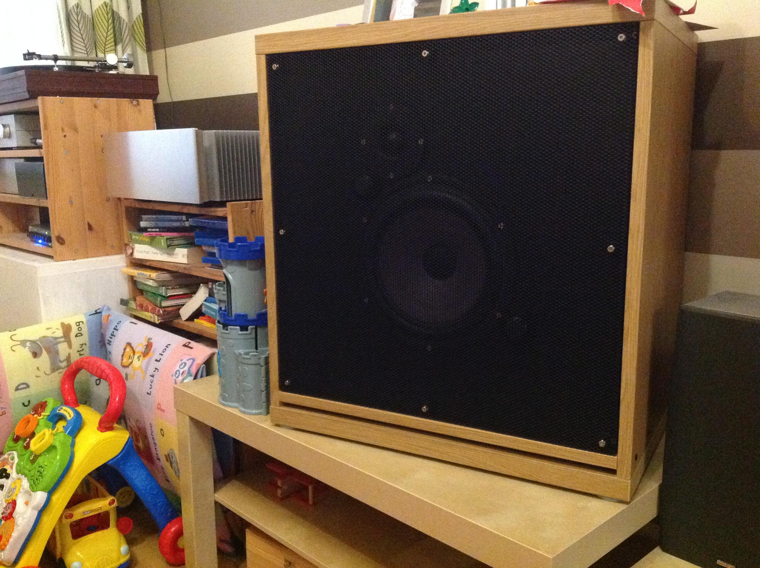

I use the A26 drivers and crossover in a much larger bass reflex cabinet (>100L, tuned to <30Hz from memory) paired with an Aleph J. The cabinets are made from cheap Ikea bookcase sides, top and bottom with heavy ply front and back panel. I installed heavy steel mesh grills to protect them from my sprogs, and intend to build 'proper' cabinets without grills once my kids can be trusted.
The speakers work great th the Aleph J. The speakers and amp have a nice balance of clarity and openness with dynamics and bass weight. Natural pairing as far as I can tell.

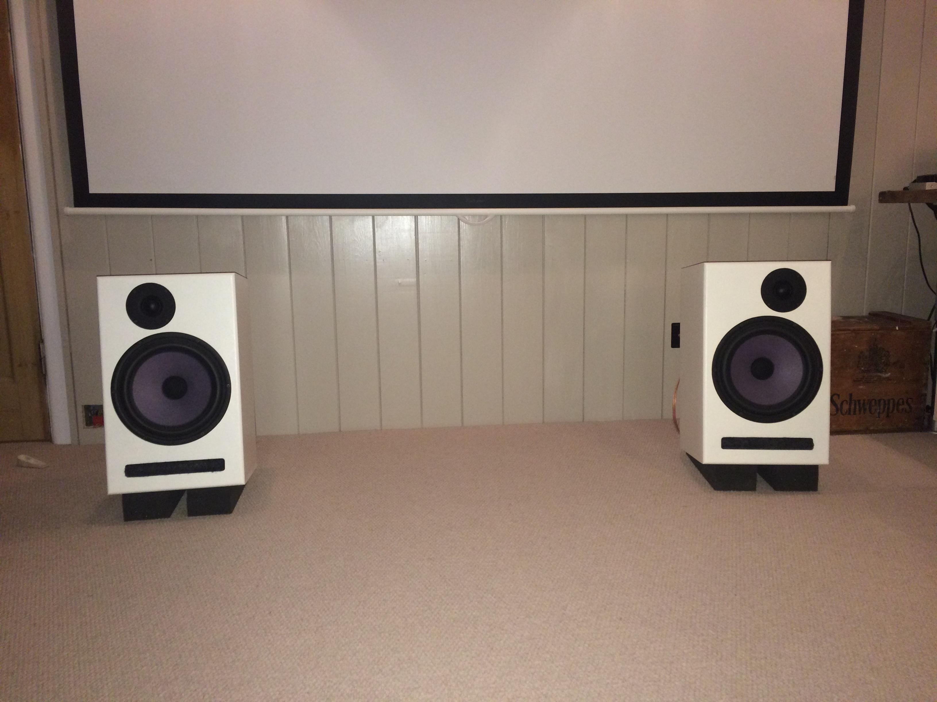

I made a pair of A26s as my first attempt at speaker building... just followed the Seas design. I can only compare to a couple of near field Genelecs that i've had for a few years but I'm very happy with the results. I'm now half way through building an L26ROY sub... not sure they need it for music but I'm using them for HT as well.
