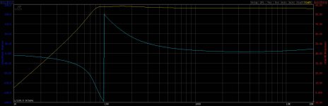

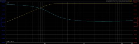

Two visualizations from a sim (yellow is FR, blue acoustic phase, phase scale left, dB scale right).
BTW, these sims are for the same driver in a similarly sized enclosure. The bass extension of BR versus sealed can easily be recognized. But, it comes at a price.
Sealed gives 180 degrees as would be expected from 12dB high pass.
And vented gives twice that.

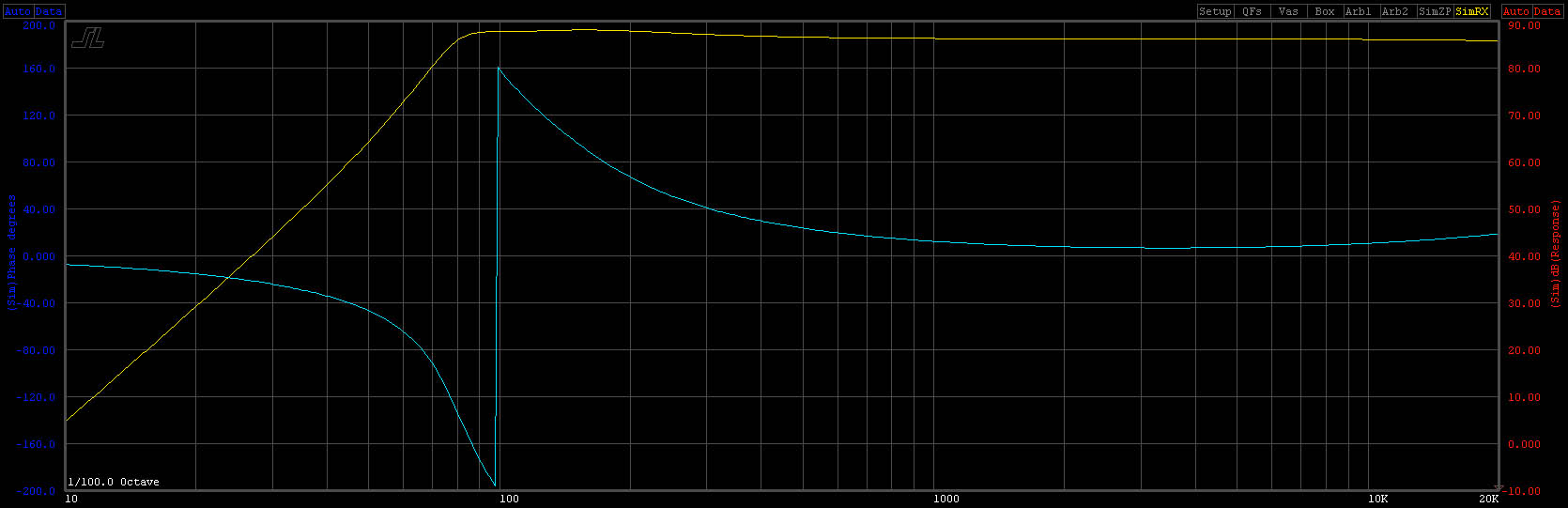

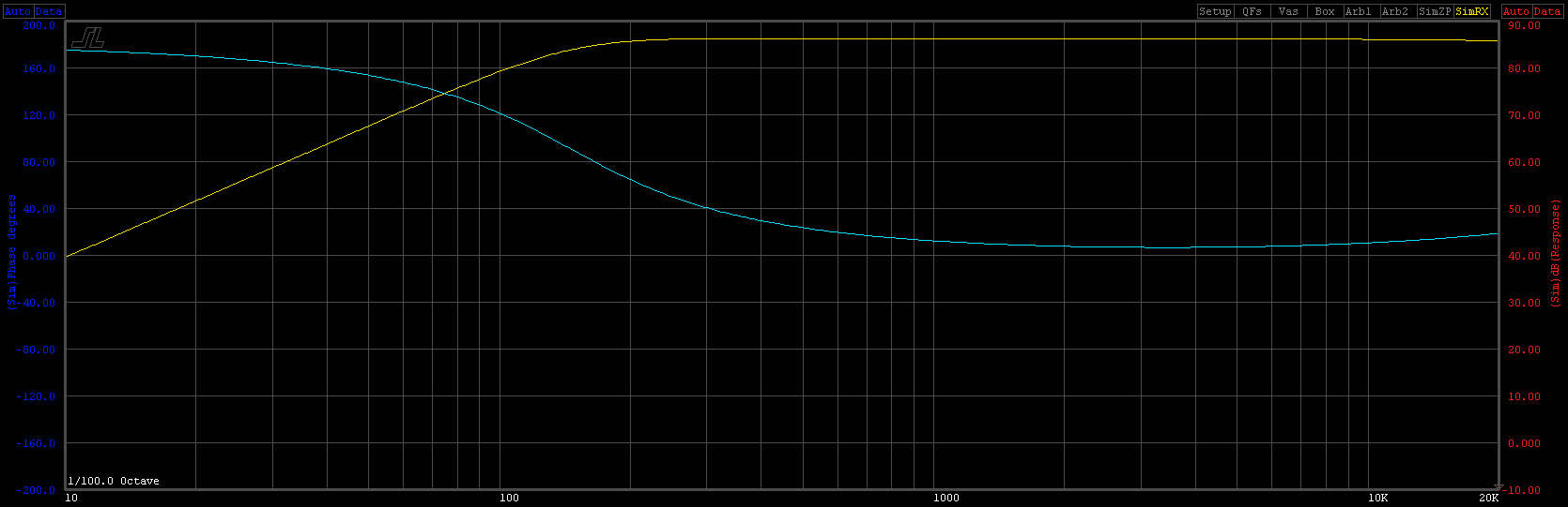

Sorry Andrew, you see it wrong. Sealed has a second order character and BR a fourth. With the associated 12dB/octave and 180 degrees phase shift for sealed and 24dB and 360 degrees for BR.
I have this from old textbooks, measurements and sims, but I also took the liberty of Googling on your behalf, and the first quote that came up:
