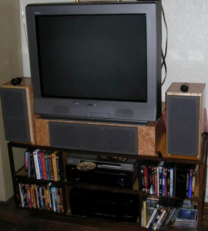

MJL, read it carefully. I didn’t mean MTM literally standing on its side. I said MTM in the center (horizontally I would think) and “sides”-side speakers.
Generally, my concern is with all horizontally placed speakers and their dispersion in the room. MTM being more friendly (yet not ideal) would be my choice and it actually is in my own system (with 3rd order Butterworth).
Nothing wrong with my reading ability. Below is a picture of your system, showing the centre speaker (an MTM on it's side). This configuration causes lobing in the upper midrange. Jnb suggested the D'Appolito xover would solve this, but TBH I'm not convinced. I don't believe a 3rd order BW would cure the lobing problem.
Dispersion from this horizontal array in this configuration would be worse than a typical 2-way, vertically oriented, due to lobing.
It's pretty much a myth that a sideways MTM will give better dispersion.
It is one of my systems.
Given the fact that most center channels are horizontally placed, I would and did chose the MTM for a reason that it is more forgiving in terms of dispersion.
In horizontally placed D’Apolitoed MTM lobbing problem will exist and the crossover will not correct it one way or another. However, it’s generally more forgiving, hence the choice. Hormonally placed MTM will not give you a better dispersion then a normal 2-way speaker located vertically.
Not everyone will be able to place a speaker over the TV set nor it’s always possible.
Fant already has a MTM center channel you think he’ll bracket it to the wall because it sounds better that way?
I can’t do it either because the walls are total crap and I’d have to bolt it through to my neighbors (don’t think they’d approve).

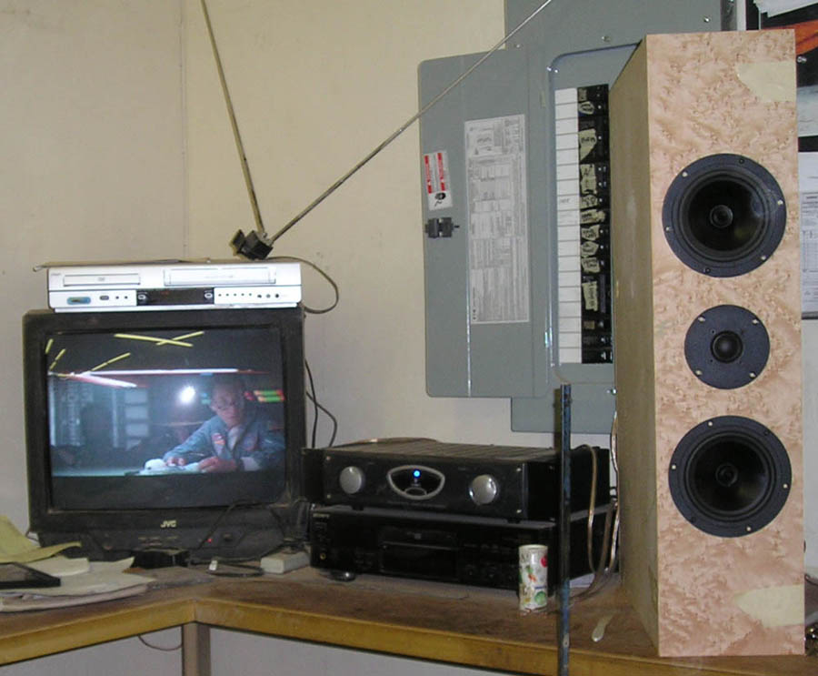

BTW, this MTM was custom build for this location and it is not on its side. It’s on its bottom. The sides are on the sides.
This is this MTM on its side.
Here is an article on MTM centre channel speakers. It explains the problems.
Yes, the bottom. When an MTM speaker is talked about the picture that most people will see in their heads is the vertical arrangement. That's what I was talking about, especially considering that this speaker type performs very poorly in a horizontal position.
R-Carpenter said:This is this MTM on its side.
Why is it useless to try to even out frequency response in the simulation? Granted, it’s not going to be the same as a real thing but you could get a pretty good idea of the outcome and then tweak it. I don’t like hoping for the best and I like to rely on measurements, not my ears. Simulations aren’t ideal and you can’t go just by simulation but it’s a great tool.
That's an MTM standing upright (on it's bottom).
