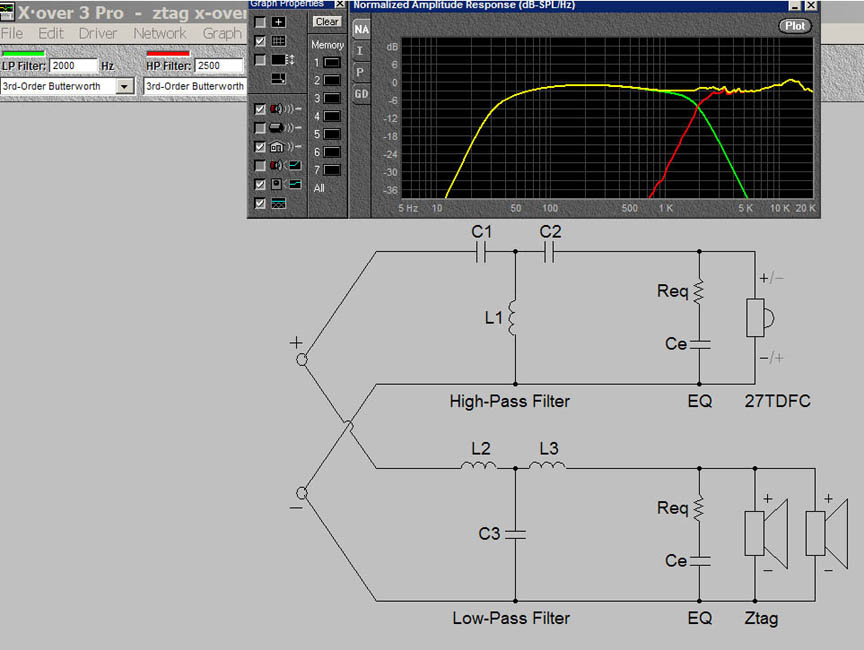

I don’t have enough confidence to go and say PE guy did a bad job, but there’s a possibility that It was put together rather in a hurry. I wouldn’t mix together different types of crossovers. Here’s a 3rd order Butterworth for MTM. 13 kHz bump can be notched out with LCR all though the inductor is going to be huge.
R-Carpenter said:
Ok, so how would you go about calculation of impedance curve of the lower woofer and it’s effect on the crossover performance? Also, Since BSC starts at 1700hz, would it make sense to cross it over higher? Do you design the x-over as a 2-way with Zobel and then add secondary woofer with coil and hope for the best?
The impedance curve of the lower woofer will match the upper. A Zobel could be put on the lower one to trim the peak at resonance slightly, but I don't think it's needed for rising impedance since this driver will be crossed below any serious impedance rise.
Like I said, some BSC. Cross the woofer at 1700 and it's no longer a 2.5.
Adding a coil and hoping for the best is what I do. I have designed several crossovers with software and have always had to change at least one thing. These (in my view) are just a good starting point.
Using different crossover alignments are done all the time. I think the PE design is good to start with. Trying to improve it without hearing it is not the best approach.

Somehow I missed the fact that the highpass is a Chebychev. I wouldn't use that alignment. Also this tweeter will cross lower than 2.5K. 2k would be better I think.
I don't have a problem with mixed alignments and slopes. Do what works best, keeping an eye on phase. Still, I think I'd try a 2nd order LR for the midwoofer and tweeter, 1st order BW on the woofer (if going with 2.5 way).
R-Carpenter said:
BTW, did anyone notice that PE guy used Chebichev and Butterworth x-overs together and different x-over frequencies? Lobbing and tilting of Of-axis response will probably be quite big and then some.

New curve from PE guy. I talked to him and pointed out I thought he was using the wrong tweeter curve and that the 27TDFC could be crossed over lower. He re-did the curve and this is the result. Definitely better, I kind of think this is a starting point I can live with. I still wish the lower part of the woofer curve could be flatter but we'll see how this sounds to start with.
fantfool said:New curve from PE guy. I talked to him and pointed out I thought he was using the wrong tweeter curve and that the 27TDFC could be crossed over lower. He re-did the curve and this is the result. Definitely better, I kind of think this is a starting point I can live with. I still wish the lower part of the woofer curve could be flatter but we'll see how this sounds to start with.
You've completely ruled out 2.5?
The xover design still uses Chebychev filters. Why he's using that, I don't know.

I asked the PE guy why he chose that allignment and he said because it allowed him to get the response the flattest. I read up on it a little this afternoon and the reviews seemed mixed, kind of what someone else said earlier about whatever allignment works. There was some talk about it being a "ripple effect" but I don't see that in the curve. I do think it looks better, defininately in the 1K area, and with the new tweeter curve it is better in the high end as well. You know somebody asked me earlier this evening about the box type and it occurred to me that the curve I am looking at doesn't take into account the low end I will get from the box, so it may be better then I first thought.
