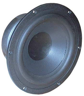

91.5 db is quite good actually. What are the crossovers?
http://www.speakercity.com/Merchant2/pdfs/TC90TD5.pdf
I'm not sure exactly what the crossover points are but they are an emulation of the wilson cub crossovers. That speaker uses the 2 - 6 1/2" mid-woofers and a focal TC120 tweeter. The woofers that wilson uses are very good quality seas I think. But in talking to one of the designers of the Zetags he compared the Hi G1 woofers to those.
fantfool said:I'm not sure exactly what the crossover points are but they are an emulation of the wilson cub crossovers. That speaker uses the 2 - 6 1/2" mid-woofers and a focal TC120 tweeter. The woofers that wilson uses are very good quality seas I think. But in talking to one of the designers of the Zetags he compared the Hi G1 woofers to those.
Ok, so my understanding is that you’ve build the boxes that were designed by someone else, made the crossovers without knowing exactly what and how they are and used the drivers that were suggested. I wander why the results are bad.
I would definitely start with measuring the woofers. If you use 120 tweeter without modifications to the crossover, you will get bad results. 120 have different efficiency, also much lower fs and different frequency response. You can’t just take one tweeter out, shove in a different model and expect to get to heaven. It’s not going to work.
My opinion is this.
1) Measure the woofers. If you have put lots of labor in to this project, it’s a good idea to get Woofer Tester from PE. After all Focal tweeters are expensive.
2) Try to figure out crossover the best you can. Take it out of the speaker and at list post a picture of it here.
3) Your closed center channel MTM should have a different crossover from ported main speakers.
4) Stuffing and changing the boxes or swapping out tweeters is not going to help unless you know woofer parameters
5) You will probably end up making new crossovers. Focal 90 is not a bad or inefficient tweeter at all. It does have a high Fs which makes it more suitable for a 3 way design. It could be used in the MTM but model 120 with Fs of 800 is a better choice. Again, can’t swap them without working with crossover.

Did you get any other specs on that driver? Also, what did you think of it?
fantfool said:Did you get any other specs on that driver? Also, what did you think of it?
Yes
Fs 36.5 Hz
Qms 9.09
Qts 0.41
Qes 0.43
Vas 25.8 litres
BL 7.30
efficiency 86.8 dB 1W/1m
These kinds of drivers aren'y my cupof tea and i was selling them for someone so didn't really do much more than flog them
