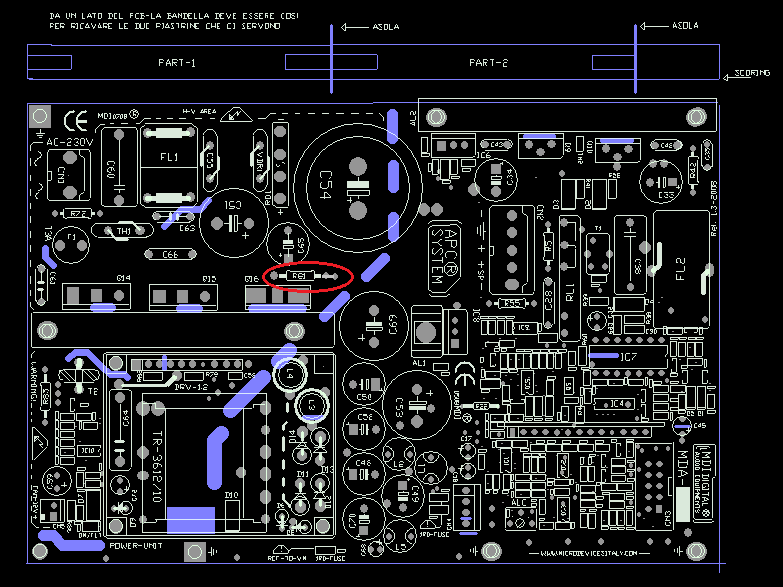

returning to Resistor,if it is added below, the value must be 330R 1/2 watt metal oxide (no carbon).
Increase SIN right at 1kHz, 18W (4R) but up to 30W with burst at 4R. so the difference is great, listening
In the evening I put the photo of the location of the resistor.
(When use iron solder, disconnect all cable from MDA-400)
Perhaps for some it is easier to solder a resistor at bottom (in parallel).
Specify that this is not a modification, the mda-400 return in original as default. therefore do not alter the reliability. will continue to operate the current-limiting in amplifier, and the smps, short-circuiting included.
A) If replace the resistors, the new value is 150R metal oxide
B) if you add in parallel at bottom, the value is 330R metal oxide
Important: disconnect all cable, input etc.. from mda when use iron solder.

The resistor was changed and I report that for me it is a good step up in performance so please guys, do yourself a favor and change it or solder the second MOX on the bottom.
I decided to exchange it and made my life quite difficult, the space is not much and I had a friend with desoldering station remove the cap that is close and we tried several MOX resistors before I found one that would fit. And in my case there was another small resistor that is not in the picture above(smaller and kind of grey in color, the one you have to change is R81, it is red and is almost under the transistor, a bit bigger, has another hole close to the leg).
So if I have to do it again I will just solder the suggested value under the board. For me there was no need to go back and compare - Roberto will hate me but I will advise everybody to listen to the MDA400 with the 150R resistor in place, the difference is very obvious. Just be careful with the soldering and take precautions.

Hi, Roberto, so for my bass guitar, maybe I better not change anything ?
You can,it's better just for guitar bass, but check well this resistor (see photo of pcb) maybe is already correct (150R).
... but check well this resistor (see photo of pcb) maybe is already correct (150R).

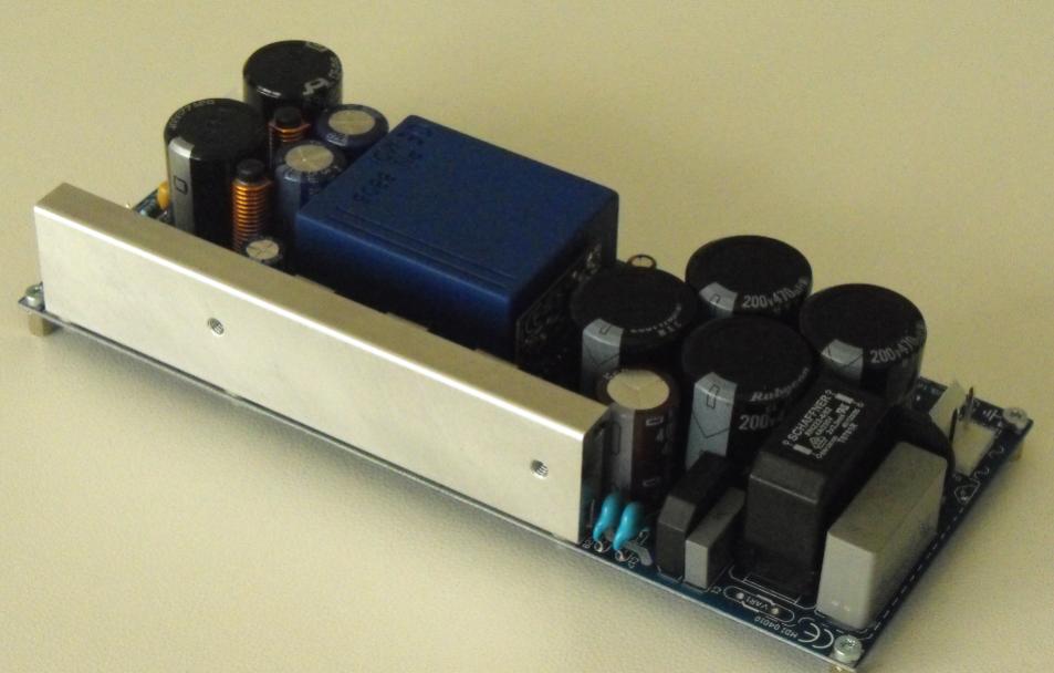

New DPS-600
hi,
I am that some expect this smps, then use this thread for info.
This version replaces the DPS-600 (already used the same circuit linear regulator with fast response of the DPS-500)
alignment for the production, it is agreed to use at this point, the same pcb. performance remains in the origin of the DPS-600, slightly better for higher filtration capacity. Power-Unit remained unchanged.
To offer a very competitive price and oriented class AB, were removed the following functions:
No voltage output for Class D driver.
No AL bottom plate.
Available only from + /-36V to 45V (ADJ trim on board +5 V) and AUX + /-20V LC filtered unreg. 2x250 mA.
Power output 500w (12A;16 Amp repetitive peaks
Remote control yes.
Notes: Aux may be required up to + /-90V.
Special price 120€

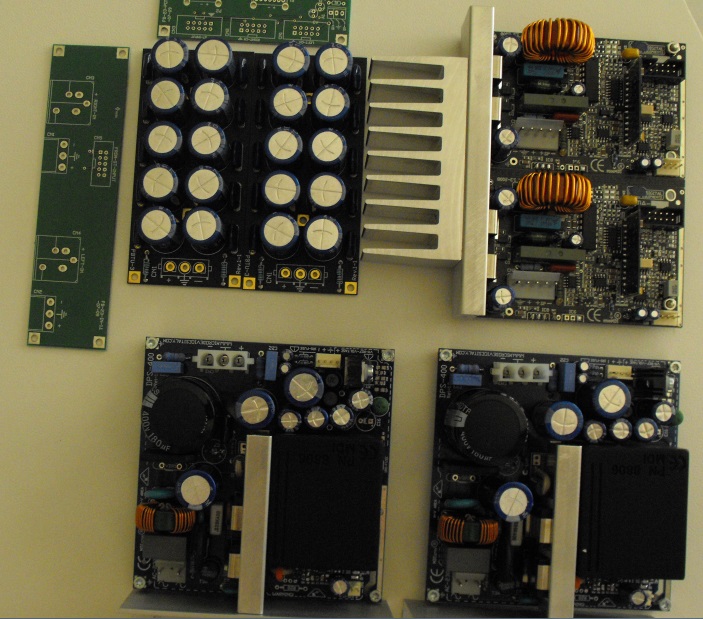

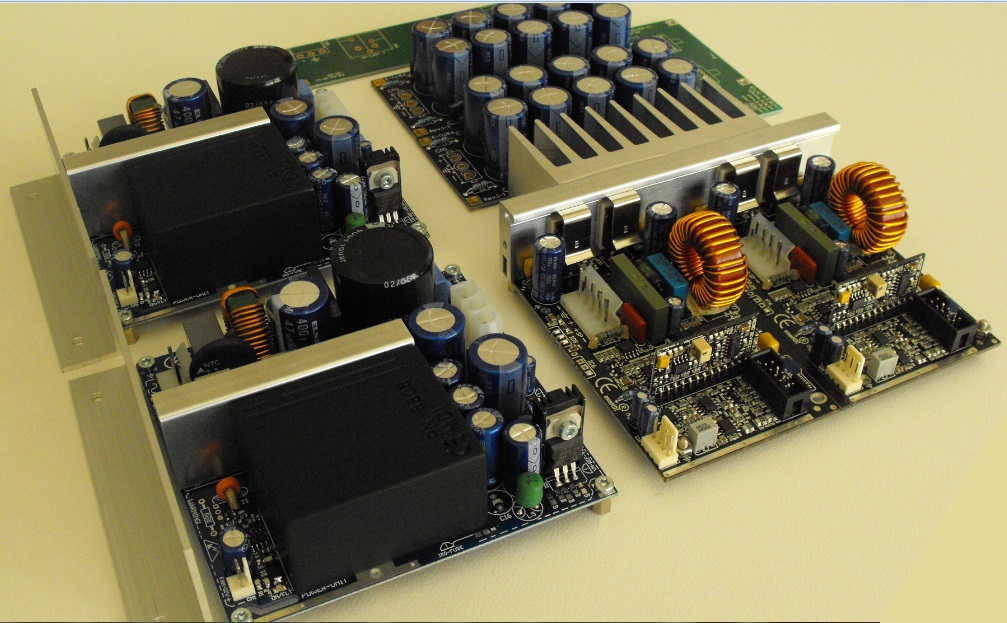

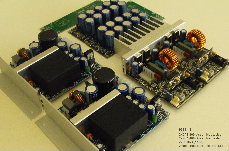

KIT-1 (2x300w@4R) SDA-400 Dual Mono
Kit includes all for assemble in your 1U case:
Spacers,screws,components for PBTU-3 and input board.
Components/materials as shown in photo.
Amplifier and smps well known, absolutely free of defects.
A little tuned dps-400 for this application. (from new release)
I can only offer 20 kits, one at price of € 200+22 for spedition.
40 € per piece about...
This amplifier, complete with aluminum parts, will be available on the shop AudioPower at € 395 + VAT + Delivery.
I hope you look good, not like a chip class D (without manufactory, right smd i mean, so ultra low price of production).
Happy listening.
P.S. 20 Kit ready.
DPS-400 for this kit,pcb blue.
Regards
