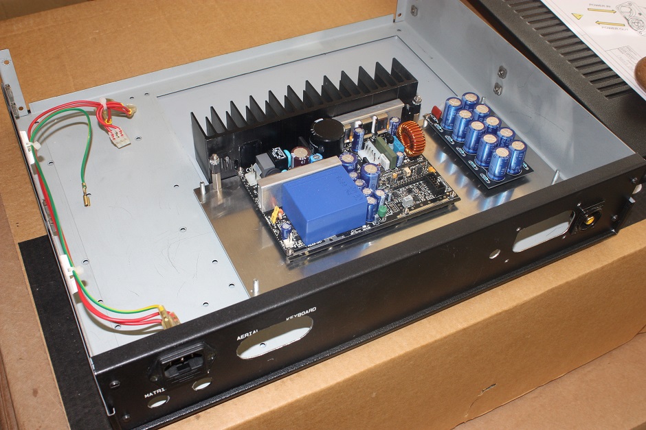

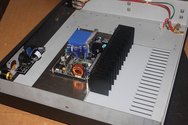

I see you've changed, you now have a nice bottom .. plate.
can lift 2-4mm the amplifier with the spacers or bolt 3MA, when fixed to the base.
... you will create the ice with this heatsink!

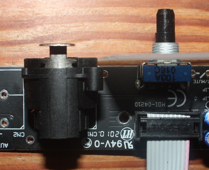

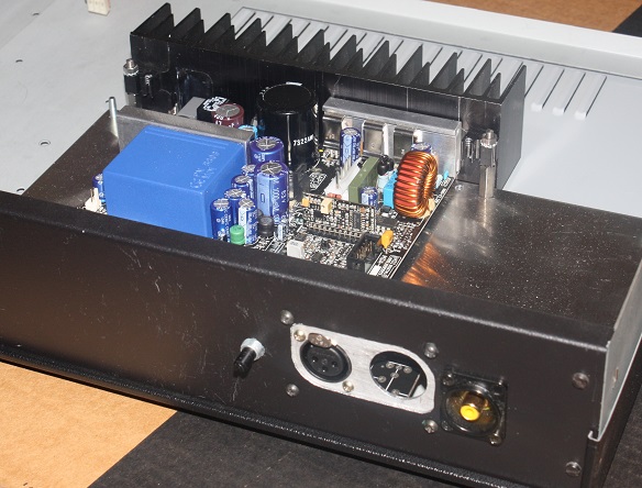

ok, just for you
but doesn't matter, I have to redo it anyway
did not notice that middle pot is lower than middle of XLR (horisontal)
I will mount a jack plug in the place of output XLR
and one RCA next to it
I suppose they may all function as in and out(aux)
and I plan to have hi-z buffered instrument input on the front
for that I may need a switch

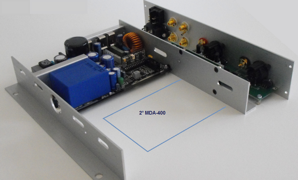

Good in the end to find a simple double panel.
that is intended to use this amp? just my curiosity.
yes, input signal is repeated at output, such as passing through to go to other active sub (in our case this input board).
in a few moments, I put aluminum parts and the rear panel stereo for two mda-400, as requested by some diy via pm.
regards
just my curiosity.

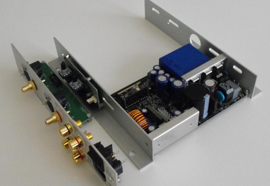

back panel JACK or RCA input for use as power amp
front mounted jack with hi-z buffer for direct connect to instrument
The rear panel includes a complete anodized frame, screws, etc. to be mounted in a few minutes. CNC machining.
the components on the rear panel, are exactly the ones in the picture.
all signals pass from the cable 10Pin (assembled), so it's plug & play.
Regards
Regards

Well, maybe you use unbalanced input I think.
remember to close one pin (-) input to AGND for this.

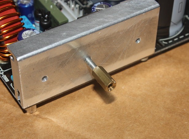

btw, I manged to drill a hole, cut thread, and mount a stud mount pin
and cut a slot in a stand mount, for screw driver
(pre drilled holes did not match my heatsink fins)
also cut a hole in back panel for Neutrik mains PowerCon in/out combi
and still just about enough space left for two SpeakON connectors
and also adding a traditional speaker terminal
if you use a common screw to create the thread, you must change the screw shaping as in the picture (or risk a drama)btw, I manged to drill a hole, cut thread, and mount a stud mount pin
with a simple file for iron.
