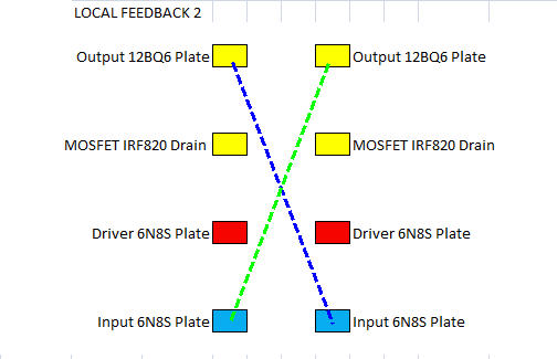

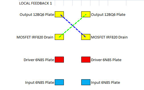

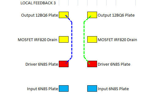

I have attached several scheme for local negative feedback. I hope i don't mess up the phase.. The feedback will be plate-to-plate like we can find on Alex Kitic's RH84 or Baby Huey. The dashed lines indicate the feedback resistor. Notice that some feedback will be cross-connected as each stage flips the phase. Do the schemes make sense? Help please. I prefer a mix between the shortest local feedback to drain (Option 1) and the long one (Option 2). Hope it's easy to understand.

Please don't mention AK's "P2P" in vain... Option 1 won't work, since the drains are tied to the B+ directly. Option 2 seem pretty far for a "local" FB, so option 3 looks the most promising. Have fun simming...The dashed lines indicate the feedback resistor. Notice that some feedback will be cross-connected as each stage flips the phase. Do the schemes make sense? Help please. I prefer a mix between the shortest local feedback to drain (Option 1) and the long one (Option 2). Hope it's easy to understand.

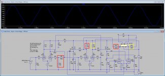

Just finished my #27 line stage and ready for the next step. It's either continue with the abandoned 6C33C OTL or try a screen drive amp since i just got my 12BQ6GTs, 12V heater version of 6BQ6GT. This thread is to lay out the design process with the hope that someone will catch any mistake before i go to far. I have finished several tube-related projects such as 6FD7 Class AB amp, 6LR8 SE amp, Aikido line stage and Futterman OTL headphone amp so while i am still a beginner in the world of tubes, i know enough how not to kill myself.
Been there; done that. You don't need screen drive to get that 40 -- 50W. You could easily nudge up V2K as the max screen voltage is specced at 200VDC. I didn't need to do this in the original design since the DC rail was a bit higher, and ~40W more than enough, so I stayed with the most common 150V of screen voltage.
Now, what is the target plate dissipation, Pdiss? 6BQ6GT is rated for max 11W Pdiss. I read that this is rather conservative and we can actually run it a bit hotter but i would like to stay within specs. I'll choose the usual 70% of max Pdiss which is 70% x 11W = 7.7W. Assuming Vak = 300V, this means Ia of 7.7/300 = 25mA. The actual Vak will be lower since i'm using mixed bias and end up with even lower Pdiss. This will be clear on the next paragraph.
Don't! For audio amplification, you can ignore that PD spec since that was for horizontal deflection duty (or if you were doing an FM xmtr project) which is a good deal more demanding than audio amplification. You can bust that spec without any adverse consequences. The bias point I used for Le Renard gives 17.5W with no trace of color on the plates, and I'm still using the same finals I installed in 2007. Hotter bias definitely improves both the loadlines and the sonic performance.

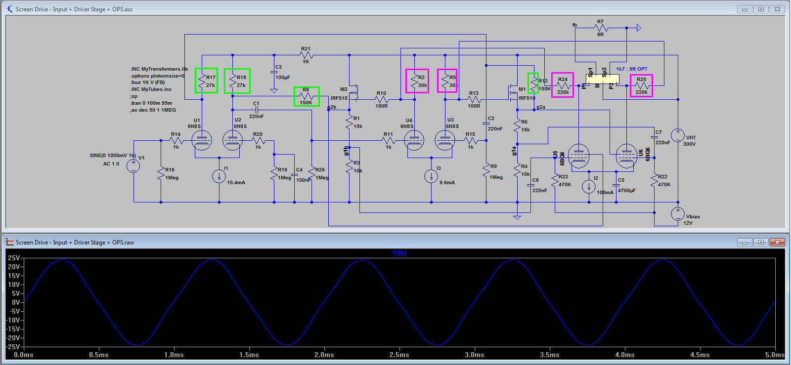

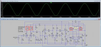

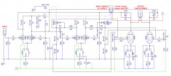

Sorry for the spaghetti schematic but for convenience i highlighted the feedback part.

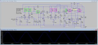

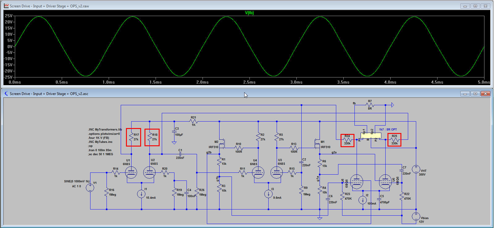

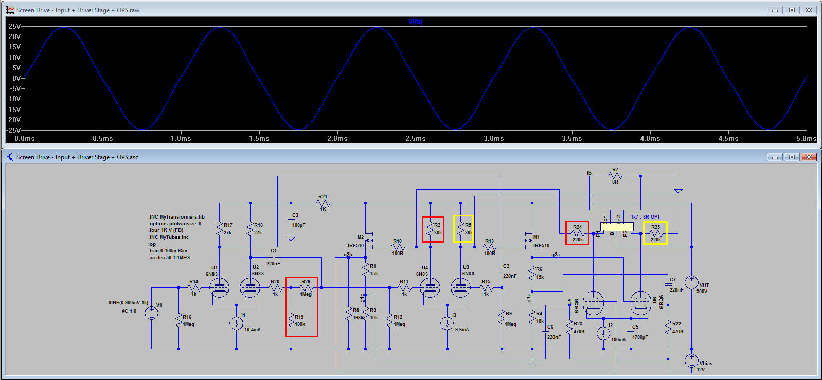

Here is the simulation for a very similar design I made last year. The sims all looked good so I built it. I could never tame the oscillation that it had, which claimed the lives of at least 10 mosfets. The prototype got robbed for parts before I ever really figured it out. It was admittedly a rather crude layout done when I had no lab and worked on the concrete floor in a cold garage.
Thanks George! Your output to driver feedback resistor values is something that i really need to iron out this crossover distortion but unfortunately i can't afford more feedback there as i'm starting to move the clipping limit to the driver stage LTP and not at the output stage per usual. This low B+ is quite troublesome.
I did introduce another feedback loop from the driver to input LTP. It helps but i bet not as much as more feedback from the output would. With these values as shown, i'm getting 5.4% THD at 40W.
Something surprising came out when i tried to change the 30K+220K OPS to driver stage feedback resistor to 33K+180K for more feedback. THD actually increased to 5.9%. Not sure what happened..

Thank you Anatoliy. If you're referring to global feedback from speaker output to input LTP, i would like to avoid it. That many ac-coupled stages can't be good for stability, would you agree?
I did try output stage plate to input LTP feedback if that's what you mean.. so like Scheme #2 on this post http://www.diyaudio.com/forums/tube...q6gt-amp-feasibility-study-3.html#post4614287 It definitely looks better! 3% THD at 40W.

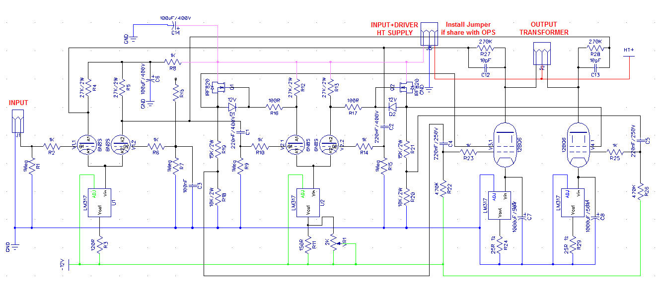

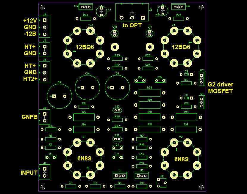

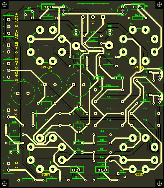

Rough layout attached. Inputs are welcomed.

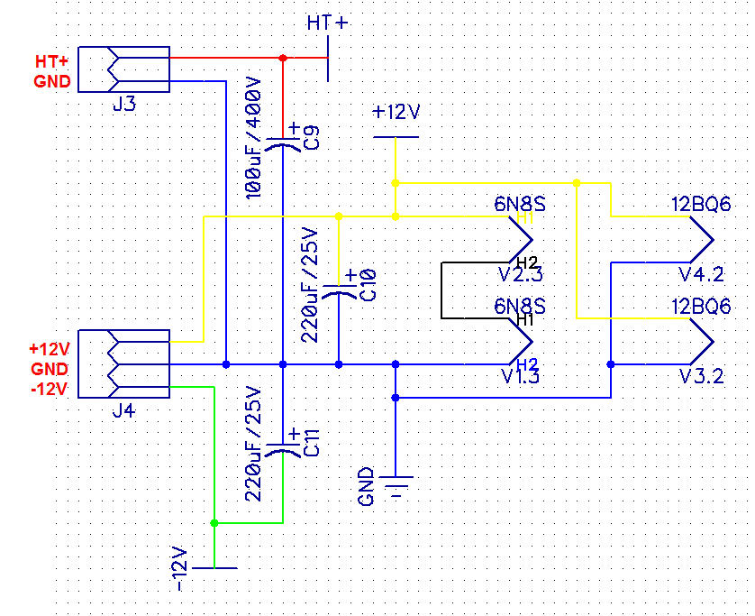

HT2+ is for the driver & input LTP supply and on J5 there will be a jumper from HT+ to HT2+ if we are using the same supply as the output stage.
Tubes will be on the same side as the other components.. so most probably no tubes will stick out from the chassis. The only part that will need some heatsink would be the MOSFETs and they will simply be bolted to the chassis.

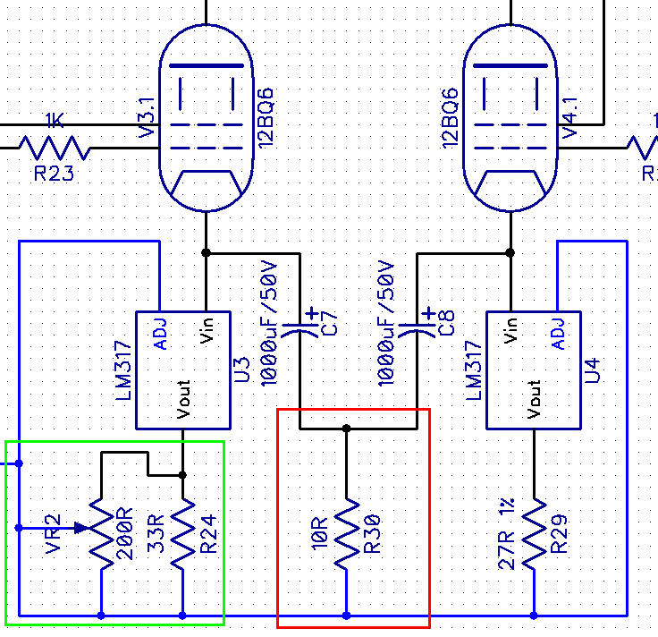

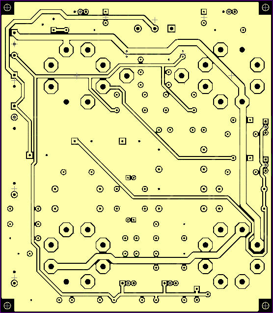

Finished routing the PCB. I followed George's suggestion to allow some bias current adjustment on one of the output tube and added 10R 1% resistors on each plate to measure current. I also added this 10R resistor highlighted on red square. I don't know what it's called but it helps to reduce THD considerably. I'm getting less than 2% THD at 40W. I think it helps to balance the output tubes and introduce a small degeneration. CMIIW.
As can be seen, i'm using ground plane and route all the power-related traces on the same side while signal traces on the other. I set 0.5mm clearance from the ground plane to other traces. I seem to recall that ground plane is not advisable in tube project PCBs? Is this correct?
Next target will be to getting all the parts, measure their physical dimensions and adjust the PCB as necessary.
