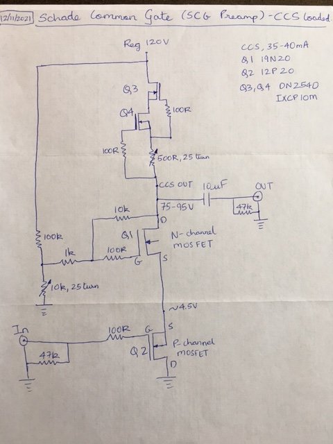

CCS Version
The CCS-loaded version’s performance is out of this world for a single gain transistor. Subjectively, it sounds very sweet and clean, but somewhat recessed. On loud symphonic pieces and rock music, it sounds better, but on quieter stuff, it doesn’t quite have the presence and 3D-ness of the resistor-loaded version. This is kind of an amazing subjective result and shows that we (or at least me) probably want quite a bit of that negative phase H2.
The CCS is formed a pair of DN2540s that produce an extremely stable CCS. It is rock steady no matter what is happening in the rest of the circuit. The other benefit of the CCS is that you can set the current independently of the Vds on the gain MOSFET. It lets you explore a range of operating points. My power supply is a Salas Shunt Reg and I am limited to about 40 mA because of the shunt reg capability. There are probably other, better operating points elsewhere. See post below about the Schade/triode curves.

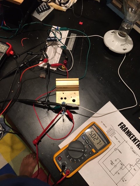

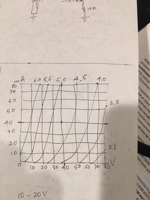

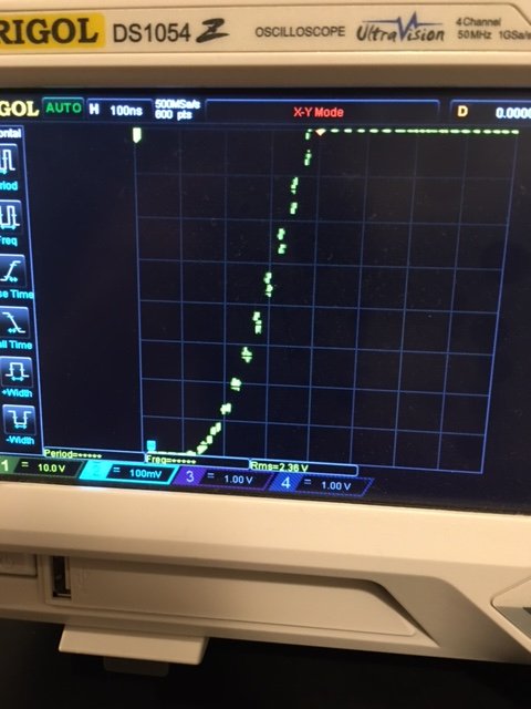

Got some curves from the composite device including the 10k and 1k resistors using Mike’s Frankentracer. I wanted to see how the Vgs values and curves looked in the 0-100 mA and 0-100 V region. Not having the Tek scope, I used the ‘very poor man’s curve tracer’ and tried to draw by hand the curves I was seeing on the scope. Please excuse the drawing, the point was to try and see what was happening. It is pretty linear everywhere but there is quite a bit of ‘slop’ with increasing Vds. For the preamp, I tried various Vds points between 30 V and 95 V at about 35 mA and got the about the same results. But there may be other points and the loadline itself that you can play with.
All said and done, pretty good emulation of a triode.
considering that Iq/biasing is set either with resistor or CCS, feel free to play with Schade resistor values, thus changing transfer function by your liking
also - voltage potential for upper mosfet - I prefer it firm as possible, at least in AC domain ....... meaning - I believe it is good having decent elco across 10K trimpot
in my shenanigans (difference - not line stages) , I did found 750R and 18K as nice Schade combo ......
