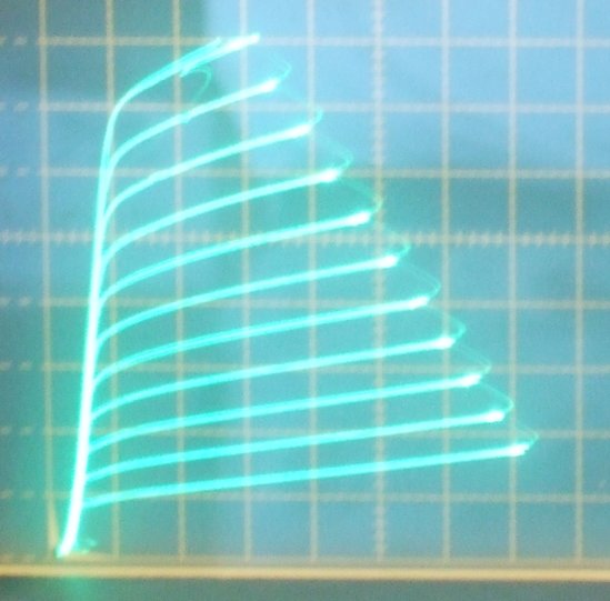

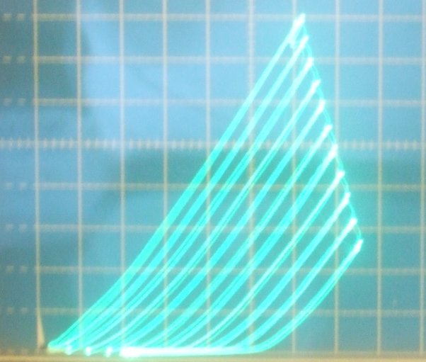

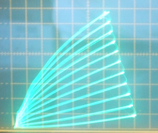

Here are some similar variations using the 6HJ5.
1) 6HJ5 with Schaded g2 drive (20 mA/div Vert, 50 V/div Horiz.)
2) 6HJ5 with just g2 drive, but through the same 22K Ohm resistor used in the above Schade R divider setup. (20 mA/div Vert., 50 V/div Horiz.)
Looks awful, so the low g2 Z is what is messing up the Schade divider. But amazing how well the Schaded g2 (above) is able to almost clean up most of the mess.
3) 6HJ5 with direct g2 low Z drive (B. pentode) (50 mA/div Vert., 50 V/div Horiz.)
So g2 will have to have a Mosfet follower to drive it for any Schade arrangements.
That would then give g2 Schade curves that are evenly spaced, and nearly straight lines.
What I wonder is how that would compare with the linearity of g1 Schading. One loses the internal Mu of 4 in loop gain in the g2 version, but the g2 B. pent. curves are much more linear spaced to begin with. Could be close. But the g2 version is harder to drive.

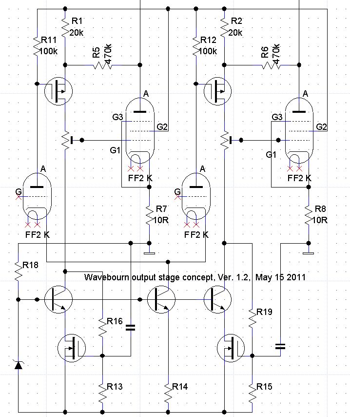

In the mean time, here is a "Schade" like driver proposed by Wavebourn some while back, using a P channel Mosfet hung from B+. (link provided) It should be adaptable to screen grid drive. It has the benefit of removing power supply ripple, which the typical "Schade" R Fdbk suffers from. (the usual Fdbk R references the feedback to B+ instead of ground) (Wavebourn's approach only has current sources between ground referenced and B+ referenced signals)
It also does not require the increased drive signal that is needed with a series R after a Mosfet follower. (for mimicking a current source drive)
One could also just connect the driver plate directly to the Mosfet drain, but that would need a buffer yet for screen drive. (Mosfet gate would be biased from B+ then).
