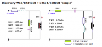

This 18W discovery design seems a point of departure:
18W-8434G00
Once you understand how it works, it's not hard to adapt it to other drivers in any of the 4 versions. You can guess the crossover values easily enough.

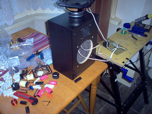

But, TBH, I think 6" paper bass is rather unrewarding. I'd fancy a polycone like a Vifa P17WJ a lot more. I did about 6 filters for my 6" effort, and none of them really won a cigar. :mad:

The rise in the frequency response is not as steep as shown on the SS own data, easy to deal with, just use a larger inductor according to taste. For a 2.5Khz crossover point ( max recommended ) a 1.35mH would do the trick. if you use it that high, you`d get into directivity issues which are easily observable, the cone area is closer to a 7" driver, either incorporate a waveguide to load the tweeter adequately, or use a lower crossover point.
