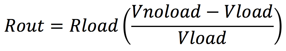

I have a DATS v2 system and there is no need to speculate on the size of the internal shunt resistor in the potted sound device.
I sent a 1kHz sine through it and measured 1.4V output into no load. Then I placed a 10Ω resistor across the alligator leads and measured 125.54mV. Here's how you figure out the internal resistor value (Rout):
Vnoload = 1.4V
Vload = 0.12554V
Rload = 10Ω
I had another message from SB to say that they had also tried the DATS V2 and were able to replicate my results, which were very close to the results they got from their in-house system at 0.1V.
So the SB drivers are quite sensitive to drive level when it comes to TS para measurements, but the Scanspeak Discovery units are not.
