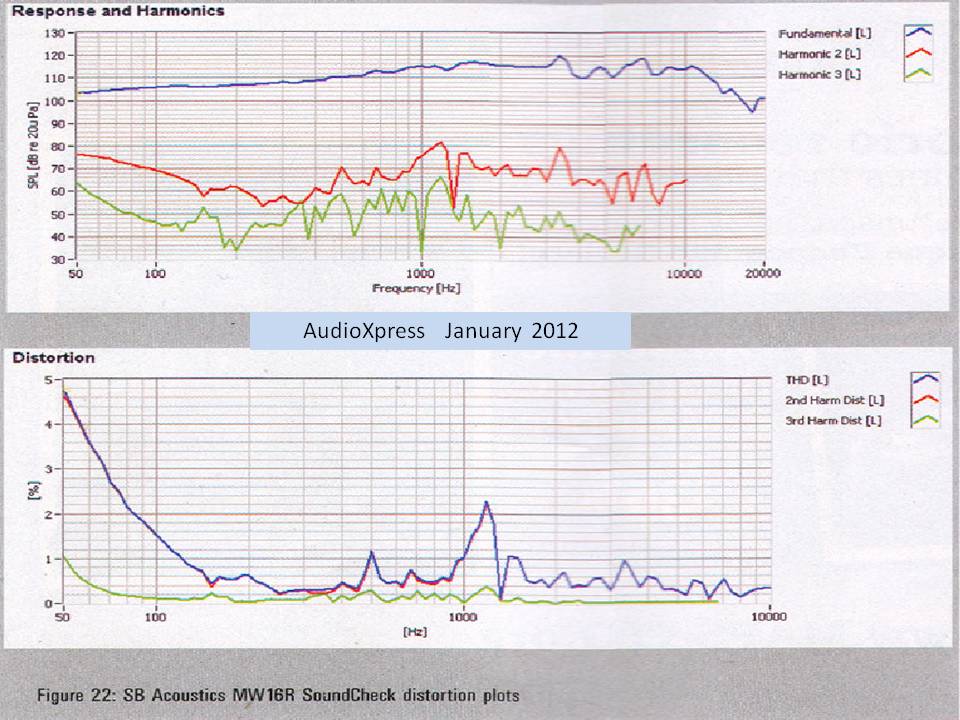

I had DADO-measurements of harmonic distortion on my system for MW16P-08. SPL cone edge resonance bump at 1,150Hz also seen in distortion plot is consistent.
Also, distortion measurments from AudioXpress magazine. January 2012 includes Klippel analysis.

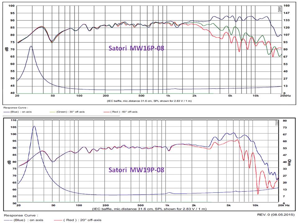

Also, SPL plots for Satori MW16P-8 vs. larger MW19P-8 in case your application might favor the extra Sd. The SB29RDC dome tweeter with Fs = 600Hz remains smooth down to a 1600Hz LR4 crossover and should blend well with both.
