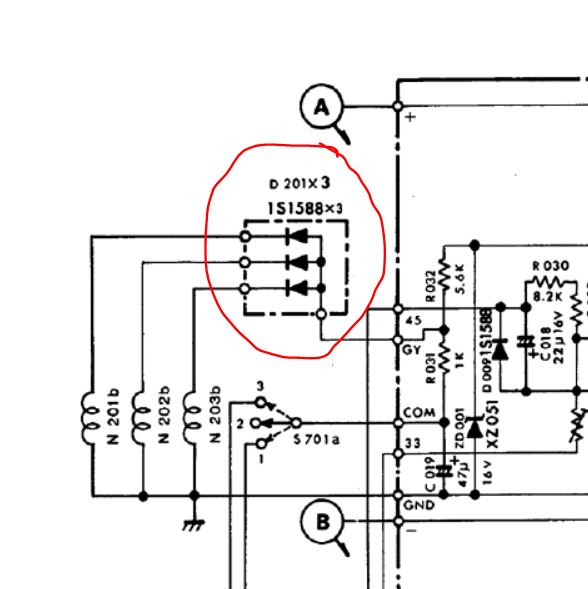

Did I ask you to check these earlier, the three 'commutation' diodes used for gating.
See if all three have an identical forward voltage across them as a first quick check when the unit is powered.

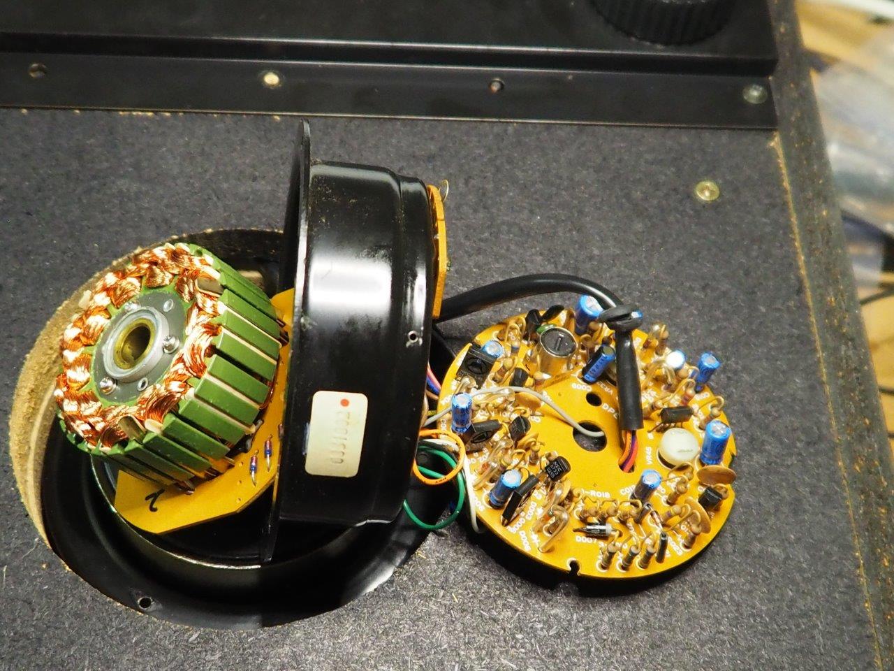

The motor hood hadn't been been removed as the tiny screws still had the green paint on them which was unbroken. Someone had looked at the PS section probably to check the fuse. One screw wasnt done up properly.
By brand new I meant original. They were all Elna caps and the old larger sizes. I had to go up a couple of Voltage ratings to get close to the lead spacing.
I did think of lifting the leads to the motor. I measured them earlier and got low v for 1 and 2. I noted the colours.
I had a quick look at the coils when I pulled out the spindle and didn't notice any burnt or damaged areas. I could look again.

D201 x 3 are under another cover below the circular board secured by 3 screws.
Let me know if I need to. The 2.2v should say something. I would have thought that if a coil was shorting it should show up on 3 others as well?

Carry on with the tests I mentioned in my previous post and check those three diodes.

Definitely look at those three diodes.
Also, does anything voltage wise change as you operate the speed selector and controls ?
The diodes look OK. Measurements across each are the same. I don't think I will be able to lift them without changing them out as there is very little lead wire to play with and they are very thin.[/QUOTE]

The wire on one of the coils is a bit loose and a loop sticks up. I pulled it lightly and it seems to be connected but that is a worry. If I unsoldered the stator(?) to do a continuity check I'm not sure I will be able to get it back together again.
