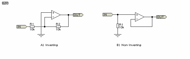

How about something like this (see attachment, figure A)? I assume that in order to make this adjustable one would put a trimpot where R2 is - or should I use a pot in place of R1 and R2? I suppose the total resistance should remain the same. So that would mean just associating the individual level pots with an opamp rather than sticking them in there by themselves - is that correct?

The left most diagram, inverting, is the one you should use.
R1 & R2 set the gain or attenuation.
With both equal to 10k the amplification factor is 1 or +0dB.
You can alter the gain by simply increasing R2. 30k will give ~+10dB.
or
You can increase attenuation by reducing R2. 3k will give ~-10dB.
That range for a trimmer should be adequate for any sources you have or plan to buy in the future.
You can replace the resistors with a pot. The wiper goes to the -IN. But you must fit some protection in case the wiper goes momentarily open circuit.
You also need to add a fixed resistor before the pot at the input and a second fixed resistor after the pot on the leg going to the output feedback tapping. These resistors limit the range of adjustment.
You can choose any range of adjustment that suits your gear.
+0dB to -20dB or +12dB to -12dB or whatever.
You must use a unity gain stable opamp, or a unity gain stable discrete opamp.
I suggest you use a socket and a cheap & good {NE5534an+compensation}, to get you started. Later you can decide to go swapping or go discrete. Or 5532 for two channels and without added compensation.

It's normally consdiered bad practice to put a variable resistor (as opposed to a trim pot) in the feedback loop of an op-amp.
In the feedback position, this can result in quite noisy operation. (I'm talking about a volume type pot. that is constantly being adjusted.)
The normal practice is to attenuate at either the input or the output.

How about a sealed cermet trimpot? After all I'm most likely going to set these pots once and forget them.

If you are going to set and forget then that is fine.
Just imagine an infinite gain amplifier (an ideal op-amp) with a dodgy connection (a variable resistor) in its feedback loop.
As you adjust the pot. the gain can vary from (say) 1 to (say) 1000000. The slightest crackle will be immediately amplified over 1 million times.
Personally I would use the pot to ascertain the fixed resistor that you need.

Ideally, yes - but I may have to use it in another room some day, in which case I'd have to reset it.
