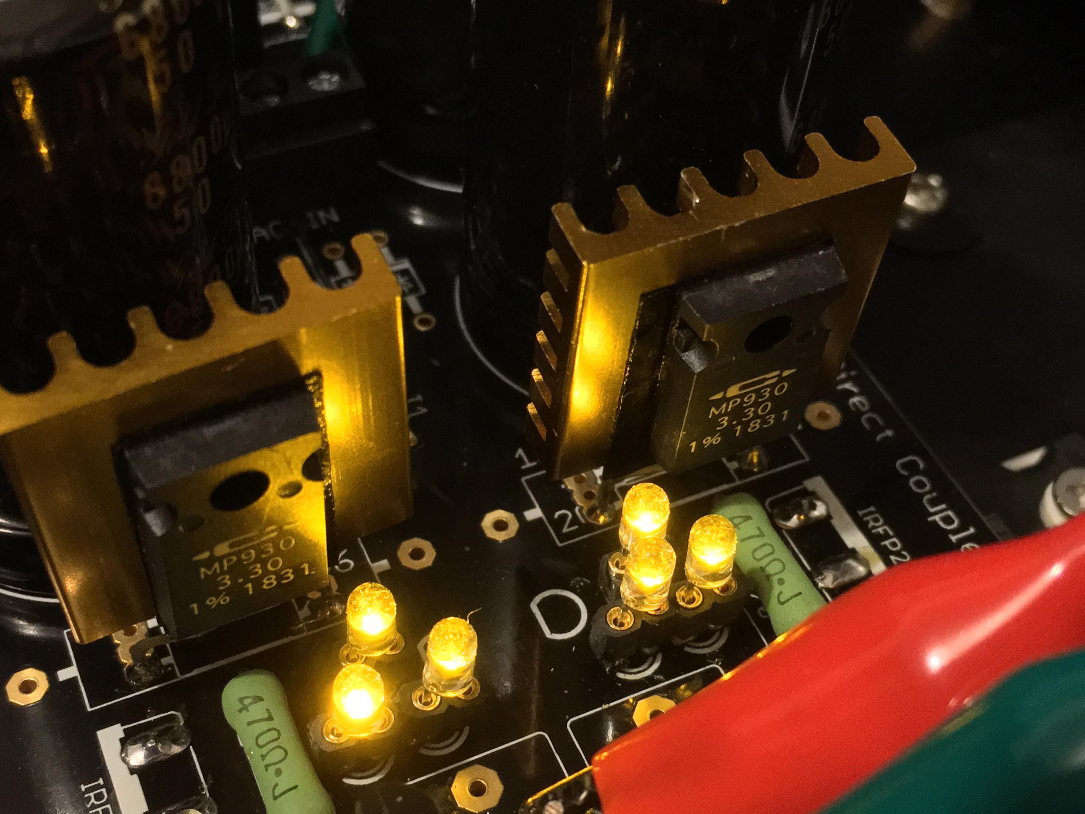

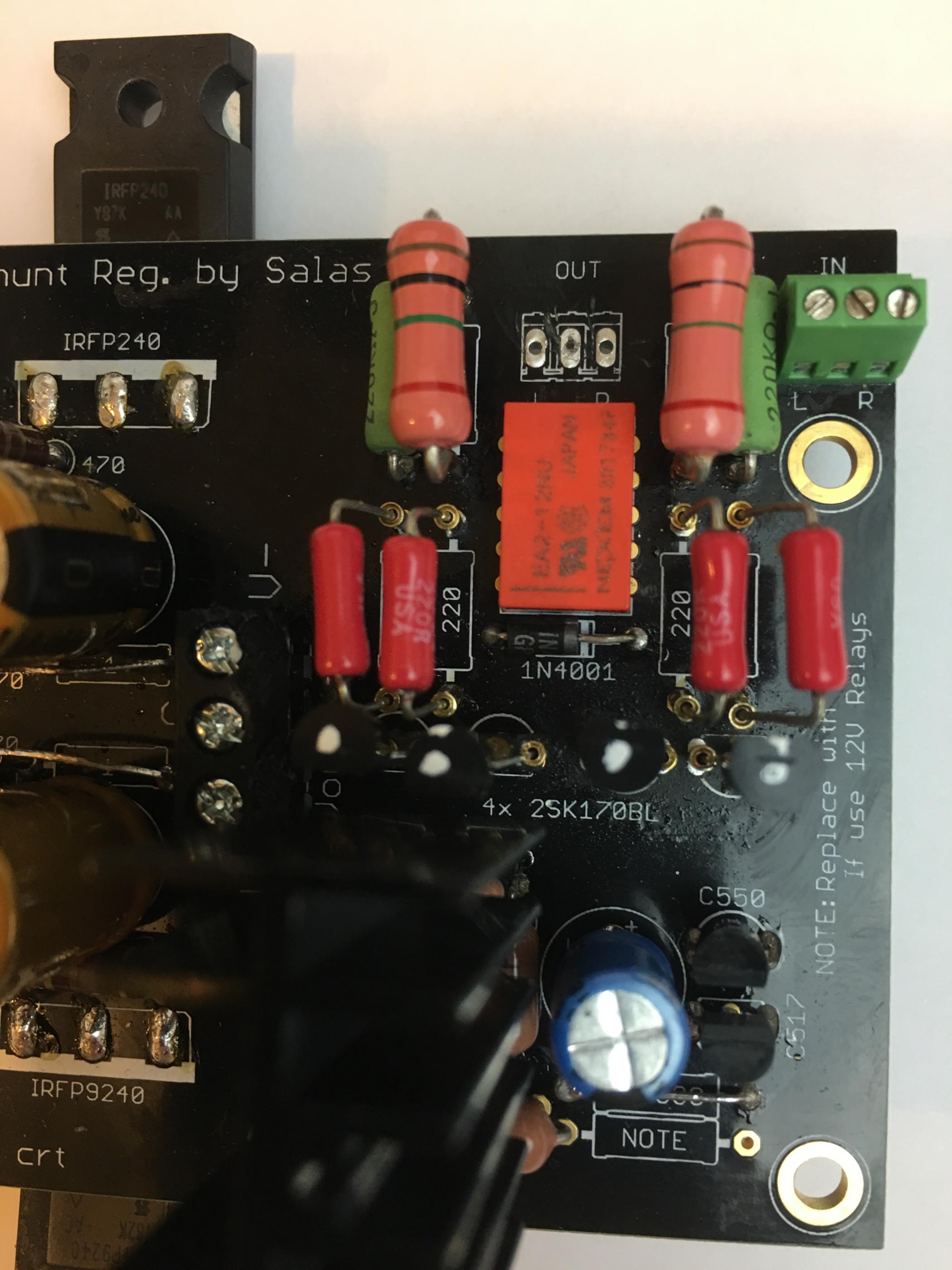

Problems of my DCB1 finally come:
Everything seems okay except the output port: L, R and Gnd are all shorted;
speakers only get loud hum....scary so I turned it off.
4 Matched sk170s are from Spencer-perfectly matched at 8.0mA.
R1 = 3.3Ω/30W for 600mA hot rodding.
all V measurements are good.
For the orange relay, I remember it is 12V so I shorted the resistor.
Appreciate the help (It is bed time here so I check in the morning)

Hi Salas,
Here is my measurements this morning.
yes there is a click from the relay after 6 seconds.
I measured the continuity of the output holes after the relay click:
R and GND are shorted(beeping) (offset=233mV!!!)
L and R are shorted (beeping)
L and GND are NOT shorted (no beeping)
When power off, all three holes of output are shorted.

Don't involve the continuity beeper when the circuit is alive. When its powered down, or before clicking, the relay shorts outputs to ground anyway in all modern DCB1 PCB versions. Only measure DC offset. Clean flux residue thoroughly on both sides. Especially in the four signal JFETS and output relay area.
The noted voltages are alright (except the one side offset in red). The voltage drops on the setting resistors suggest circa 460mA for 3.3R you used. For more you would need green LED triplets but in my opinion that's enough hot-rod you already have.
Thanks Salas. I have gone crazy with 3.3Ω for 600mA Hot rodding! It should be good.

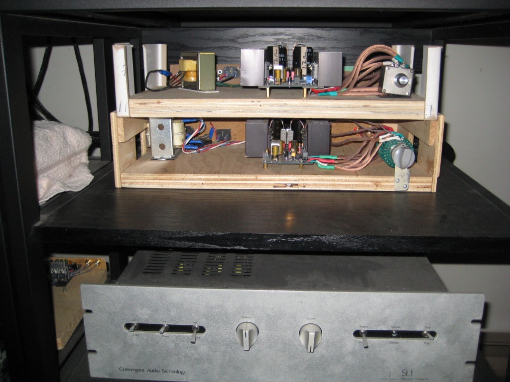

What ! only 3.3 ohm
Look mine at 1.2 ohm (top one) for 3 years 24h/7d (never stop it) 60 C
And you see (under) CAT(Convergent Audio Technology) collecting dust !
Don't ask me why
