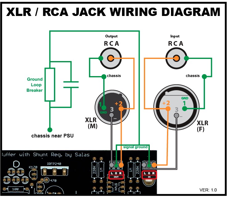

Hi everybody,
I got 2 boards from Teabag and I am thinking of a balanced version.
3 questions here:
1. Can I use the Vout terminal beside J2 to simultaneously power the IC-based volume control unit? It says 9-15Vdc is ok.
2. I did a diagram of my understanding of how to wire RCA-Balanced mode.(I am a visual person) Is that correct? Do I need to put a resistor somewhere or need a switch?
3. Is the signal ground connected to the ground loop breaker correct?
Thanks for the help! ;)

diyAudio Chief Moderator
Joined 2002
1. Yes, but the IC volume controller's consumption must either be low enough thus negligible, or account for it as extra loading in the positive PSU section's CCS setting. So to end up with same extra shunted current in both rails sections.
2. Looks good to me for XLR but for the RCA there must also be direct connection between its barrel and signal ground first because there is no return path now except through the breaker.
3. When for XLR only, yes.
Thanks Salas for the quick reply.
The IC based volume control needs only +/- 22mA.
I think the value is insignificant...?
I will make a wire connection from RCA barrel to signal ground.
Joined 2002
22mA extra loading will not starve the shunt regs, far from that, but better use 8.2R 5W CCS setting resistors in the shunt PSU sections to compensate against the extra loading so to have about the same spare current as other builders with 10R but with no extra loads.
Yes, first connect signal return to the RCA barrels, then break it to chassis. The RCAs must be insulated to chassis so to route as you like.
