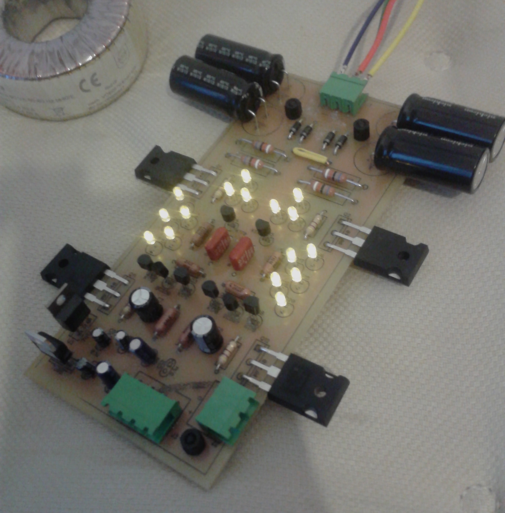

Current seems to be ok: 0,0626 vs 0,0594 that means a 5% difference.
IRF9240 and 240 closer to the rectifiers are pretty warm, I can take my fingers on them but they are definitely hotter than the other two.
Final voltages are stable at 10.21 va 10.15 that means a 0,5% difference.
PS: I love yellow leds used here :)
All readings OK on this home etched guy. You could use small individual sinks for the warmer MOSFETS. They are big devices that can support a bit of extra weight. Those two are having more than 10V across that the output ones have if the transformer is 15-0-15VAC
P.S. Watch your power on/down system sequence as I see no relay in your build. What are those extra TO-220s for? Some post step down regulators for another circuit?
