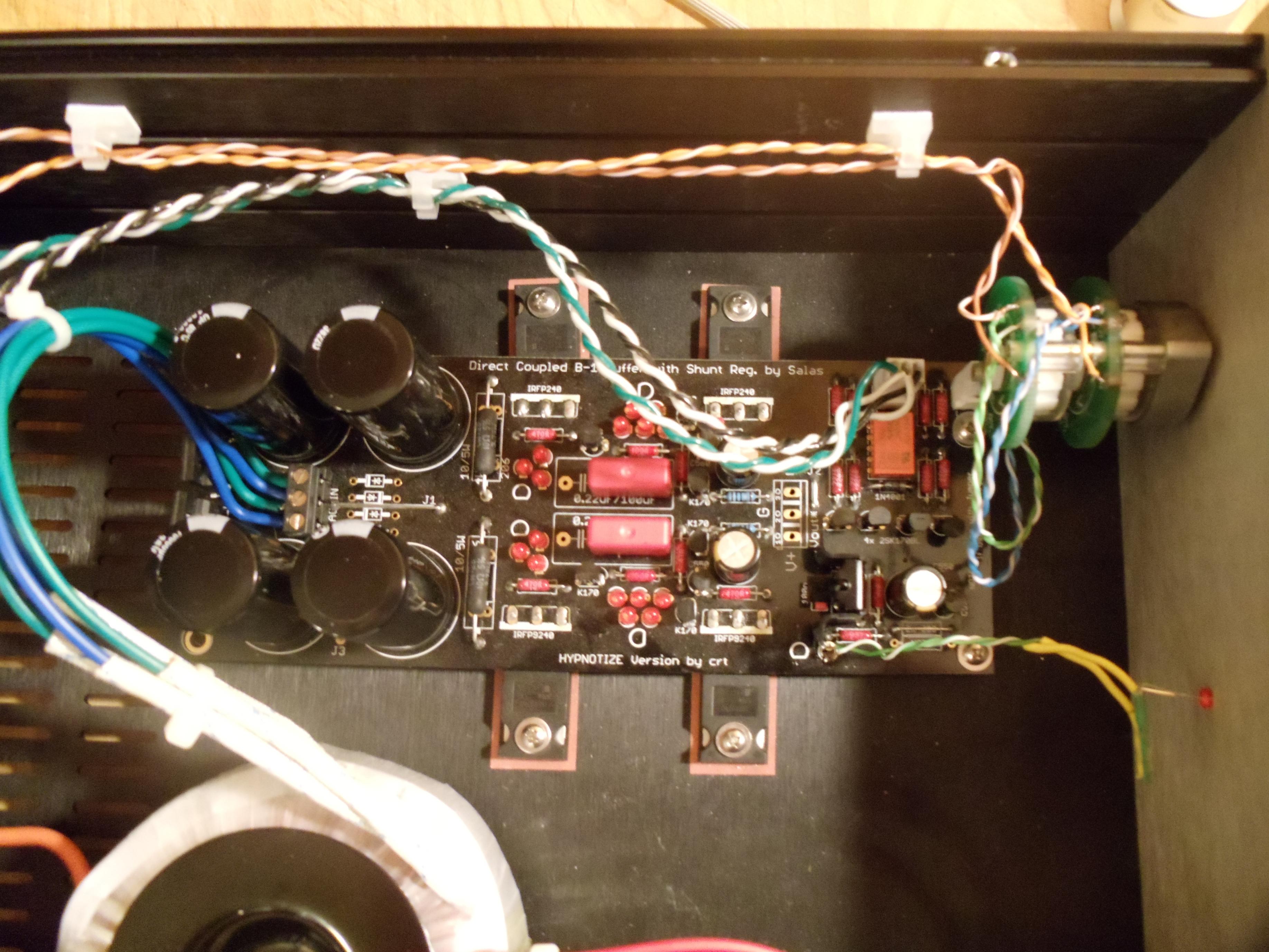

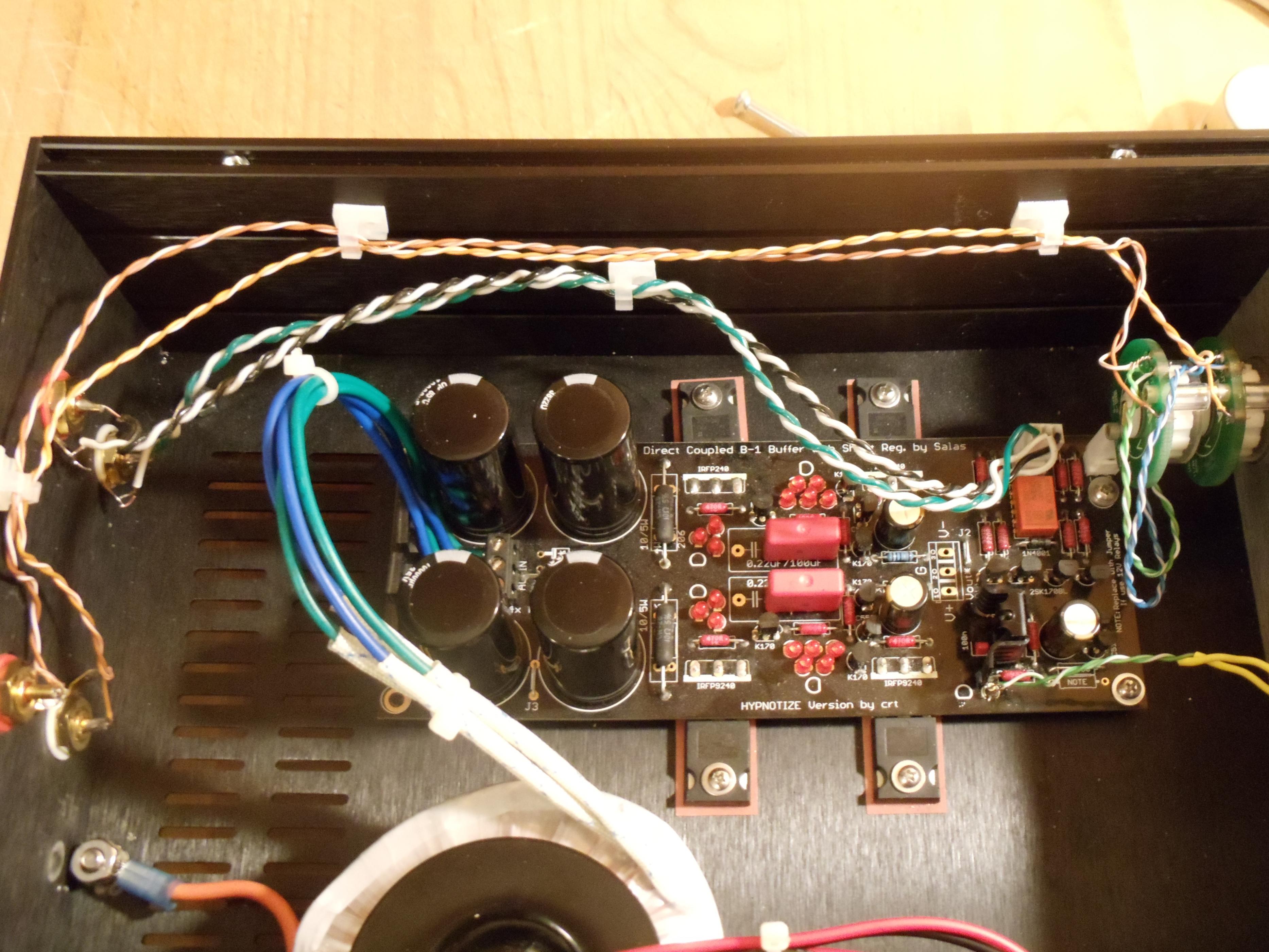

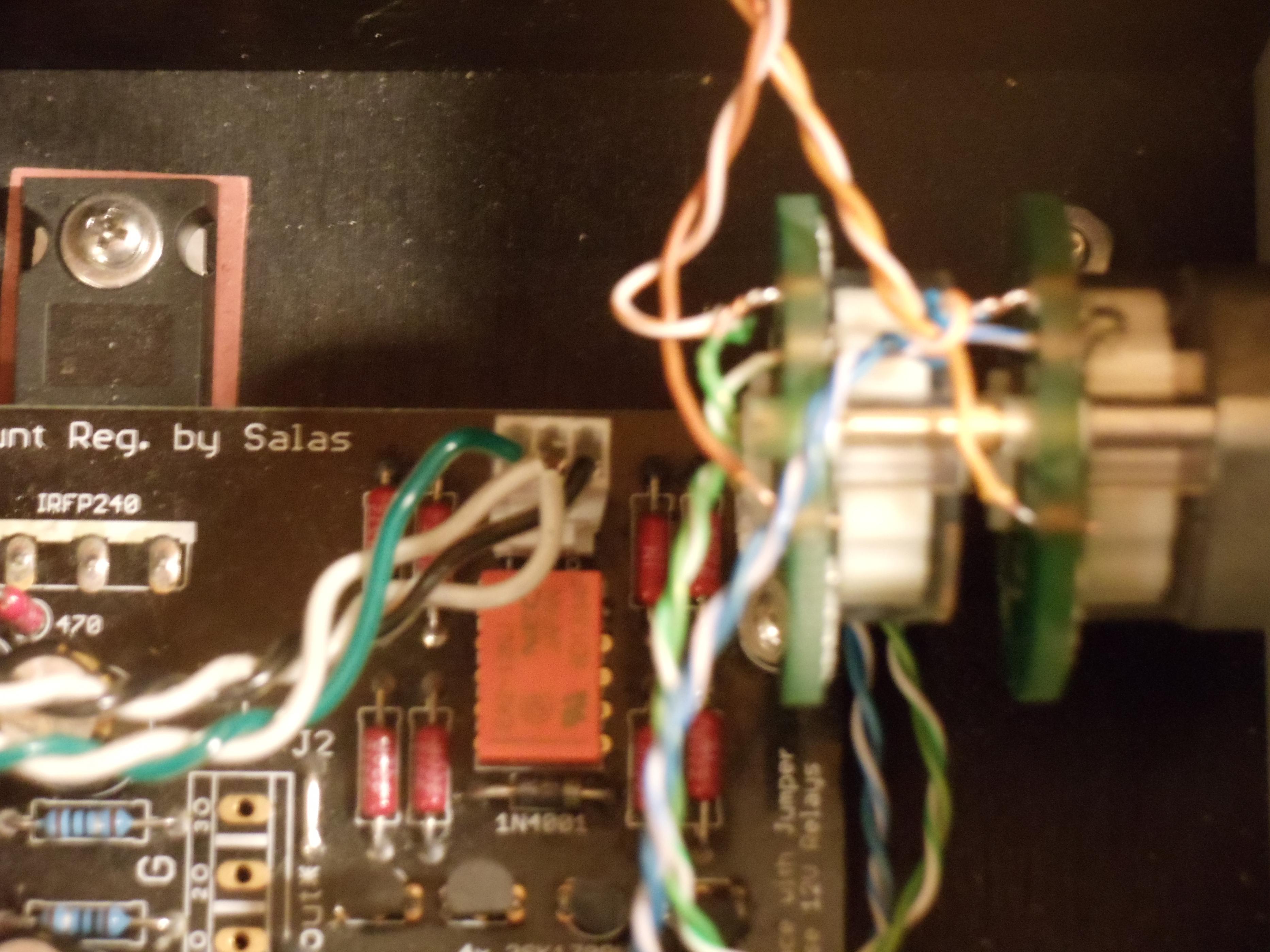

I can't see anything obvious from your pictures. In mine there is a delay of approx 12 seconds after switching on before the relay clicks. Your voltages seem a little on the low side, i'd need to check but if i remember correctly mine were just over 10V. That could be the reason but others here are better placed to judge that. What voltage does your transformer produce?
The regulator output voltages are very dependent on Idss of the jFET and the Vf of the LEDs.
The Buffer does not care what the voltage tolerance is. 10V+-3V will work.
The relay diode voltage tells you, that DCB1 does not have voltage telling the relay to turn ON.
Check the 7812 for voltage on it's input and output. Don't short it ! use other traces where a slipped probe will not cause a short.
If the regulator is OK, then we need to investigate the transistors that turn ON the relay.
7812 input voltage = 10.00v
output voltage = 8.75v
That's too low. Should be as high as across any main filter capacitor at a level of AC secondary times 1.20 to 1.35. Check if all diodes are alright or the 7812 itself is faulty. Check AC input level on the Tx connector. Wiring there should be reading 2xsecondaries ACV nominal across the edges.
