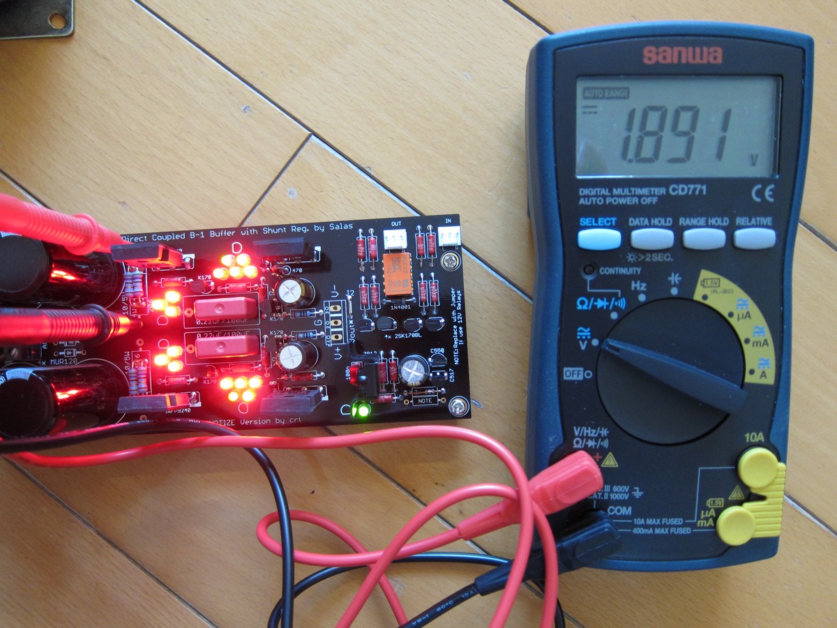

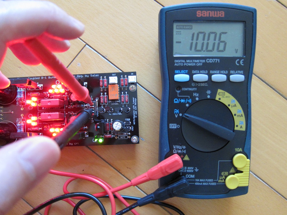

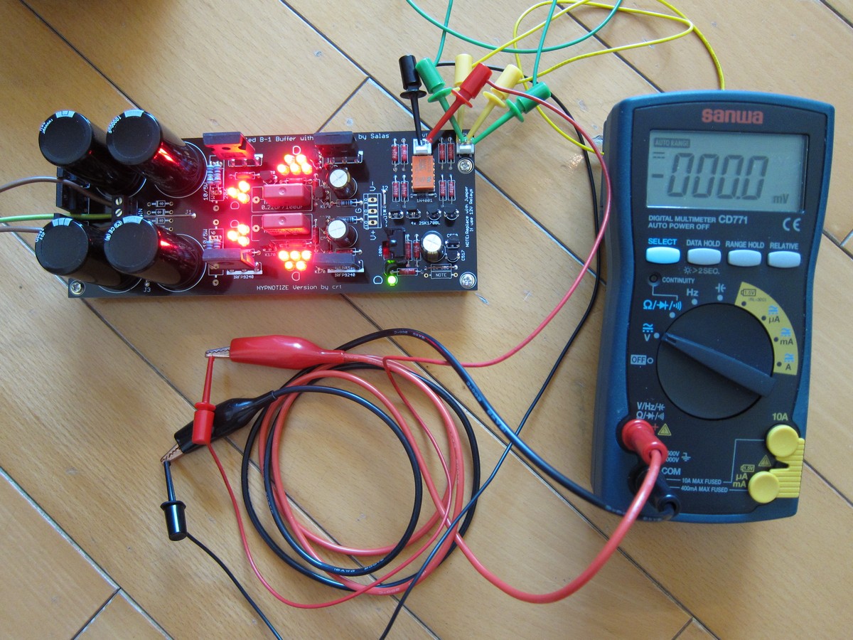

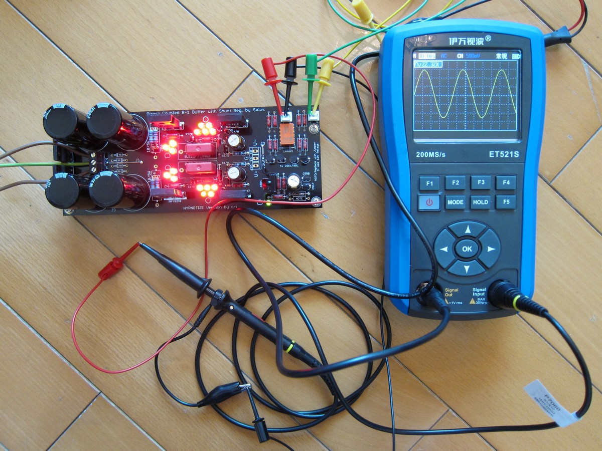

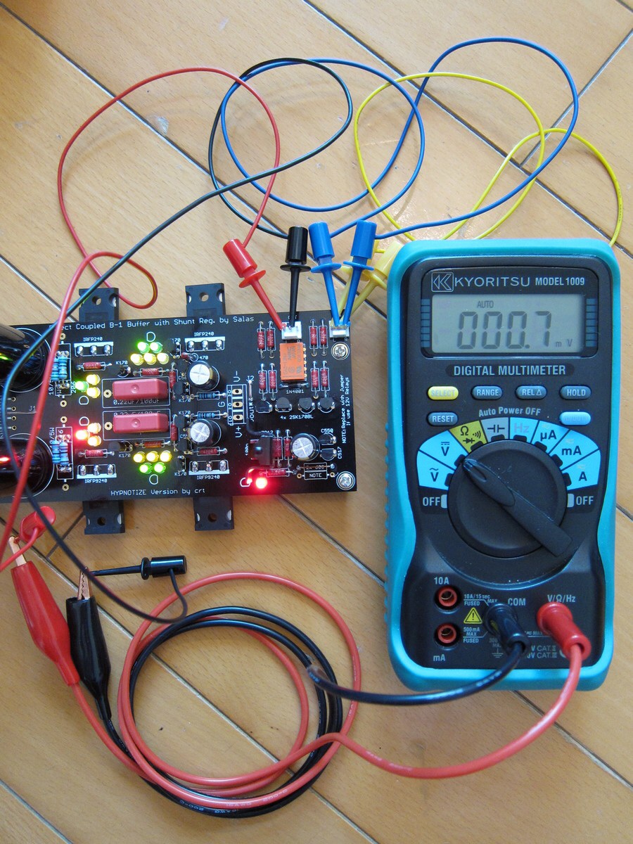

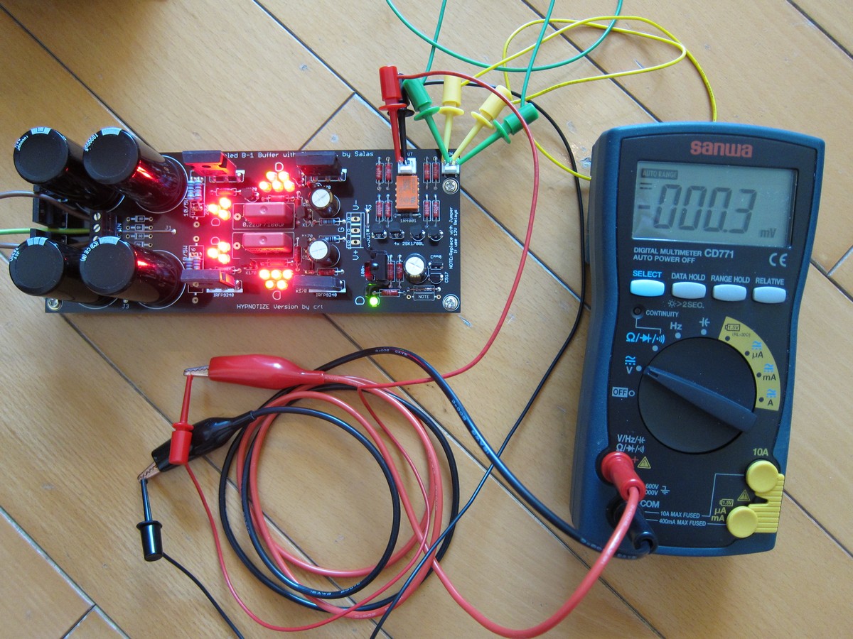

Well, I’m the seller than Myint64 refers :). Attached are pictures of the relevant DCB1:
Rails - +10.05V, -10.06V
Rset - 1.88V, 1.89V
Offset - -0.3mV, -0.0mV
Idss - 9.9mA (not shown in the pictures)
2 of the diagrams shows the output waveform at the 2 channels, when a 22kHz signal was injected at the input.
In terms of symmetry, offset and Idss, I believe this is a really nice DCB1 :D.

How much difference in ccs current positive and negative is ok?
Been lurking through all the pages, before building my version on perf board ( am I the only one?? ). The big Fets are mounted on a separate heatsink and are connected by short wires.
After building the psu and the shunt regulator, I tried it out, and tried to measure the noise on the output, which was not the greatest success, I need a better scope for measuring the noise of this thing!!! Only at the most sensitive setting I managed to see some. This is by far the quietest power supply I have ever seen on my bench.
Did the original schematic first, with two 47 Ohm resistors in parallel for the ccs, and paralleled three times 10 Ohm to them later.
Measuring the voltage over the ccs resistors showed 1.567 Volts on the positive reg, and only 1,361 Volts on the negative side. That means 536 mA positive, and 466 mA negative.
Question: how close should the current between the two sides be??
Other question: What difference does the 0.22 cap make? In my first version I forgot to solder it in, did that later but could not measure any improvement. Perhaps some folks with better equipment can measure a difference?
Thanks for making all this information available. I am a quite experienced repair guy, but building something is great fun too!!
diyAudio Chief Moderator
Joined 2002
You could minimize the difference in running current per polarity to 5% i.e. 25mA in your case for more symmetrical heat distribution. By trying towards 0.2V more total VF on the negative side's LEDS triplet. Or by paralleling a resistor to the negative side now setting ones, maybe 15 Ohm.
The 0.22uF is minimal, its essentially an HF filter to the voltage reference only. You are measuring a largely non noise filtered regulator right now.:D
But people preferred it like that in the context of a line level non voltage gain client circuit. To filter it, also judge subjectively for yourself, and to see less rails noise (mainly on 24bit FFT test gear) it takes 100-1000uF 25V electrolytics vs the 0.22uF films.

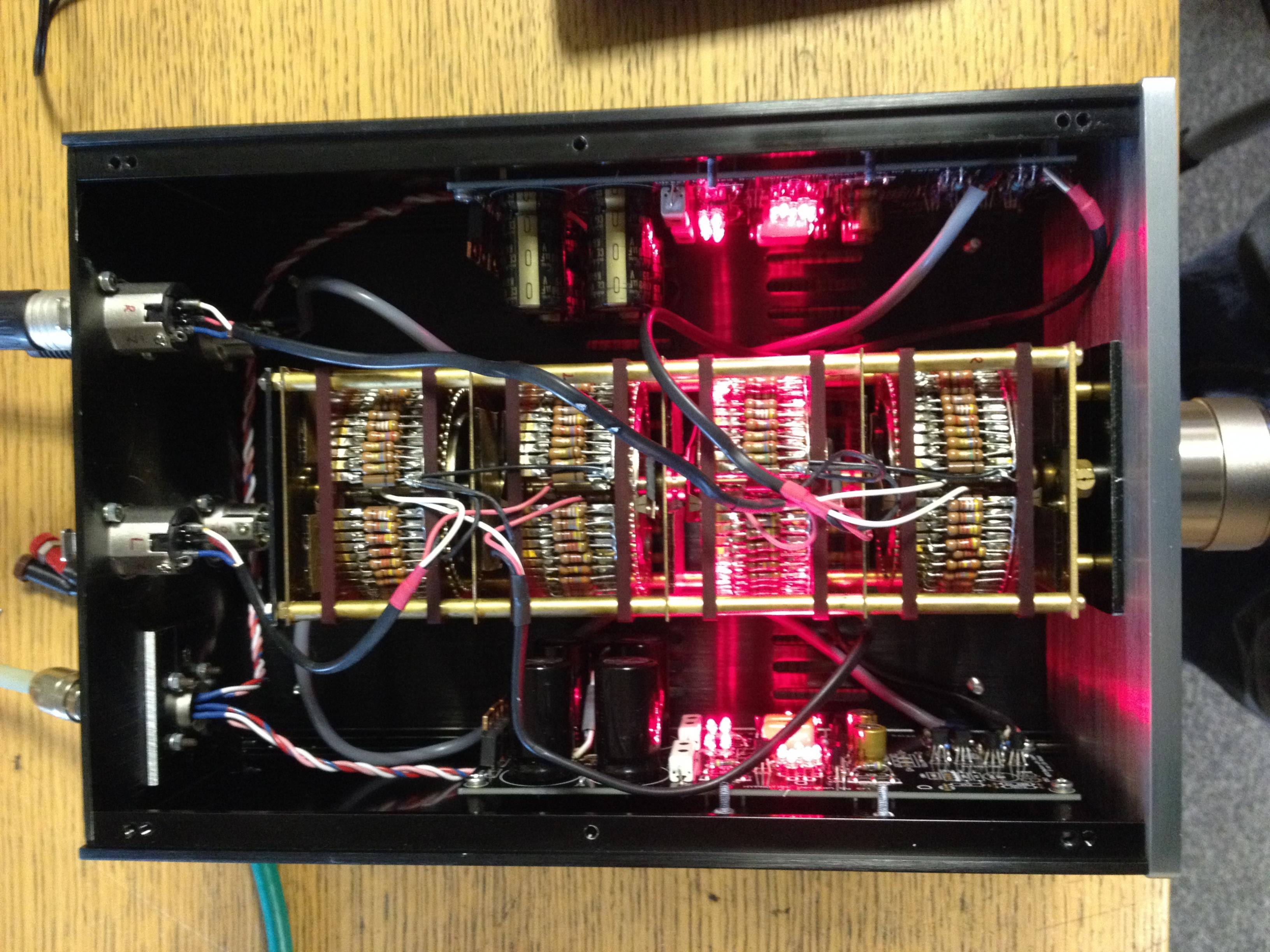

1 Amp maybe possible for you. If the sink will prove adequate that is. But mainly the transformer temperature is the question in your config. Got a picture so we can eyeball the sink & trafo size along the surely interesting matrix board build?
