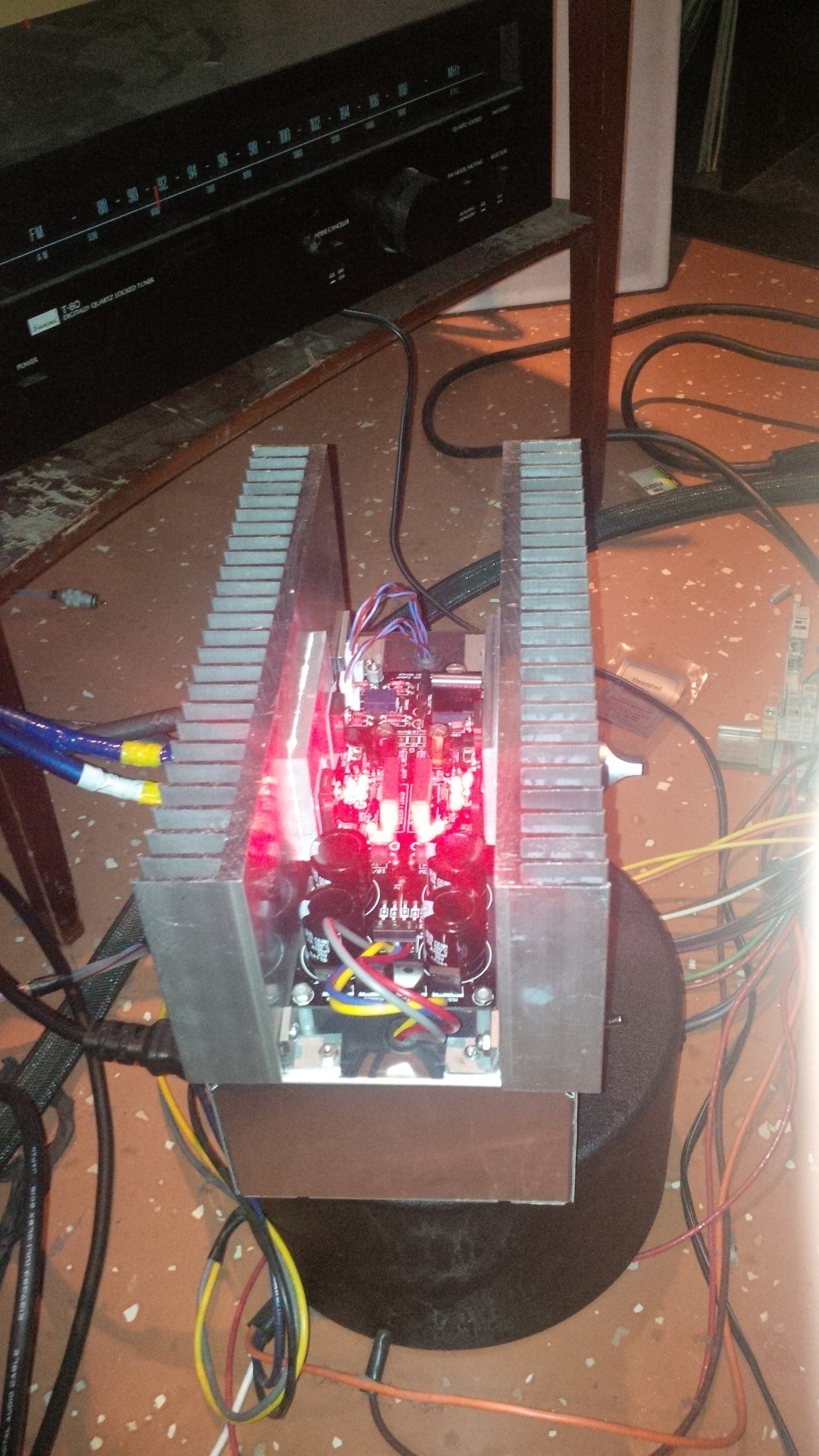

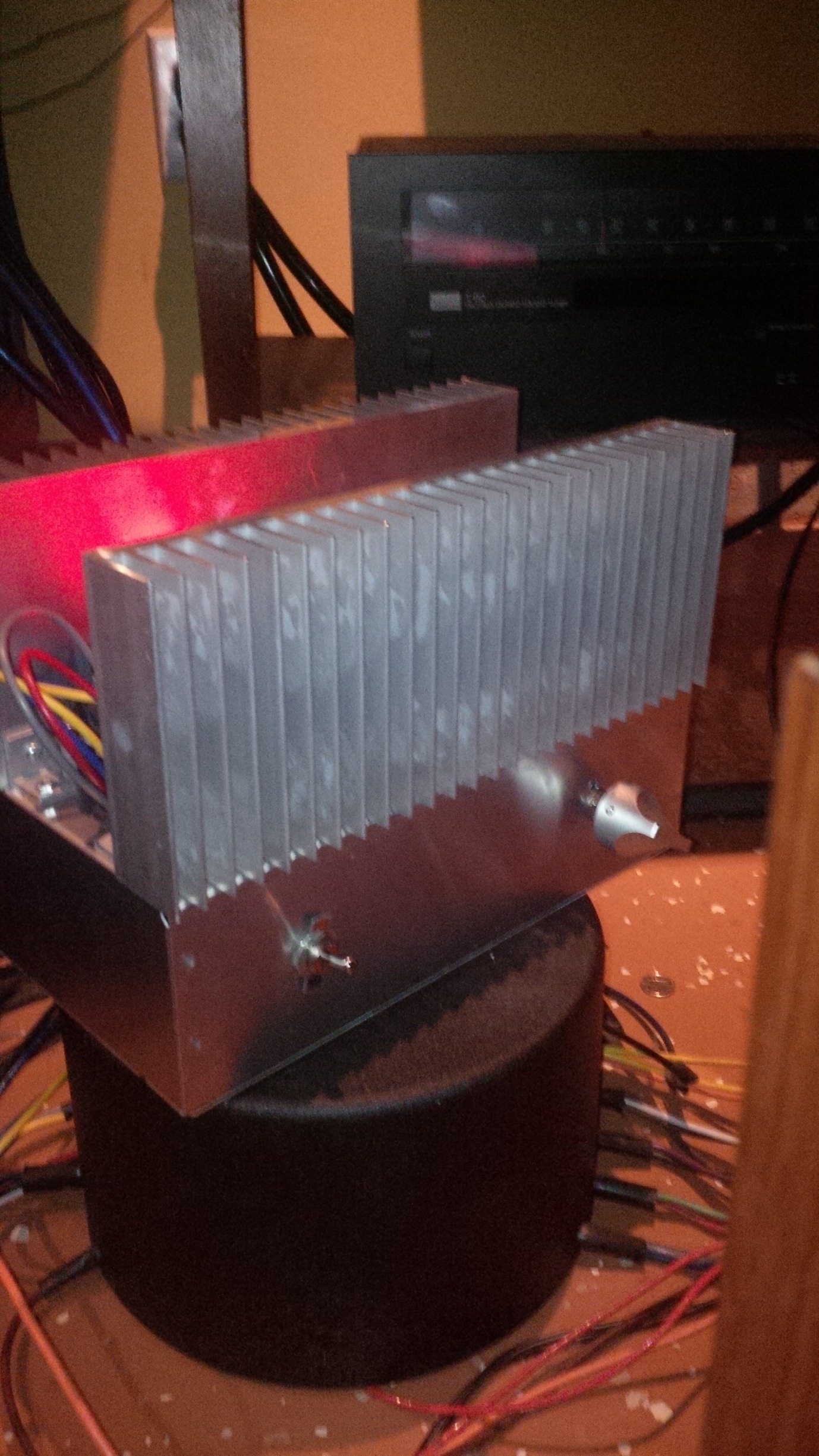

DCB1 working!!!!
My DCB1 works!!!
Here are some nekkid photos.
