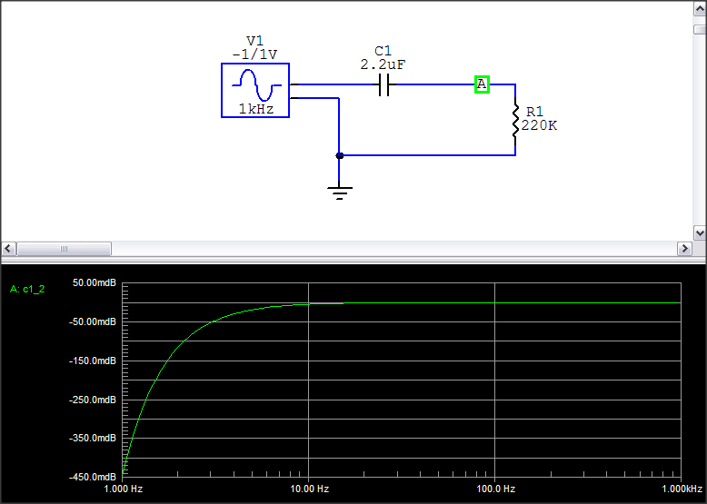

Niko do you mind explaining what does the 1M resistor do? Is it necessary?
Also, what would the above diagrams look for 220K input imp? I have also used 2,2uF ones
It references the cap for not holding charge to avoid thump noises.

I have settled on ~90ms as the RC for the DC blocking filter in my systems.
I have presented this many times and I get repeatedly told that I cannot possibly hear any difference in bass response with the filter set this low.
You are proposing 4u5F and 47k for an RC of >210ms which is more than an octave lower.
What do you find when using this frequency for your power amp roll off ?

My philosophyy is that the input filters must be used to define the passband.
Once I have done that, the internal roll-offs must allow that chosen passband to operate with as little interference as possible and the PSU must also allow that passband to operate.
If I change the input filters down by an octave, or more, I would have to change the amplifier and the PSU as well. Well I did and came up with my preferred input filter determined passband (that suited me and my system). But I would not then change the input filter alone. That corrupts the amplifier's ability to operate over the now wider passband.
Do you see the problem?
Suggesting to another that they adopt a >210ms filter may be anathema to the operation of his system.
I think the Member should progressively increase the passband of the DC blocking capacitor from a high value of around 10ms to determine when the amplifier+ filter no longer give improvements, as limited by the complex amplifier + PSU interactions.
Only then go out and buy expensive capacitors to match up with the values found.
Simply jumping to 2u2F//2u2F//0u1F is not a good way to arrive at a value for the DC blocking capacitor. It is possible that 0u68F works, or just as likely 1u8F, or any value. But the chances of 4u5F being correct for his amp are pretty low in my estimation.

What cap would you suggest as a starting point for my case (220k input at the amp)? Something around 0,33uF?
The 2,2uF was chosen arbitrarily because I happened to have some on my spare parts and because I read elsewhere that it is a nice overall player.
