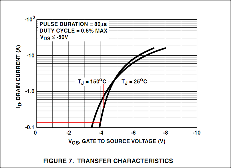

When you will have your 2X15+ Tx the CCS is going to top out for a given set resistor, so don't order anything projected Mills or alike yet. Evaluate target current as a whole with conventional quality ones first when with all final bits and pieces together. As you go higher current, VfLeds-Vgs which is Rset Vd goes progressively smaller too.

your previous Vdrop was 1.57V................... I have just boosted it a bit attaching 2 additional 12R @5W resistors on each rail bringing it to ~3,75R.

Now it is 1.41V & 1.39V.
That shows that the CCS is not a CCS. There is a fault with your regulator.

Andrew, that lower drop simply shows that his CCS MOSFET's Vgs is going up as he is setting his CCS higher while his 3 LEDS are at the same Vf total of as before. The 3 LEDS Vf minus Vgs is the actual voltage difference that the setting resistor refers to for defining the constant current. His CCS works normally. MOSFETS have a rising Vgs curve with current actually published in their datasheets as you know.

I am sure that his CCS MOSFET VDS for max ID sourcing is not at its stiffest region with his now transformer, still I am also sure that his VGS has gone up since he has set 0.37A than 0.16A he had been using before. If we quickly look up the IRFP9240's ID/VGS curve as it comes from a FAIRCHILD datasheet, although its a low resolution region we are interested at and no MOSFET sample is the same to its next, his loss of voltage drop across his setting resistor complies with the VGS increase scale I have traced out in red lines.
