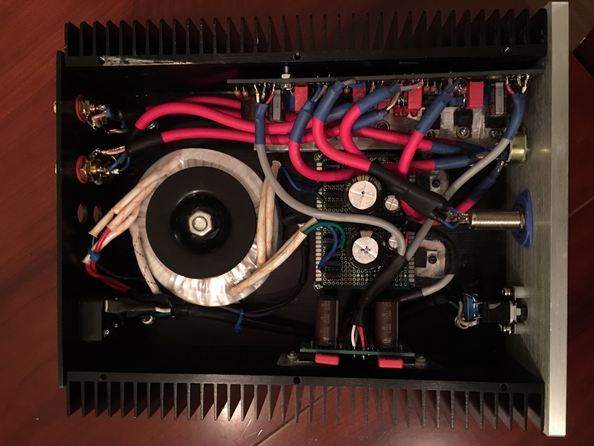

Updated my DCG3 (maybe I should call it DCG5) to more gain (2K/R6), changed R3 to 178R to keep J3 at 4-5mA and added a 20K pot (had 10K before) and all Mogami 2549 internal wiring.
Hopefully, more gain will please the F5. Sounds good so far but I need more time.

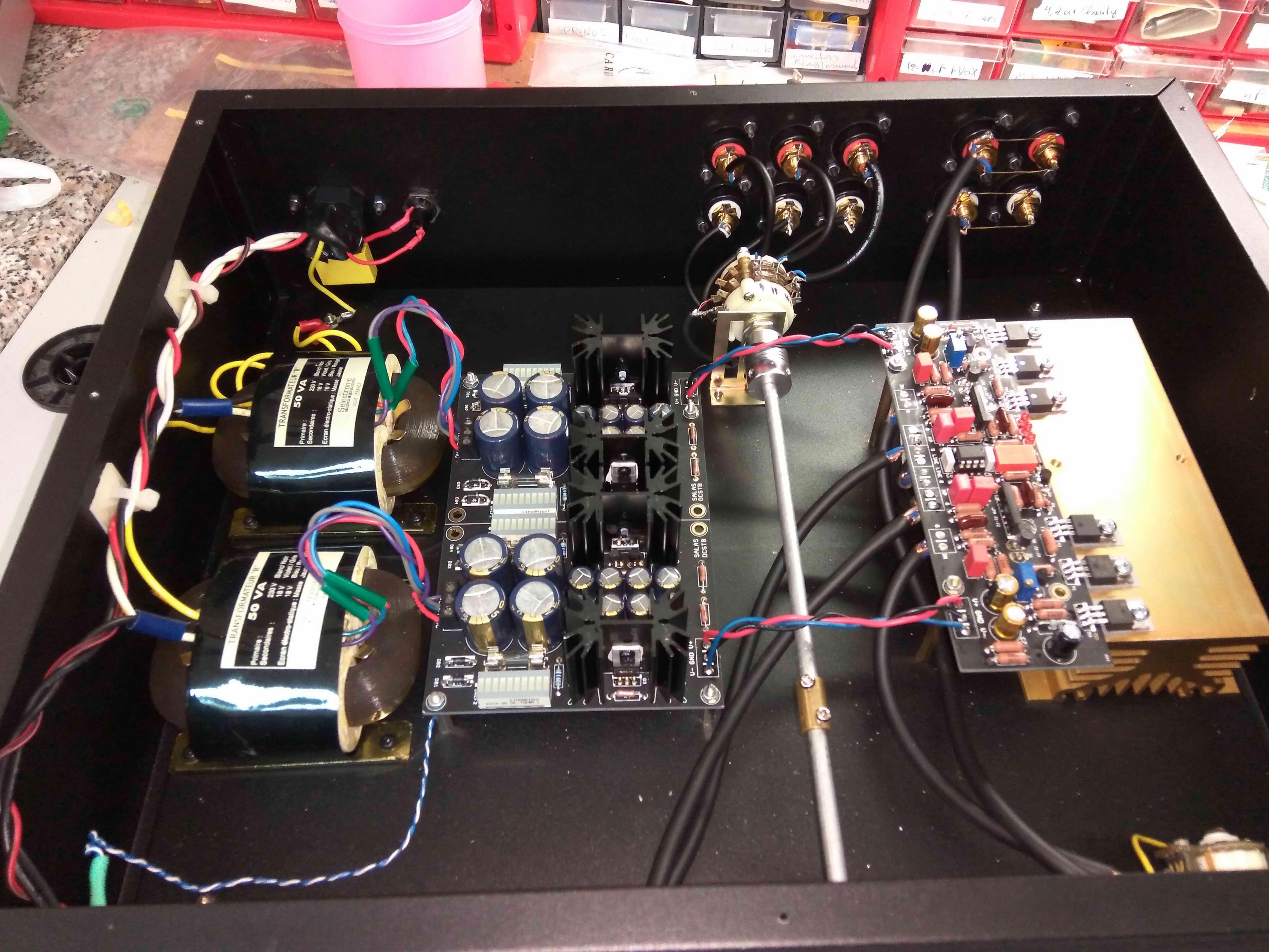

Also, changed the input selector and cabling - I switch ground and phase for each input - in order to minimize loop area, and make Andrew happy!

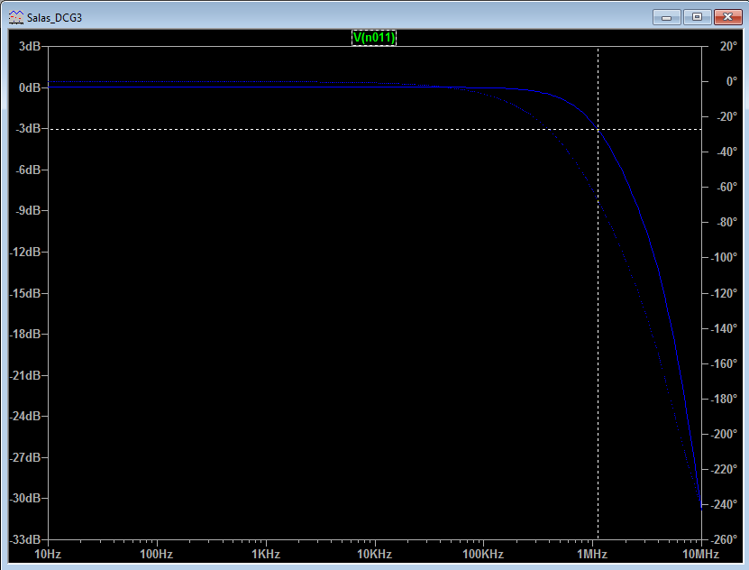

I don't see you are facing anywhere near a narrowed bandwidth problem yet with 10K pot & 10K//1nF load in simulation (that is why I was asking your measured figures so to plug them in). Here is its closed loop at half your pot for your 2x gain loaded with your 6m//6m cable runs to the amps. Phase margin with your specifics simulates as 94 degrees in open loop also. All well.

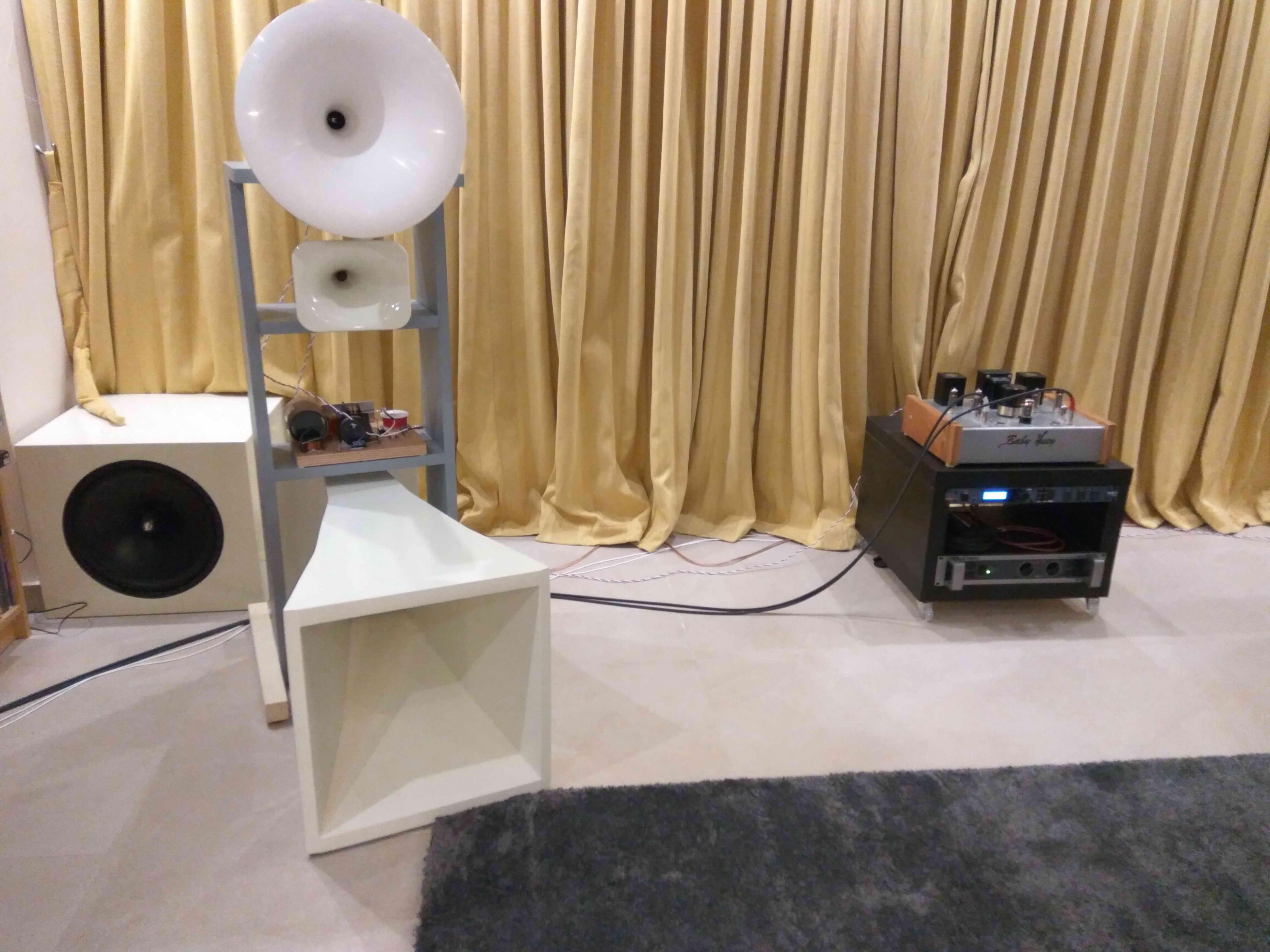

The speakers new arrangement looks nice. How is it going with the new HF horn and overhauled crossover, and how do you like the DCG3 after, what, a couple of months maybe?

You could also try verify that bandwidth with a 10K load resistor across two output cables in parallel on a channel and the scope's probe attached at that resistor. Feeding 1V 1kHz sinewave from the generator when the pot is split equally for worst case response and your 2x gain gives 1V output again. Wind the frequency up until you read 0.71V. For finding your practical -3dB supersonic reach.
