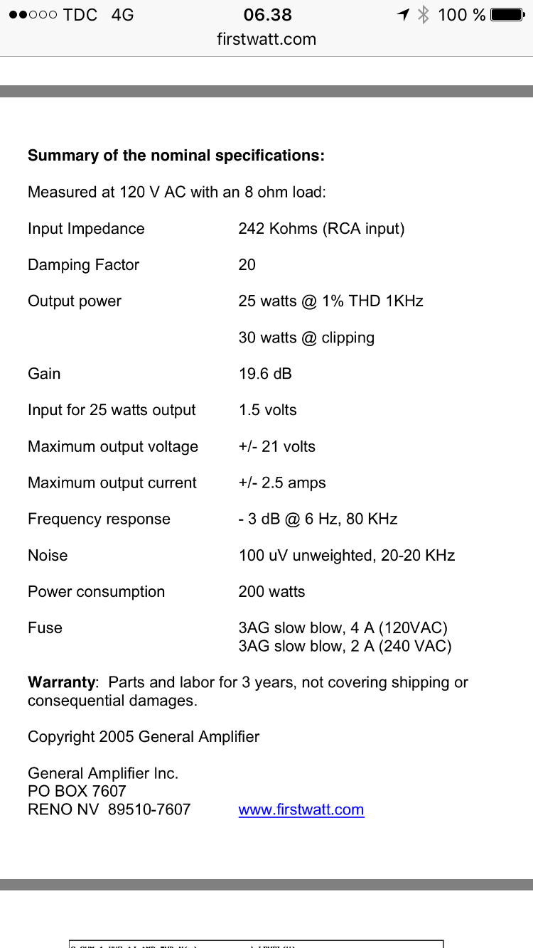

Also, after DCG3 I found my self digging in Pass forums for power amps. Never say never! I only need 15 watts class A with enormus input sensitivity and preferably balanced interface. Any suggestions? Or should we wait for something?
If you look at my signature, You see i am coocking on
a scaled down Alephj.
Gives around 15w and is sensitiv at input.
I have attached a picture with datasheet from original
Alephj.
