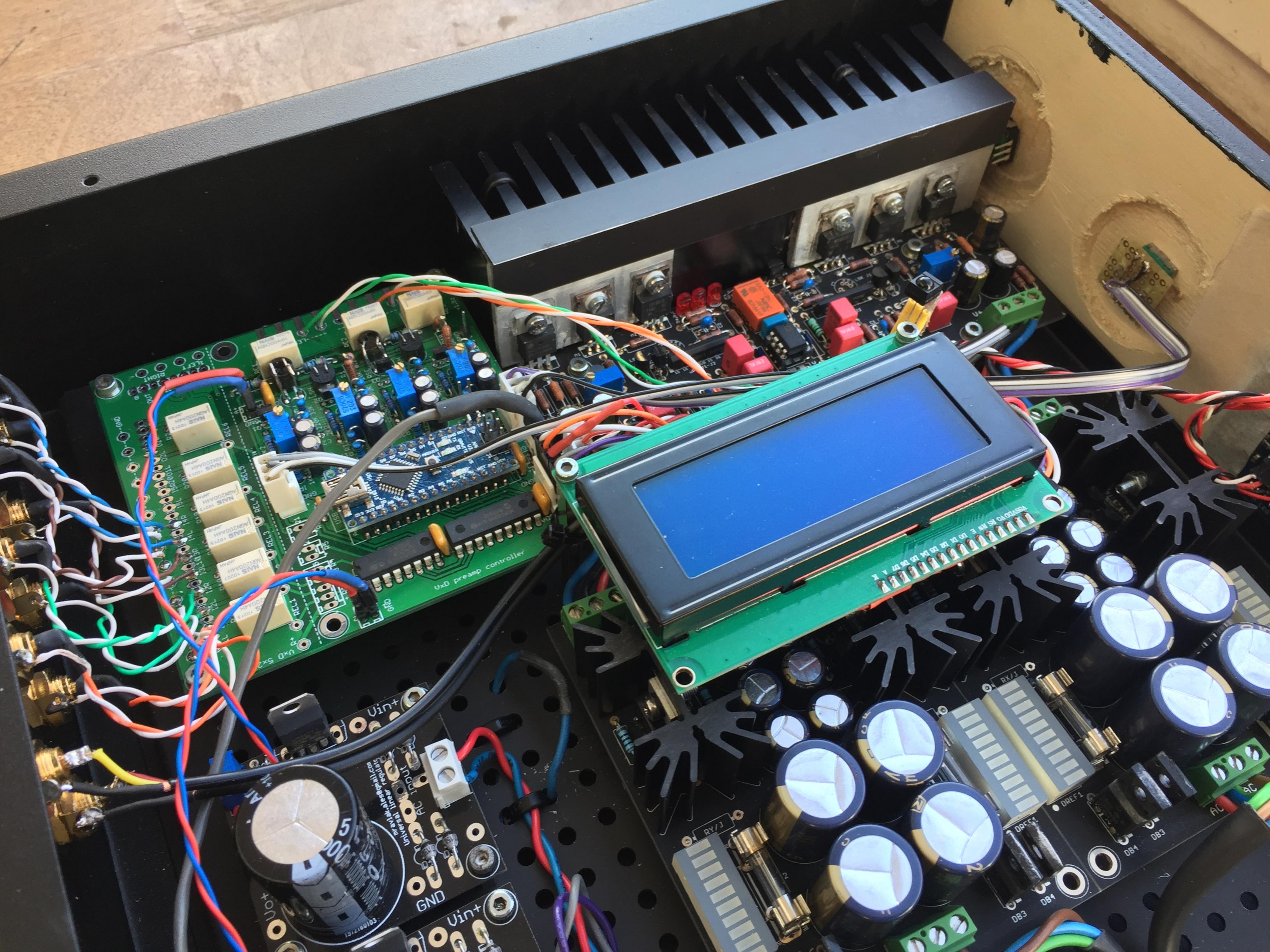

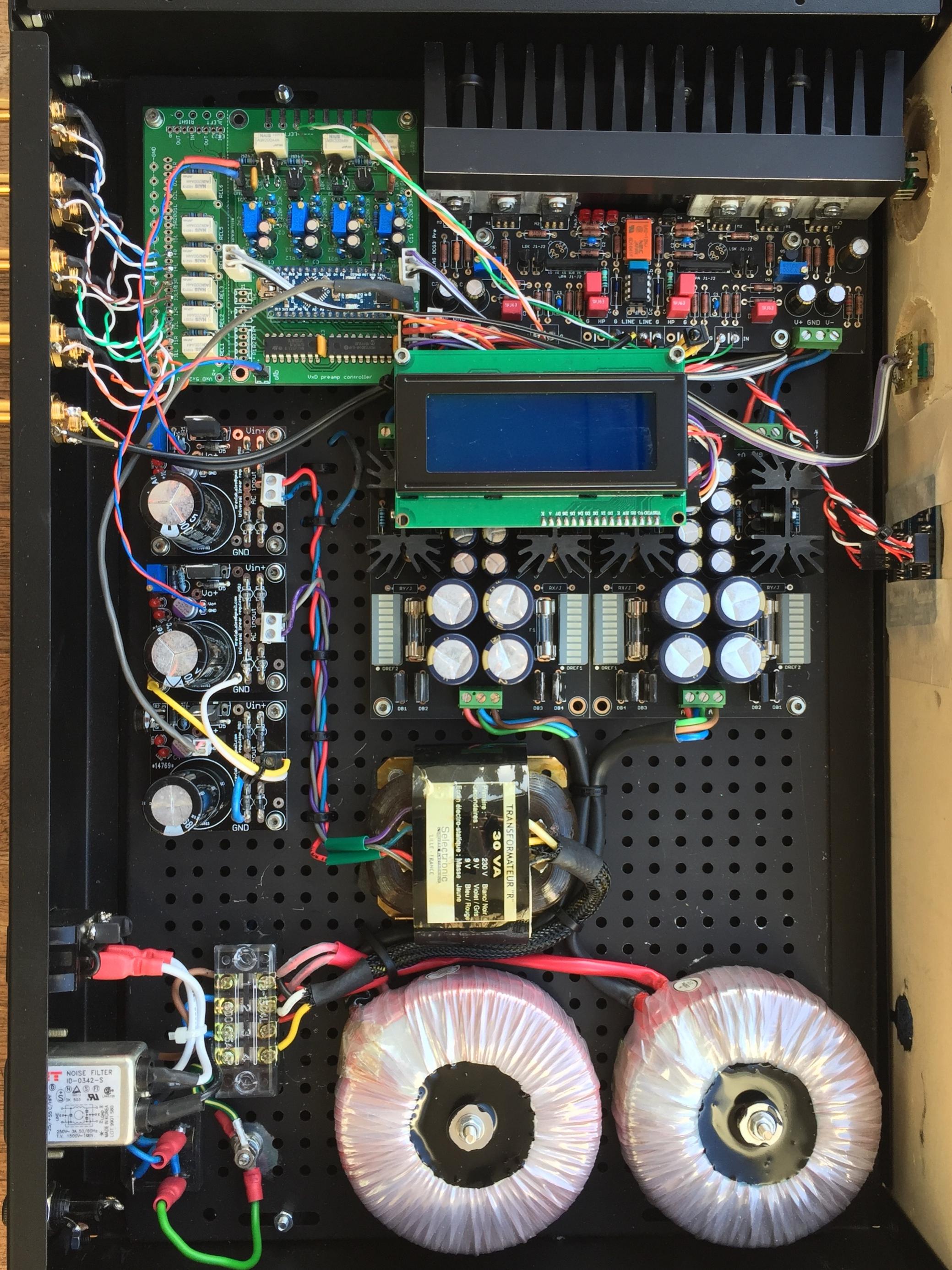

Just finished my DCG3 DCSTB preamp, it has the arduino nano all-in-one LDR volume controller from the Group Buy section. Very happy with. It currently drives my Pass aleph J clone with more dynamics than the DCB1.
I used 130mA bias (10R) and gain 2. I will remove the arduino setup LCD after a while.
Thanks Salas and TeaBag for the offering.

With the op-amp applied or before?Nice to see a "cousin" DCG3 build for my -still in progress- build! I'm also using the same LDR Controller in my project.
I measured the offsets, and it's hovering around 0,1...1,2mV in both channels. So no problems there.
My offset measurements were with the op-amp in place.
After the device running for about 45 min with the lid on the temps were 50 C on the DCG3 sink and 57 C on the PS sinks (the middle ones). I think I'm going to change the R10s to 10 ohm, since it seems to be giving around 130 mA bias with other users (Asanden). That should be plenty I think.
