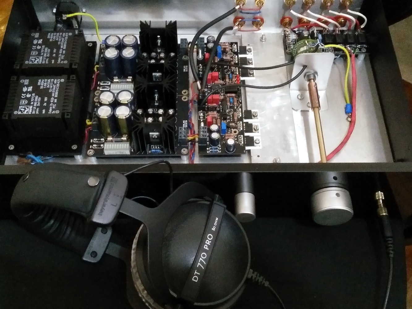

I just checked my own for offset and bias after it spent a couple of months on the rack. Everything measures the same as in the day it was put together. All components look pristine also. (I opened it anyway with the excuse to add an X2 interference suppression capacitor across the mains power switch that I was left without any back then and I had later bought some as it is generally good practice to have one there).

Jesper, I see you are cooking with ZenMod everyday...
Well... Yes you see, this little amp. I am cooking on now i find very interessting.
I need to learn more about powersupplies, as i learned from youre dcg3 + dcstb that it gives something special to my ears with dualpsus.
So right now, i have been fiddeling with Duncans psudesigner... Just to test different setups.
I am waiting for some raw PCB, so second AlephJ Mimi can sing :eguitar::note::note:
diyAudio Chief Moderator
Joined 2002
Nice headphones. I see you have started a collection!
I was missing an affordable closed back that had to have big over the ear cups and velour pads. Not many such models around so I went with that Beyer 770 studio classic.
For notable isolation vs my open ones plus capable of fun sounds and long time comfort like for when watching movies on Kodi.
Not musically accurate they are, thinned out upper mids response with a a high treble peak too. More like bright than harsh.
But with big deep bass in counterpoint and a generally clean from ringing response plus conveying some good sense of imaging which is rare in closed backs.
Still made in Germany by the way. Noticeably cheaper plastics and heavier stiffer cable than any comparably priced AKG though.

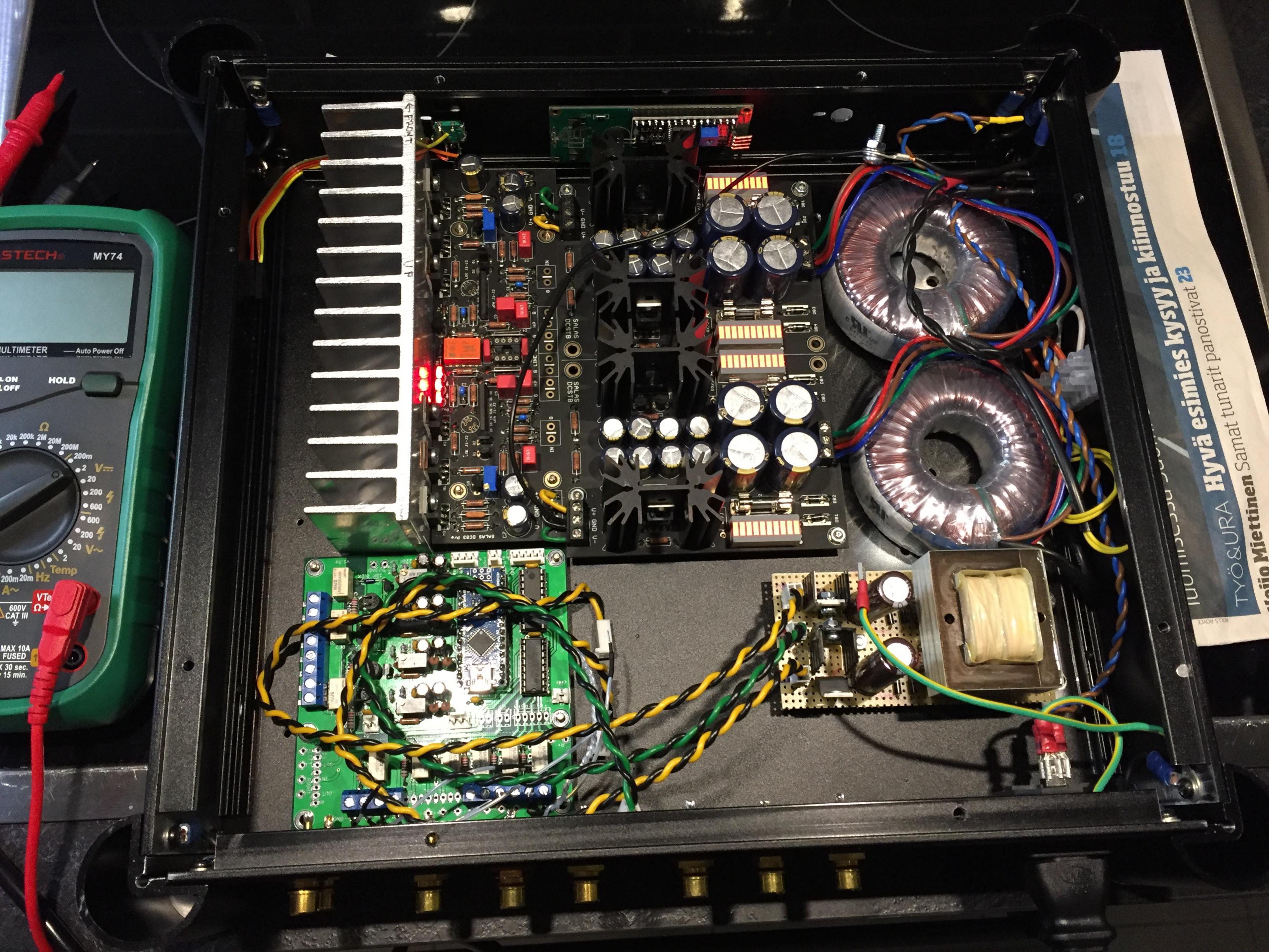

Last night I got my DCG3 board energised and everything seemed to be ok. I chose 7,5 ohm bias resistors from Tea's set and my bias was running at 170mA after 20 min test drive. Heatsinks were 43 C on the DCG3 and 47 C on the DCSTB after 20 min without top cover.
