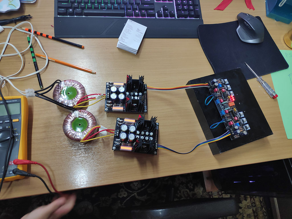

Its alive....
Another DCG3 is alive....
diyAudio Chief Moderator
Joined 2002
The manual says that "all outputs should measure below +/-18V. Mine measures V->G= 17,4 V / G>V+=25,1V on one board and V+>G=17,2V / G>V-=25,1V on the other board. Any suggestions what I can have messed up...?
I am using two 18+18V transformers.
25.1V at a psu section output indicates a fault. Seems like the rectified dc level passes straight through. You could be having wrong or broken same position TO-92 small transistors in those two high output sections. Maybe PNP and NPN swapped over. Check the types and their places closely first.
