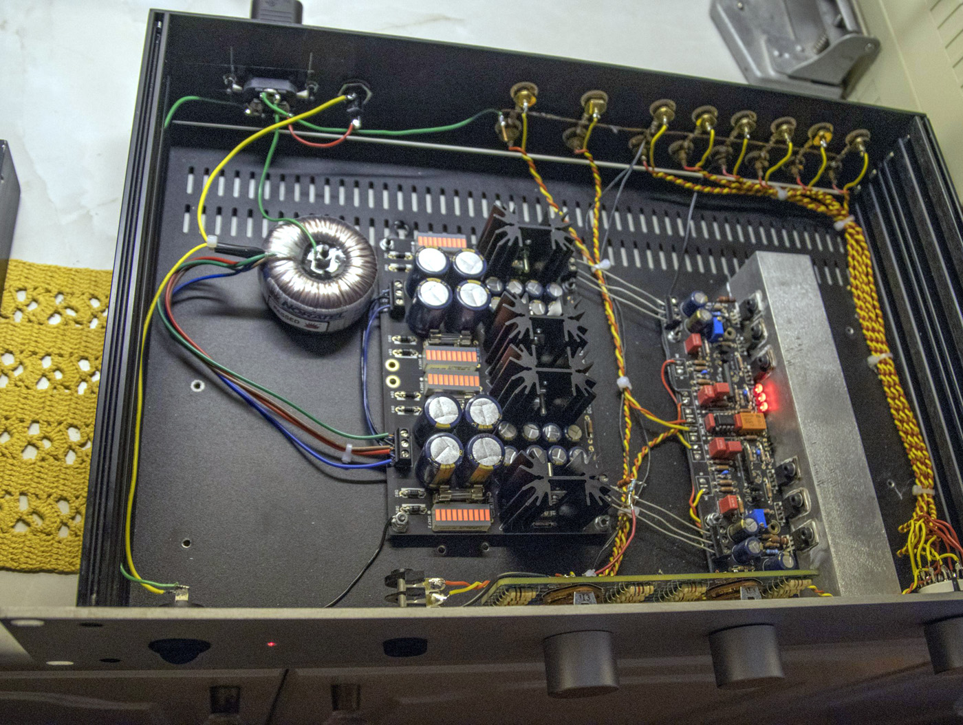

Case ventilation has been frequently mentioned especially since we are fond of using high heat generating shunt regs.
Should there be more openings at the bottom or at the top? Or is there some desired ratio that promotes airflow from bottom to top much like a chimney?
If we were to attach the shunt transistors to the case bottom then heat would be transferred from them to the case mostly by conduction and the case would then radiate to the outside air, so would ventilation really help here? On the other hand using DCSTB style sinks heat is transferred by radiation and convection so ventilation should be necessary.
Also does the distortion and THD strata of the DCG3 change significantly as the case gets really hot?
Any thoughts?

Few holes around the place of bottom attached MOSFETS with corresponding holes at the top augments convection for the direct to chassis method with shunts. In DCSTB's case few holes directly above the board level sinks helps. The THD spectra changes a little with heat but not much.

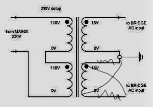

Having a look at my layout to decide what chassis to order and can’t decide if I should use both of these transformers, or if I should save space by using a single one. What would I sacrifice by going single?

I don't know, never listened to a DCG3 build other than with twin trafos. To use single trafo for two diode bridge inputs it should have four sets of secondaries i.e. double the now secondary wires. Else, a mono shared supply must be also used. DCSTB board is V grooved in the middle to can be easily separated in mono bipolar units.

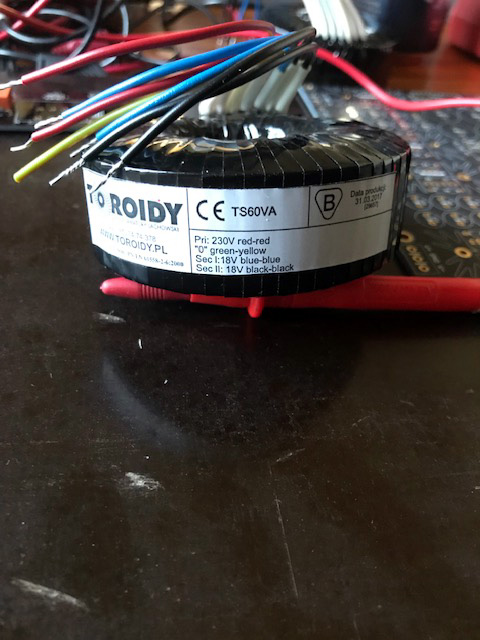

The reason for mixing things up in the first place was that I'm not sure how to connect the 18+18 leads from the transformers. On my power amp that's quite forward. (Or at least I thought so until now... :scratch1:)
230V is red+red and earth is green/yellow, but 18V sec1 is blue-blue and 18V sec2 is black-black. At Toroidys homepage I can't find anything but simple drawings, not saying anything about how the 18+18 go together. They look so neatly arranged that I guess that the blue and the black next to each other go together. But guessing worries me a bit...
Anyone who has used these transformers for the DCSTB and can tell how they should be connected? Or am I making things more complicated than they are?
