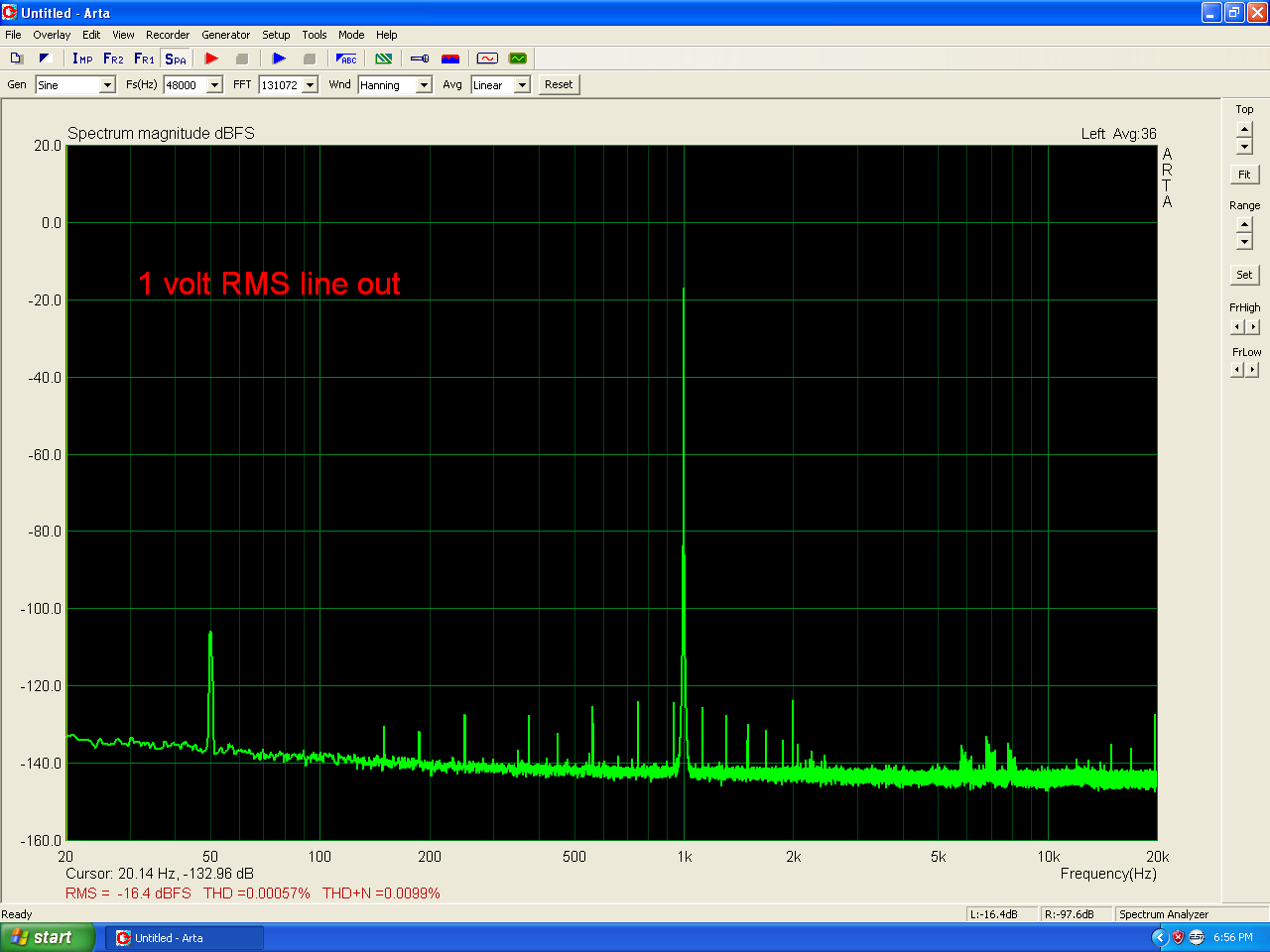

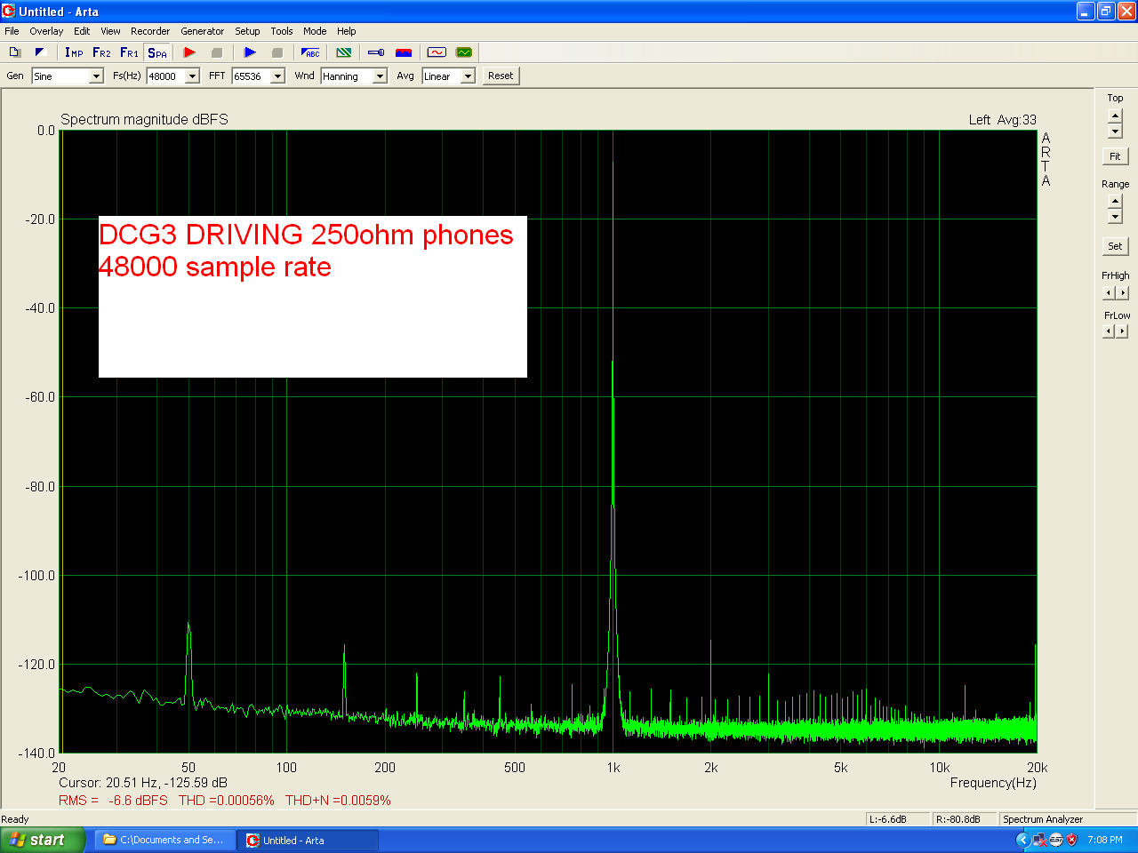

Thanks, so it's a soundcard loop test not DCG3 measurements.

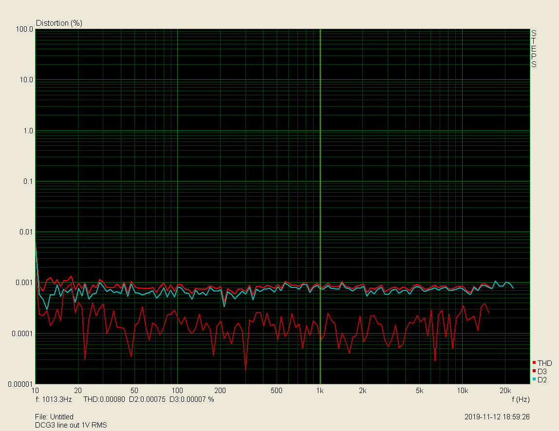

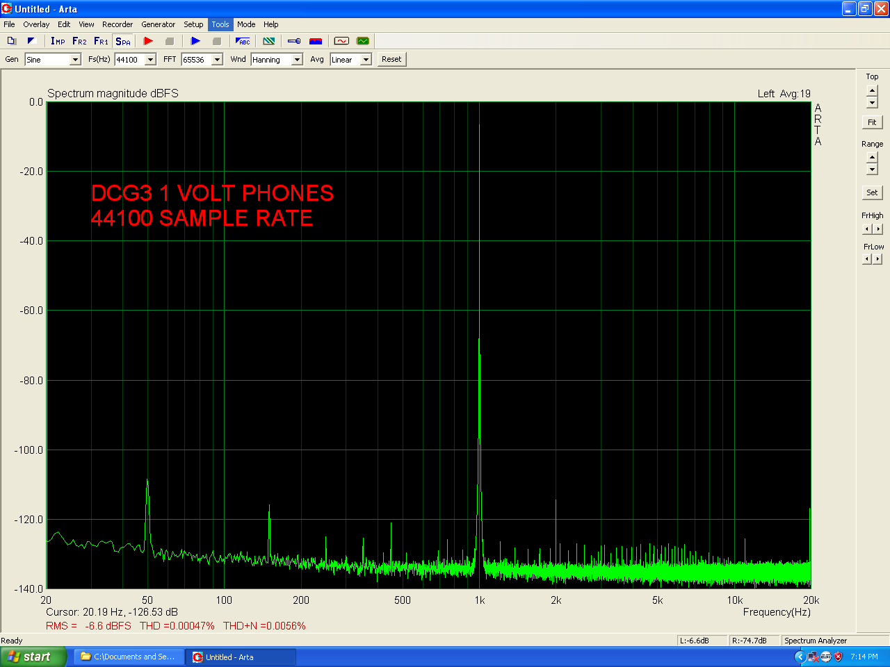

I have a DCG3 new measurement, the best(lower THD) up to now.
I will post latter.
Was to show what just a bit loose contact between cheap RCA cables and the back of a jack adapter can do. Obvious 50Hz hum appears. Crosstalk curve also substantially worsens most probably due to capacitive coupling between low quality bonded together thin stereo cables.
My own DCG3 measurements are in post #1 from when I was prototyping it in an aluminum makeshift "open L chassis" on the bench. The audio interface was running on its native drivers with a Win XP notebook then.

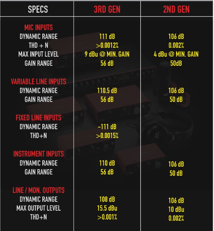

I see gen 3 of Focusrite Scarlett has improved spec compare to gen 2. It may be a good candidate for guys who is looking for such device. I'll try to get one soon and I'll report results from new loop test and from my second DCG3 witch I'm adjusting right now.
I can't go better as my soundcard is a PCI one.
OK a PCI card has harmonic noise spikes but your DCG3's THD looks fine. It would have registered better without the spikes but we get the picture. Especially nice looking is the THD VS Frequency sweep being flat all the way to 20kHz and dominated by second H at 200 OHM load.
Not bad for a home studio interface box. Scarlett 2ndGen has flat 1/F to 20Hz is a nice thing I have seen in your and other's posts. My old EMU tracker box starts rising from 80Hz down which surely registers in THD+N numbers although it is still very competent in other areas.
If 3rd Gen proves any better for helping in measurements do let us know.

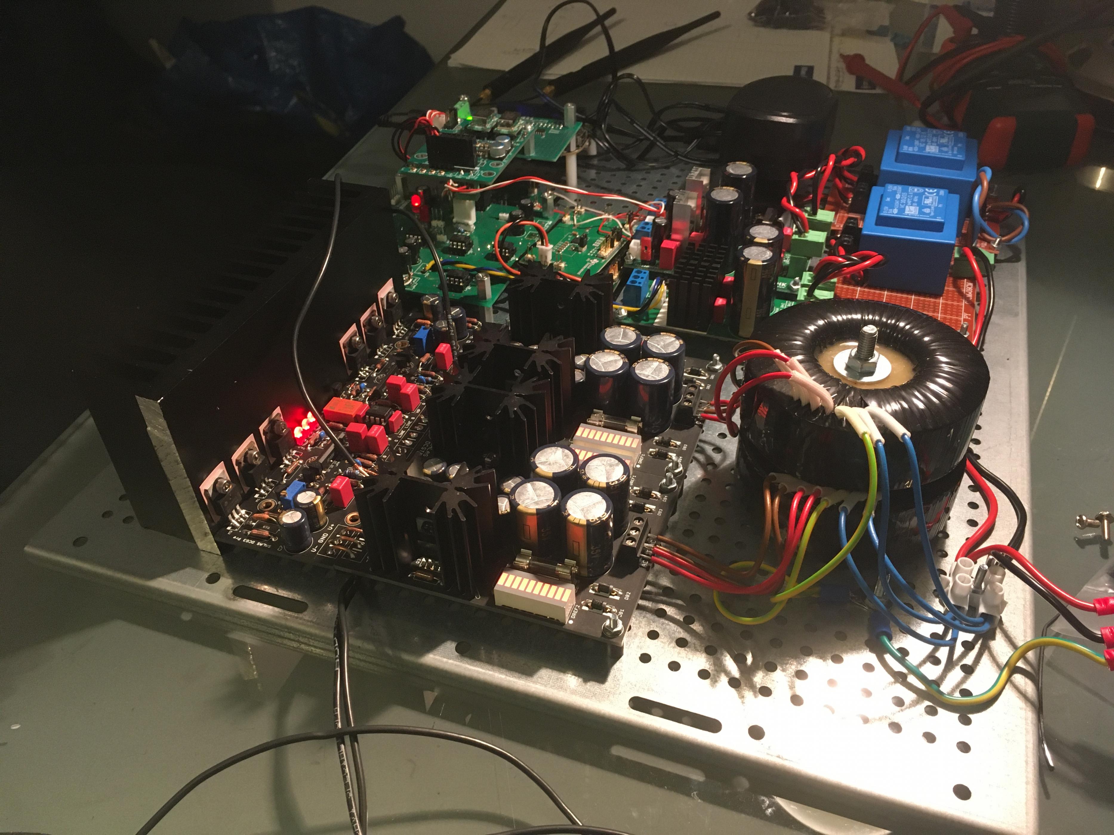

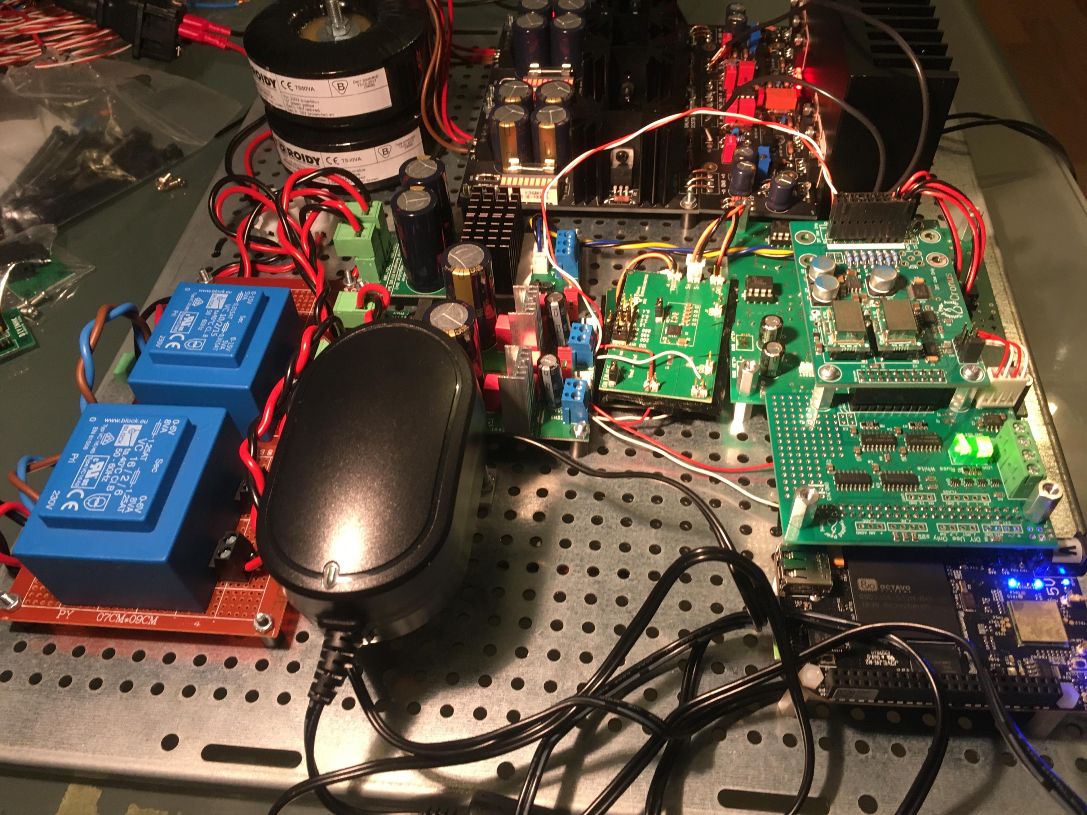

Having joined already the Group-Buy organized by Tea end of 2016 I finally managed to get the build into a stage where I can actually listen to it (see attached pictures)...
Yes this took a while (the main obstacle in the end was buying a sink and the necessary tools for cutting it to size and drilling and tapping the holes for the transistors). What also helped to motivate me was buying a beyerdynamic T1.2 without having any proper headphone out in the house.
Went with 3X gain and the high bias (7.5R) simply because the sink is more than big enough. Everything worked just fine after firing it up and it was easy to adjust the offset before putting the opamp in place.
This is used as kind of a digital pre-amp / network streamer:
Next up: Putting it into a proper case (currently drawing the necessary front and back panel cut-outs) and more listening. Additionally trying the alternative relay wiring (I have turn-off pops so I usually remove headphones before powering down) as well as the Q1 / Q2 mod. Will post an update of the final stage hopefully soon.

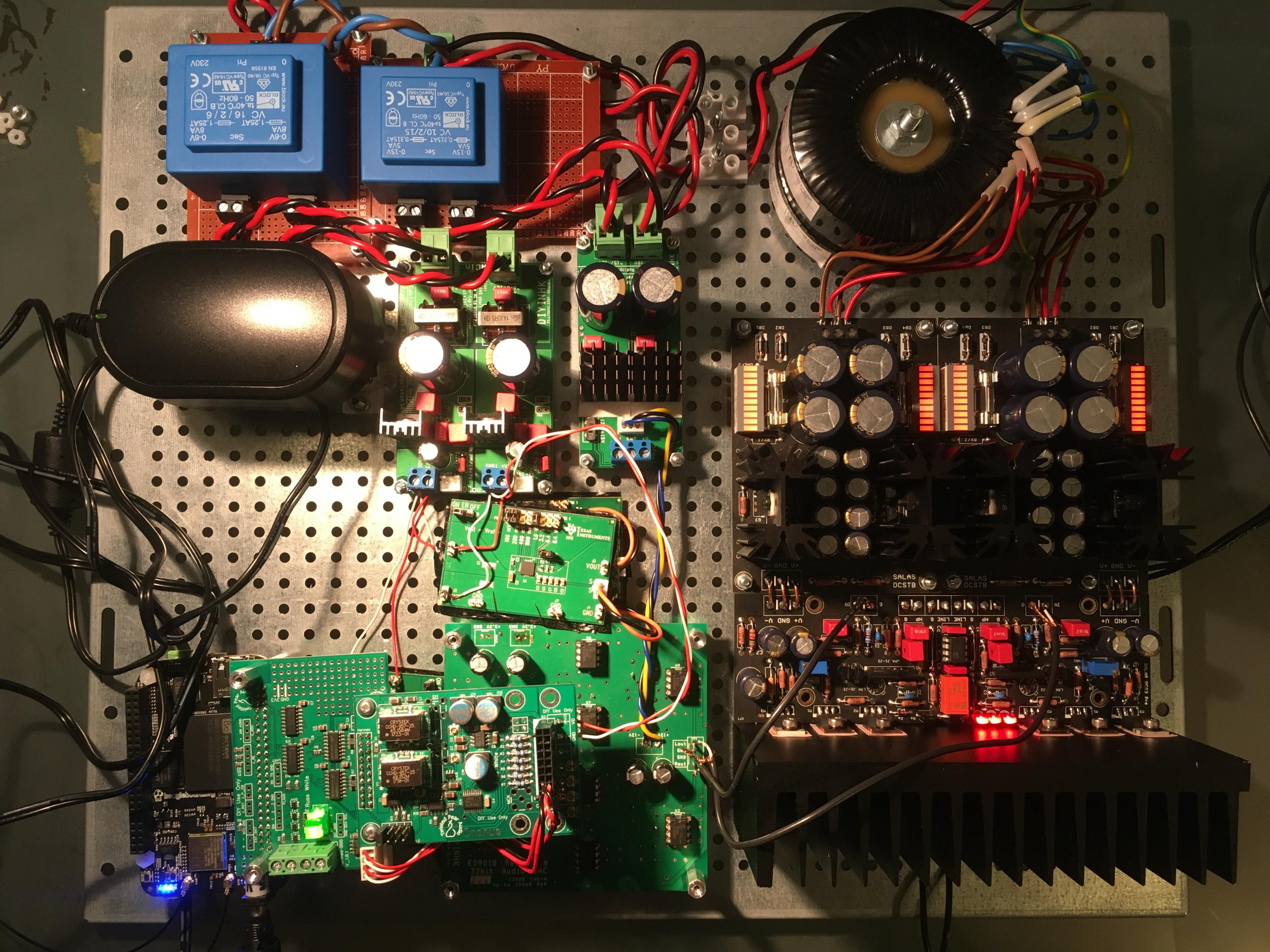

- Beaglebone Black Wireless with TPA Cronus re-clocker is used as a streaming device (see Support for Botic Linux driver).
- DAC is a diyinhk ES9018 (Build thread for Diyinhk ES9018 DAC on Ebay) that is also used (via isolated I2C control from BBBW) as digital volume control. This DAC was actually my first DIY project.
- DAC single ended output is directly connected to DCG3 input (R2 replaced with 33K to lower the input impedance since no pot is connected)
- Line out feeds a Pass M2 clone (Official M2 schematic) where boards, transformers and output transistors have been again supplied by Tea-Bag
