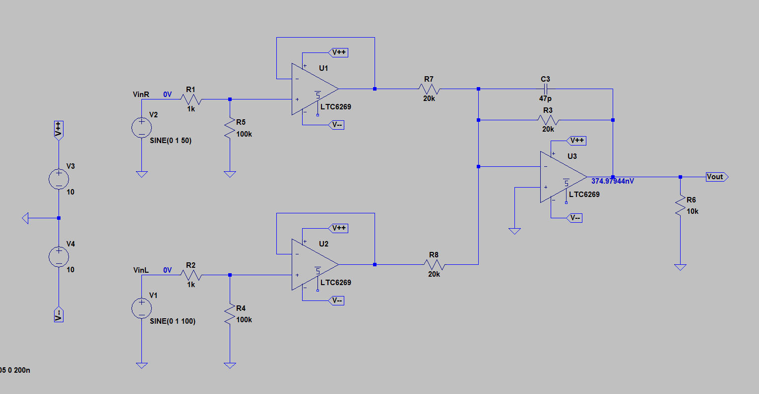

The final summer presents a 10k impedance to the two Buffers.
The two Buffers each present a 5k impedance to the two Sources.
Why don't you just use the summer connected to the two Sources?
The virtual ground at the -IN node prevents virtually all crosstalk. It's why the summer channel is used for proper summing of two signals.
It is very difficult for me to visualize the concept without an image. Would you care to redraw my sch Andrew ?

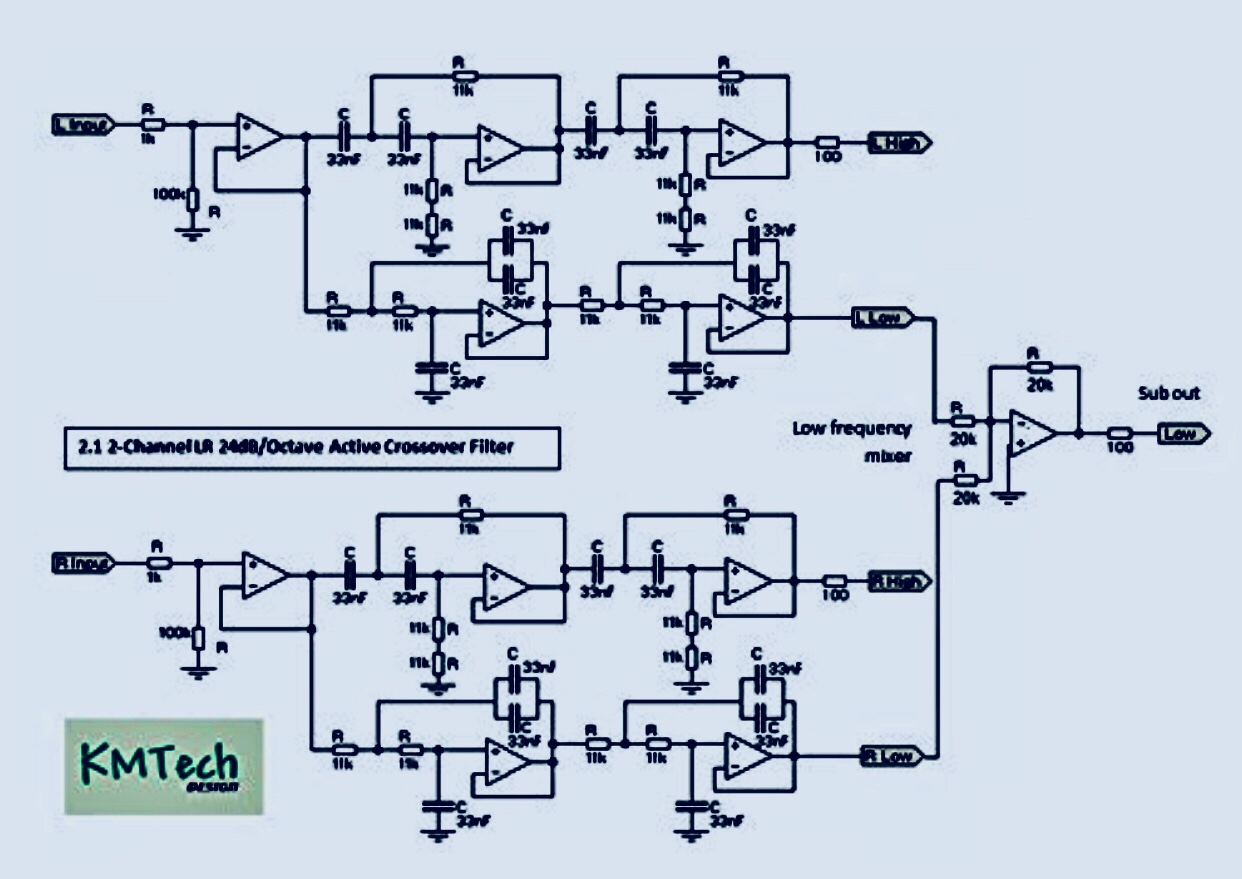

the summer channels adds the two signals and send the sum to the next stage.In your case you mix both bass channels and have not stereo at all.
I need normal stereo operation and also a sub output with high input inpedance.
I use the same outputs from the DCG3 to feed the power amps and also the self powered mono sub.
The two inputs to the summer channel are still separate for normal stereo duty.
The summer is a true ADD function.
But prior to the summer the two channels are still independent.
Same as I’m planed. One output is going to my F5T power amp and second to that circuit which is connected to the sub. It has 100k input impedance and input buffer. Yes, my sub is getting a sum of L and R. Do I miss anything. View attachment 659128
I revised the sch so to have 100k input impedance.
I am using LME4971 opamps.... are these unity gain stable with -Vin connected to the output ?
The Buffers are not adding anything.
I would try a plug board version with just the summer and see how the stereo performs when you make the two connections to the summer.
R3 = 20k will give an output that is 2times the inputs.
if you have a high proportion of bass (at any time) in the stereo signal then you may overload the summer and the next stage. Try reducing R3 to 10k.

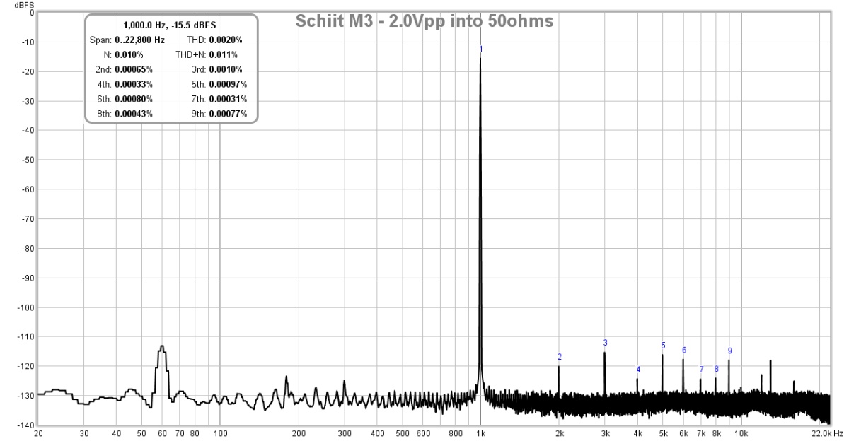

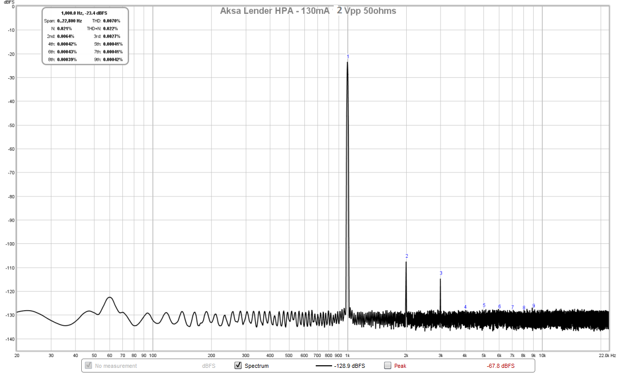

Sorry for continuing this OT subject but I feel compelled to share my findings of the M3 vs other designs around here. Note that for me, the DCG3 costs more than M3, at least my build did including PSU and such. The fact the your M3 costs more than your DCG3 might be part of the reason it doesn't sound as good. The M3 is a marvelous piece of engineering and amazing value for $99 retail. Made in the USA too. It is very powerful too - over a watt capable into 30 ohms (but the distortion looks crazy at such drive levels). I use it to compare to my Class A amps and although it sounds very good - in direct AB comparisons, level matched, and with high resolution sources, and material, there is a very audible difference.
The sound stage and depth of the stereo image is not as good as a low or zero global feedback Class A amp. If one only had the M3, one might be very happy, but comparing it with some of the world class design around here - no comparison. The measurements show that the M3 is a very low THD amp, yes. But what is the harmonic profile like? It is dominant third order with lots of higher order stuff that is odd order. Although very low, they are contributing to an unnatural sound. Having lots of global feedback to drive the THD low also makes the sound stage and sense of engagement not as good. Don't get me wrong - for $99 it is an unbelievable value and one wonders how it is possible to make a discrete DC coupled CFA amp for that much.
Here is the FFT for 2.0Vpp into 50ohms for the M3:
Compare that to the DCG3, or Aksa Lender HPA and you will see the beauty of SE Class A designs. Here is FFT of Aksa Lender HPA at same condition (3.5x higher THD but look at the profile is now H2 dominant with only some H3 and nothing else):
