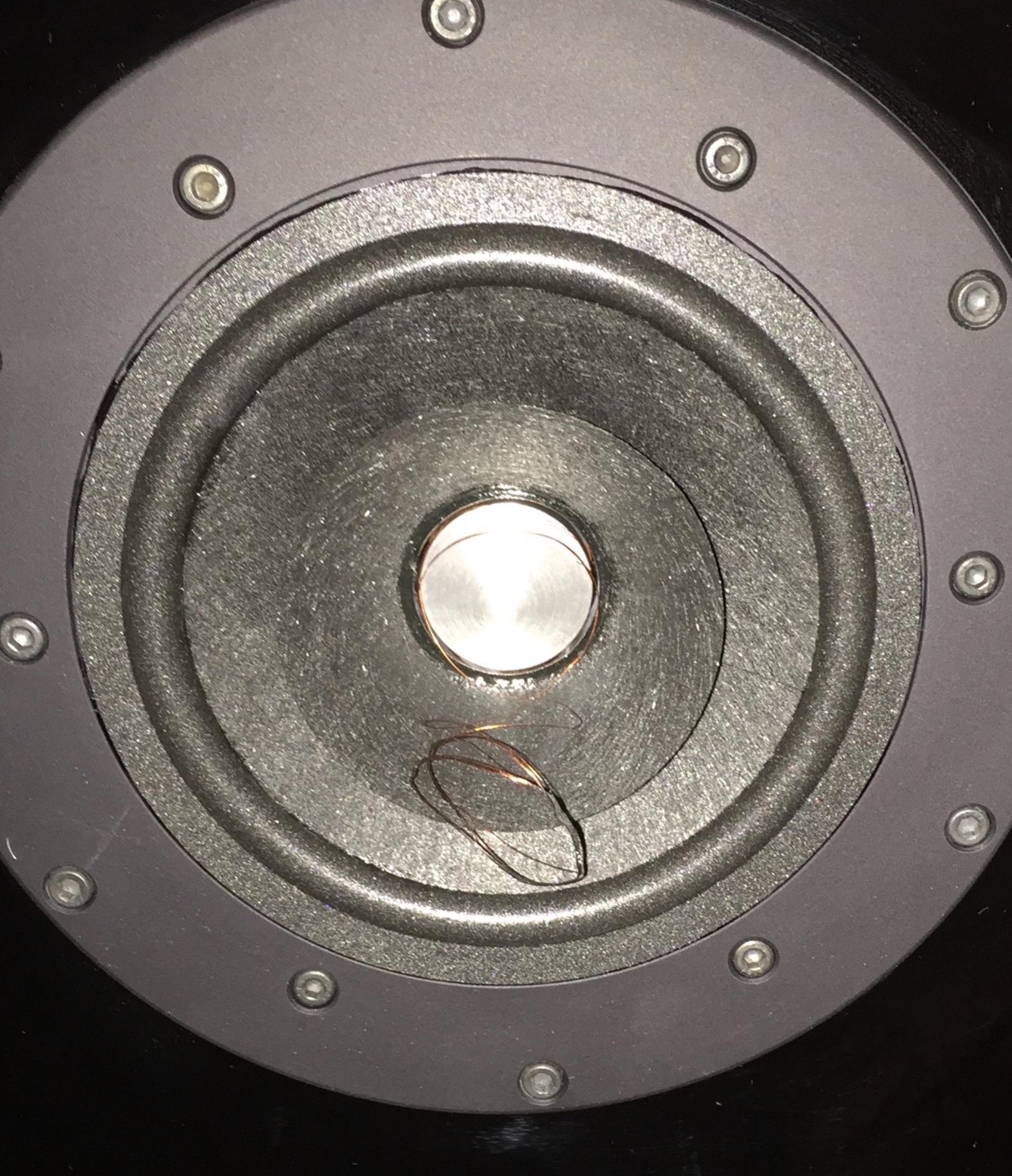

Project on hold..
Had an issue with one of my amps which sent signals to the driver voce coil to 'abandon ship'...
Thats the bad news, the good news is that the scandinavianaudiolabs have come to the rescue.
Superb product which sounds superb and as it turns out superb service.

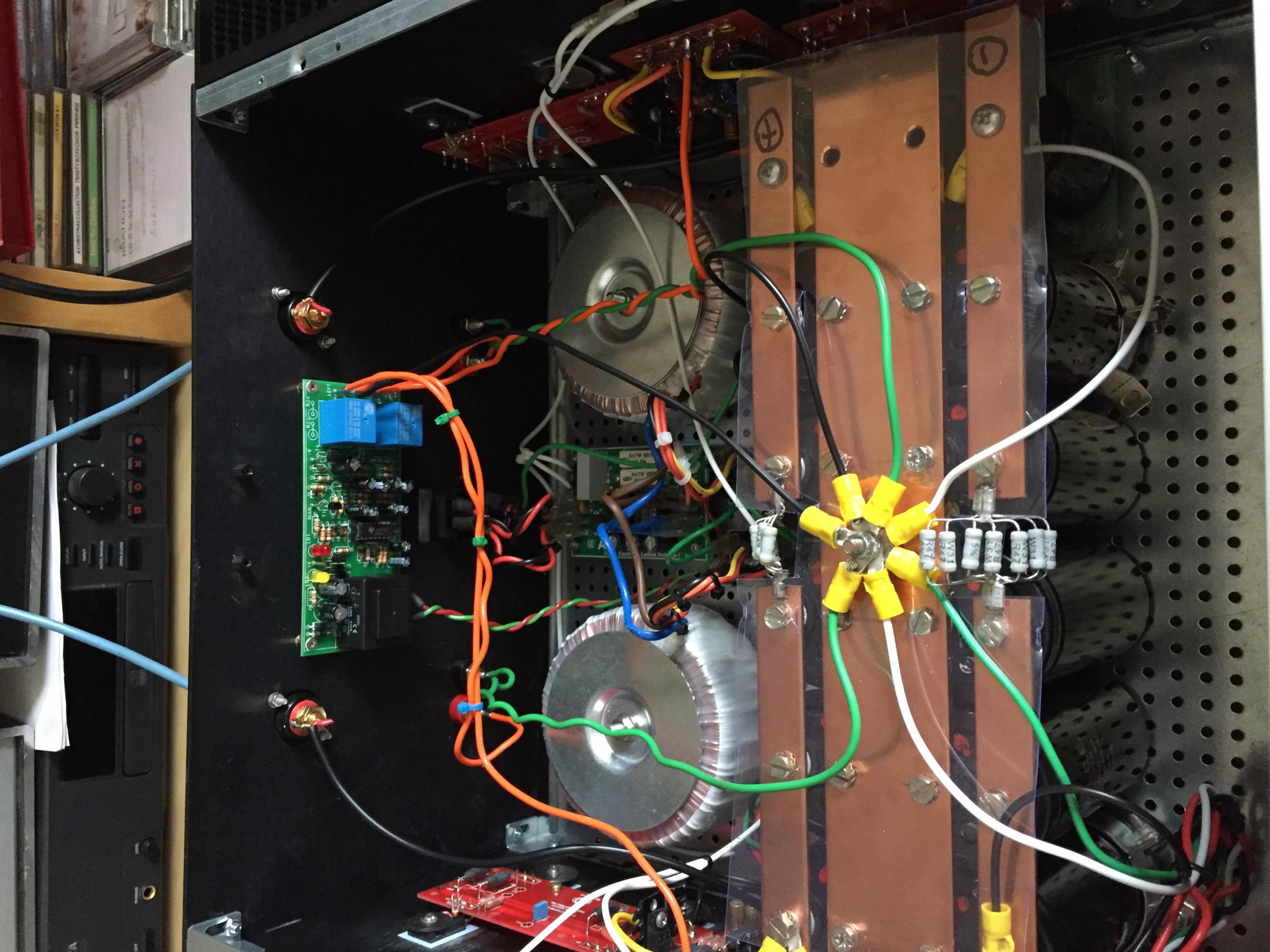

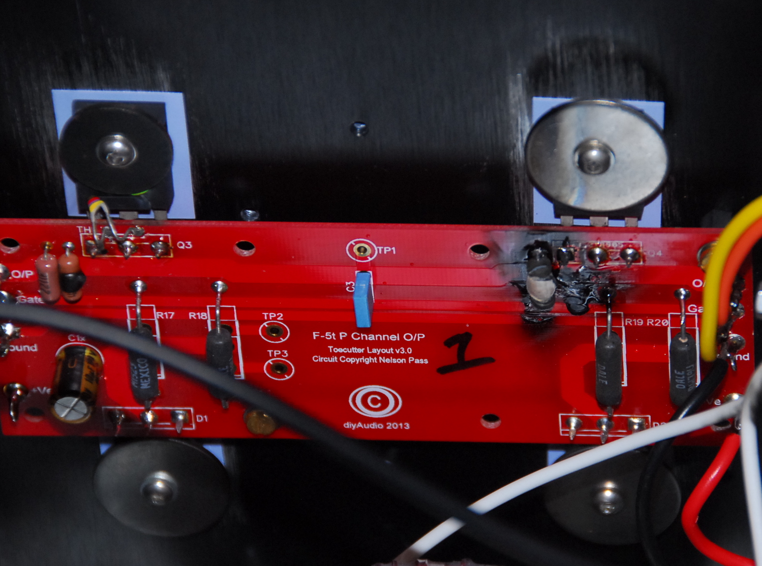

So I rebuilt the amp :p with speaker protection and other mods as advised.
But to no-avail, two days on the bench testing and setting up, checked with a scope....all good..
2 hours use ...... 'BANG" flash, game over. :confused: Same again. But the the speaker protection circuit did its job :p Bonus,,
Crap! At least now you know that the problem is likely not in the part you re-built... ;-)
