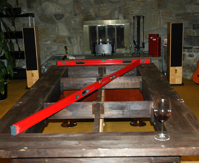

My listening room is 16X24X8 feet. Plus, a regulation Gold Crown places the listening position at 12 feet or more. Further, a stone fountain forces the the speakers to be at least 3 feet out from the wall.
The Gold Crown weighs 1200 pounds. Thus, micro-tuning speaker position for critical listening must accommodate the table. My interest in the dual horns, whether having merit or not, is partly due to the psychological effect of having horns near the ceiling to offset the dominance of the table and table light. My Aerials face considerably upward and the vertical sweet spot is best achieved while sitting on a bar stool. Perhaps Hiro, more so than Saburo, would better impose itself in this environment. Thank you for helping me to work through this process.

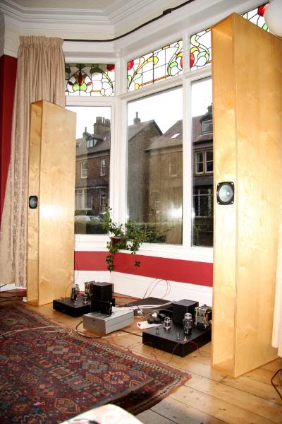

10' is the min listening dist required for the Sachiko to come into focus, i think the Hiro/6.5" driver works at 9' although Scott L. may disagree with that.
You're fine at 12' but the table will interfere with imaging irregardless of the double mouth, to what extent will be something you'll have to figure out for yourself. Given the room size and with out a clear idea of layout i've a suspicious feeling you'll be better off moving the pool table further away from the fire place and placing the Austin 166 corner horns in the corners flanking the fire place. I'm pretty sure you can use a 168E∑ in the Austin's too.

I have a couple of questions about the Sachiko.
What materials can be used?
What is the best way to put it together? Glue and screws? Glue and woodplugs?
Screws will mess up the outside finish but glue and screws wont, what's best?
Will a pair of Sachiko fit in my room (see my own thread: What should i build?)?

I agree, for critical listening, you dont want any large object between you and the speakersYou're fine at 12' but the table will interfere with imaging irregardless of the double mouth, to what extent will be something you'll have to figure out for yourself. Given the room size and with out a clear idea of layout i've a suspicious feeling you'll be better off moving the pool table further away from the fire place .

Well, the room's an acoustic nightmare with that pool table. If I'm not reading things incorrectly, sounds like you're listening behind the table, so that pretty much puts the lid on high quality sound; there'll be reflections etc. all over the shop.
I have a couple of questions about the Sachiko. What materials can be used? What is the best way to put it together? Glue and screws? Glue and woodplugs?
I too would avoid screws. Don't like them. Good quality glue and clamps. Lots of clamps. Plywood, preferably BB as a build material.
Don't know, I'm about dead on my feet, so I don't have time to go a-searching other threads. You need a reasonably sized space though (say 18ft+ long) and to be sitting about 10ft from them.
Will the 206En work as well as 206E?
The new 206En will go in, but won't work anything like as well as the old model; they've slashed its linear displacement practically in half (53% of what it used to be), so useable dynamic headroom has dropped significantly. Sachiko will be better than a lot; it's got size on its side, but IMO, the En needs to be used differently; tuned higher, gain rather than extension. I've just completed a new design for it with that in mind, but it won't be one for the FH site. If you fancied being a beta-tester for it though, contact Dave or myself.
