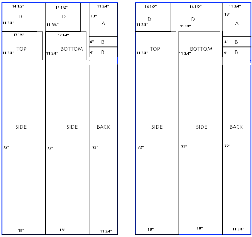

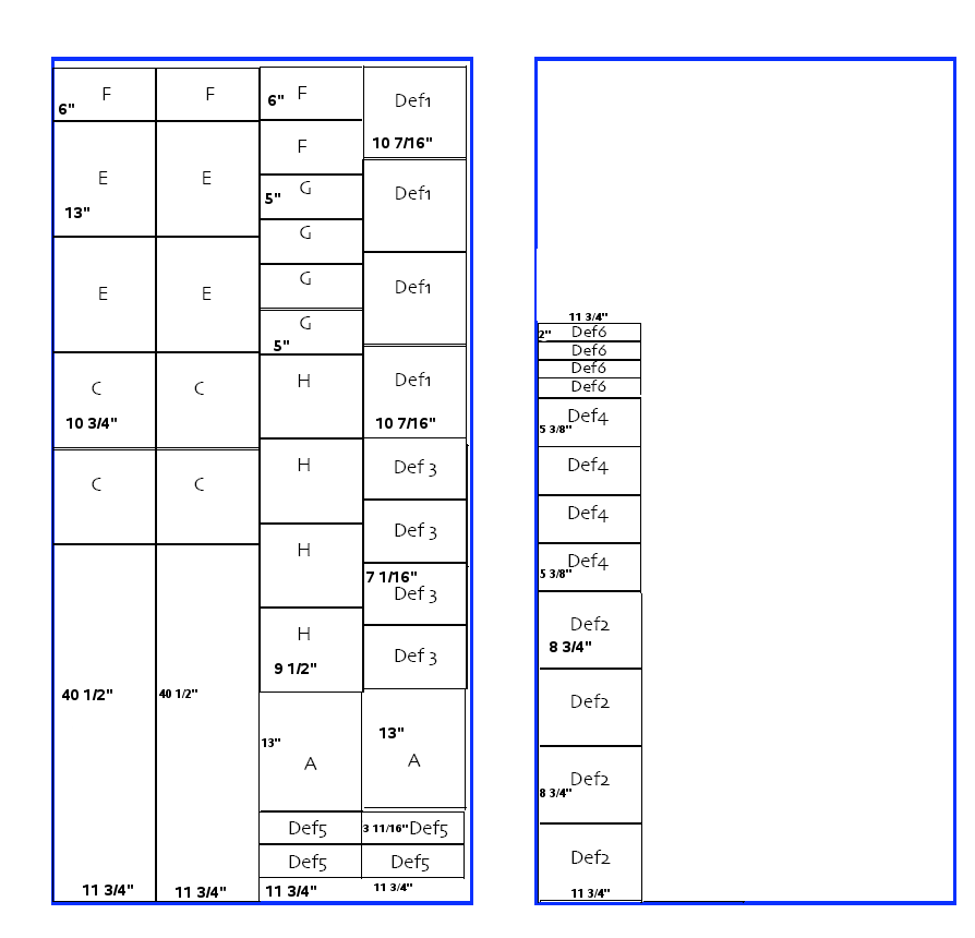

In case it is useful to someone, here's a slight variation on the standard
cutting plan -
1) Added dimension notations
2) Moved alternate deflectors to a different sheet, so they can be made
from different material (MDF etc) if so desired. Also, this sheet can be
a smaller 6x3" one.
3) Fran pointed out there may be a small gap in the back piece if
the sheet is 18mm thick. To eliminate this, I made the back piece full-length (72")
and reduced the top/bottom pieces accordingly.
