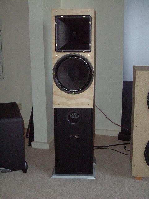

DE250 and 10"woofer
Fergs1,
This is my implementation of De250 and RCF horn with 10" woofer.
Notice it is a BR implementation, horn I have tried open baffle with equal success.
Cheers

Re: DE250 and 10"woofer
ttan98 said:
Fergs1,
Cheers
Ttan...that's interesting. I have a 10" round waveguide but have no experience in working with them. Did you have to import DE10 or are they available locally ?
Re: Re: DE250 and 10"woofer
Find a friend who lives in the States, ask him to buy on your behalf and send them to you. Cheaper this way, you can get them locally but TOO expensive.
PE is the best place to buy B&C ie DE10 parts.
