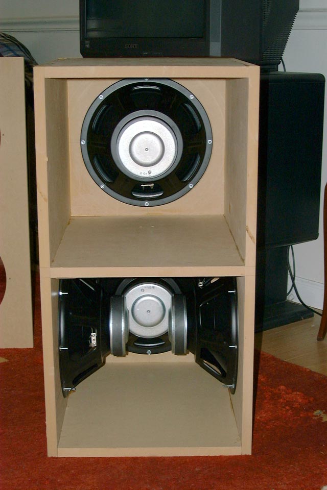

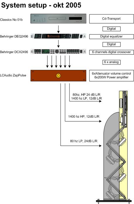

Some finishing touches tonight on the xo... added Linkwitz transform circuit. It is now -3db at 20Hz. Very satisfiying LF . Unfortunately I don't know how to measure farfield LF to confirm/show off
I'm still struggling with mid-tweeter crossover sound. It is time aligned, measured flat, etc. But I still think it's unrealistic/not very smooth. What could be wrong here? Is this an unresolvable problem due to physical difference of 5" mid and 1" tweeter ? Is this why people keep insisting to use full-range???
What I want is when I turn the tweeter up so slowly the sound becomes "one". Not dull, bright, or "audibly separate".
Lots of Orion review said that midrange-tweeter transition is very smooth. What is the factor here? The XO looks to be typical stuff. Could the Millenium tweeter be really that good?

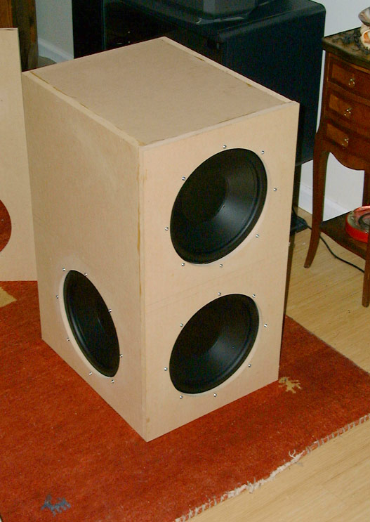

I did more investigation on the mid-tweeter transition sound. More measurement near, far etc. and there seems to be nothing wrong.... until somehow I realised that those measurements are on-axis and I am listening off-axis due to the height of the tweeters.
Sure enough I played pink noise and from the listening position moved my head up and down (the wife was amused ). The tweeter beams and from the listening position the "height" of the sweetspot is only 10cm or so, which is not much at all. Where my ears would be 20cm lower sitting and seems to be in exact position in a null lobe. Once identified it is easy to notice this in music playbacks.
I will need to cut shorter baffles to prove this finding, and unfortunately this will not allow the 3rd woofer.

As this is OB I'm trying to think of of from the all-important polar response. So WWWTM response would be something like wide dispersion - then narrows - then wide again reaching the midrange. Something like an "hourglass" perhaps ?
Where as WWWMT would be something like a sharkfin or half a surboard...
I think this is something that I really need to try physically by cutting new baffles.... hmmm router dust mmm..
Okay... it's been just over 3 months since I completed these speakers. From the start the compromise is always there, the P13 being acoustically too small for 30cm baffle, violating the < 2 * mid diameter rule.
The measurements given in previous pages shows uneven response in 1-2kHz region. This manifests in midrange quality. I've tried may approach including multi-eq/notches. It did not work.
Thus it is declared that this design is a dud! It has it's quality, namely powerfull bass, and the usual Dipole qualities, but it's not "the last speakers". Too bad, we've enjoyed so many good times together...
