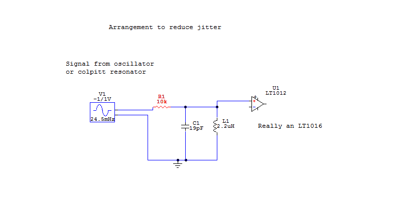

A made a reclocker some time ago. I used a DSP and others to buffer the signal.
In order to get a jitter free oscillator, I made an arrangement with a tuned LC filter.
See my attached picture.
It seems to work very well, but what do you think, guys, about this approach?

Well, I'm only showing the part of the whole thing that's of any interest for this jitter issue. The whole circuit is a bit too complex.
The thing is that LC resonator that is tuned to the main clock ( 24.576Mhz ). Does it do any good? I think so, it acts as some kind of pendulum that , in theory, should reduce jitter from the oscillator. I don't have any means to measure jitter though. But it's a nice idea ;). And it seems to work good enogh since it just nusits in my DAC.
If you are interested in that reclocking circuitry I can show the schematics, but it involves some programming.

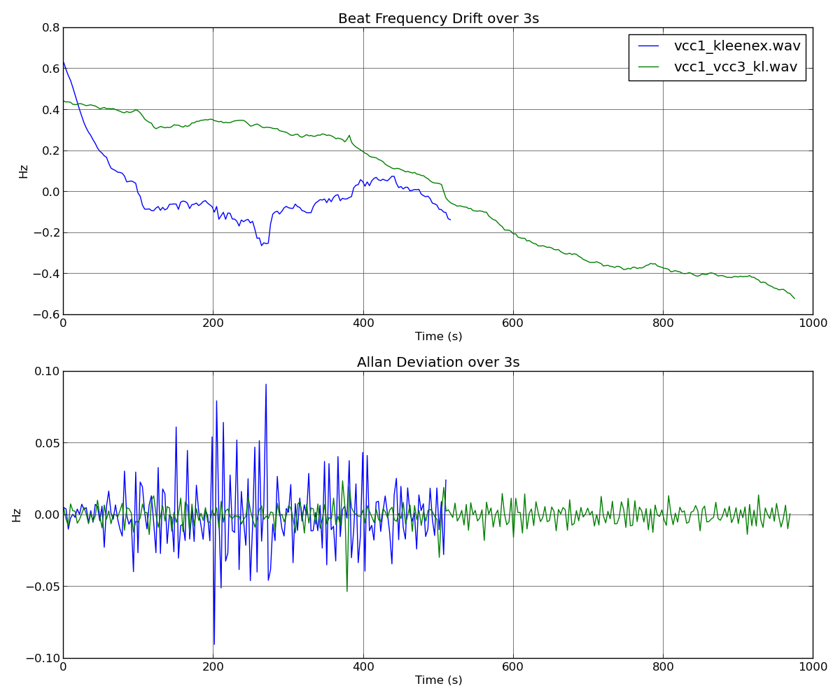

For example, I take two 50MHz clocks. They have a 50 Hz difference, which gives me a beat tone of F=50 Hz. Let's say it drifts by 1 Hz.
The soundcard's clock is also 50ppm. HOWEVER, when measuring a frequency F with your soundcard, the precision you get is 50ppm of F, not 50ppm of the soundcard's master clock, because of division.
See attached picture, where a bunch of junk parts and a cheap soundcard measure two 50 MHz clocks drifting relative to each other with better resolution than 0.1 Hz, ie, something like 0.002 ppm :D
> And if the jitter is randomly arranged, then FFT analysis will be useless, won't it?
Random jitter widens the "skirt" at the base of the peak. The peak also appears flat because the clock drifted a little during the experiment. If it is 50 000 000 Hz at the beginning and 50 000 001 at the end of the test, then the peak will have a flat top 1 Hz wide.
Is this an attempt at humour? Adding an LC filter to the output of an oscillator will do nothing for jitter unless the oscillator is so incredibly bad that you should not have used it anyway.
No. In theory (and in practice) it will make no difference.
That may explain why you think this idea reduces jitter - you have no way of checking by experiment that your 'theory' is wrong. You could instead check it by reading a textbook on oscillator noise theory.
No it is not. It merely shows that you don't understand oscillators or jitter. That probably means that your 'reclocker' does no good, and may do harm to the signal.
