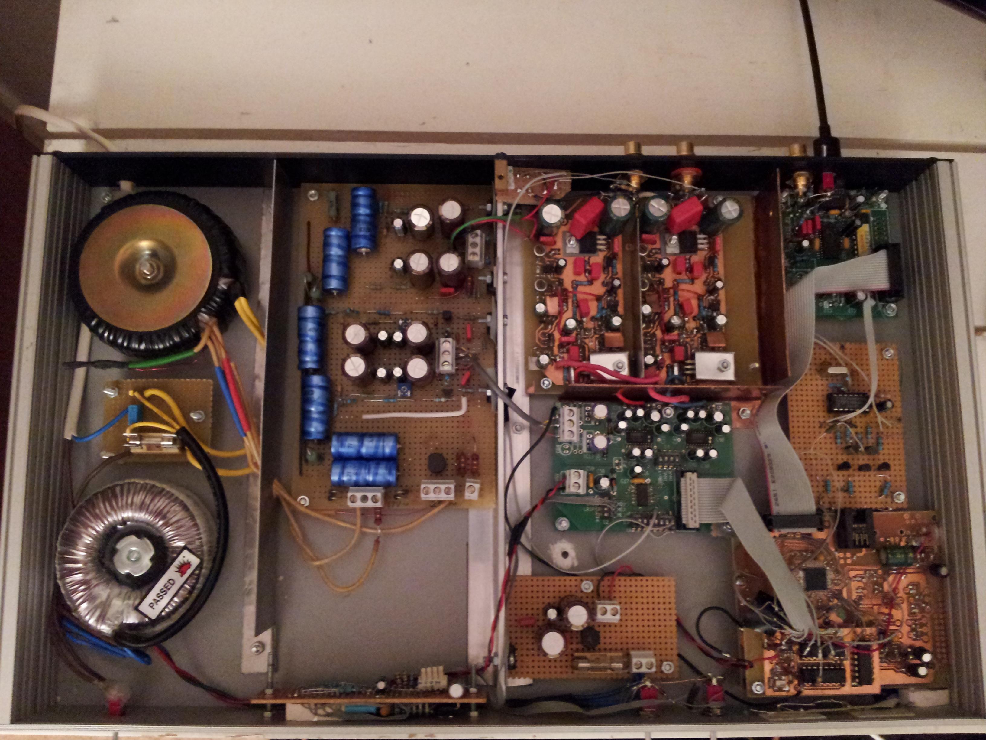

I forgot to mention that this reclocker is located in my DAC ( or DAC's ). I have hooked it in to the I2S stream.
Look at my attached image. You see that gray flat cable? That's where the data normally is transferred from the receiver( CS8414) to the DAC ( pcm1704).
I cut it in two and inserted that messy thing to the bottom right which is an old prototype of an audio delay that didn't became anything.

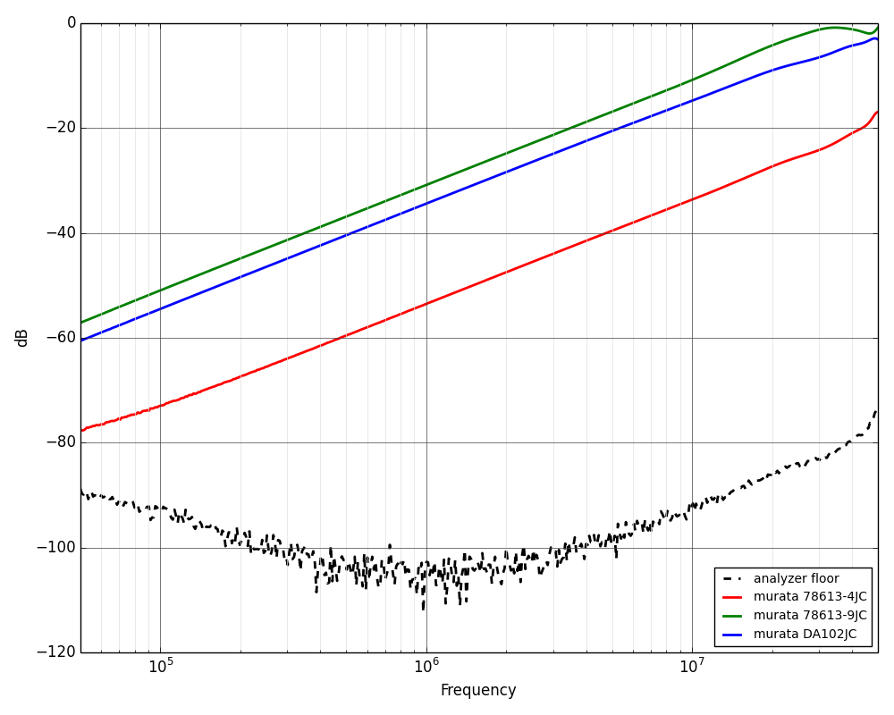

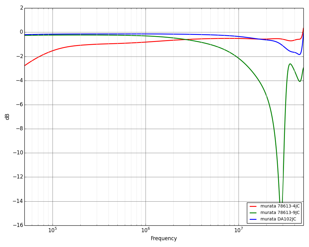

Here are 3 transformers, measured in transmission and common mode leakage using 50R network analyzer. In common mode they behave as capacitors, and isolation is inversely related to low end bandwidth extension... ie, smaller transformer = less low end and less capacitance.
Basically everything one would expect from theory
