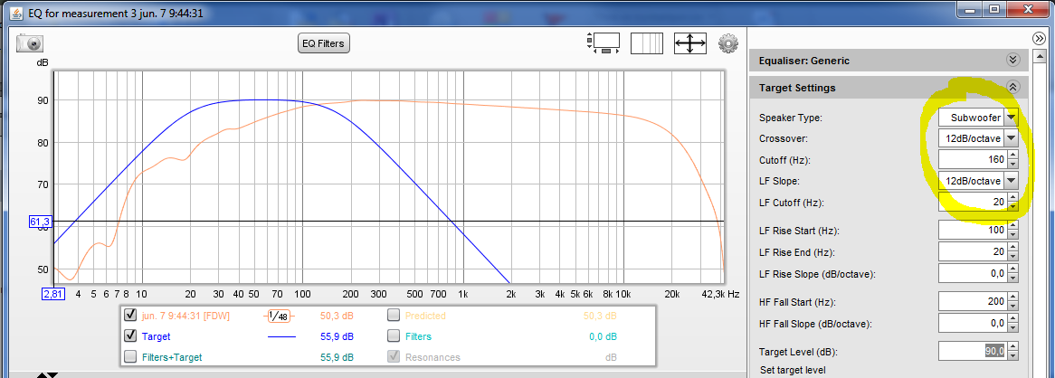

@Mkane77g
IF its auto EQ in REW you mean then try use as below settings because a low pass BW2+BW2=LR4 so if you EQ to that BW2 acoustic target all we need to do is over in miniDSP is add a electric BW2 and we there. If you have trouble get woofer to stretch its area up so high in frq then set field number two "Crossover:" to 24db/octave and i can come up with a PEQ or two that transfer BW4 to LR4, and actual this is maybe not bad because BW4 is our target later on down the road.
@Perceval, sleep well so you not harsch in the morning : )

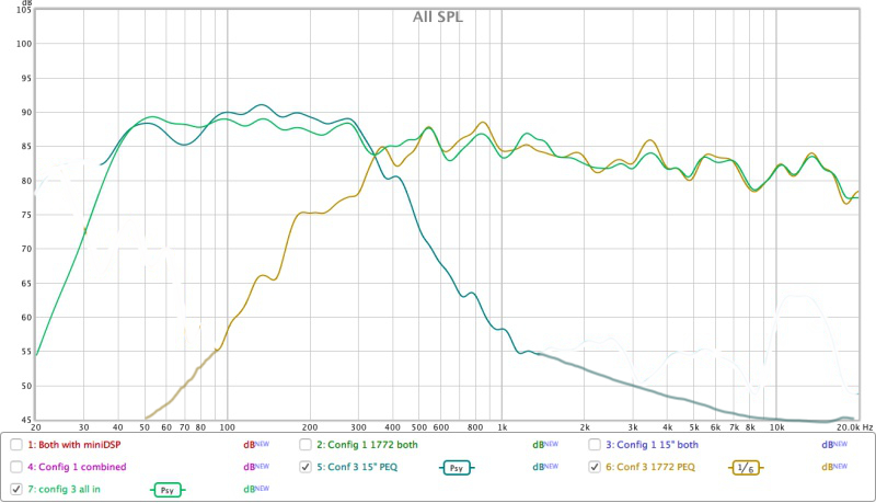

I see way too many peaks and dips in these graphs...
@wesayso
Thanks advises for measurements, from beginning its not worlds smoothest and maybe not a wish in this SLOB system, guess that is up to owners how much time offered to smooth it out in precision style of Barleywater, intend focus to get XO region acceptable for this exercise, below red trace is manufactures response times OB simulation in Edge and orange is what mkane77g had pages back.
